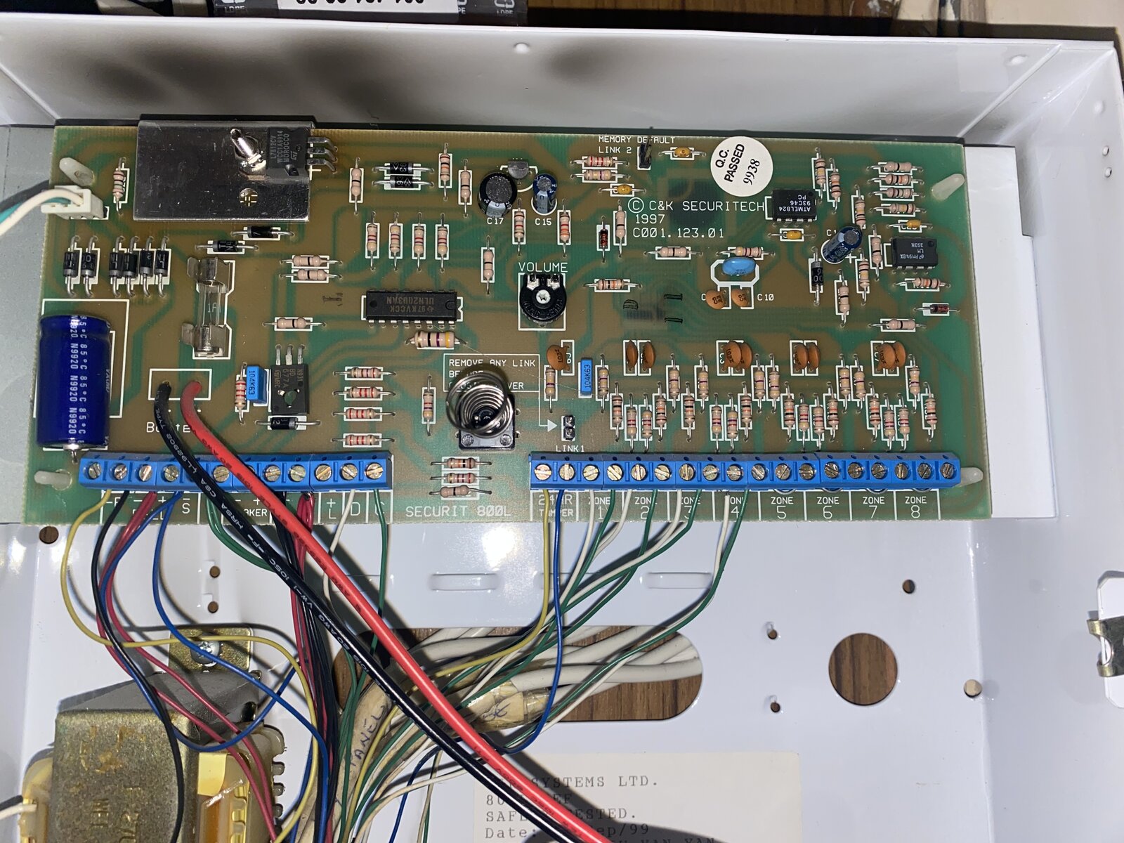

First thing ....is it a 800l ? How many zones on the pcb ? As the early ones had 5 then 6 then 7 then 8....some of the 700l plus had 7 plus pa ..... if 8 zones and the keypad has 8 ok ....default the panel ....power down totally short the nvm link,on the pcb and repower ....code should be 1234 and 7890 engineer
Later versions only defaulted these codes and not the programming , so box it up reset with 1234 # and change your code with 1234 *91 and enter new code ....all done
Many thanks for your reply Sparkymarka. For sure 800l fitted. As suggested I removed front panel on pcb, found the 2 pins for memory 1, there was a small plug inside the pcb (presume for shorting out purposes as it fitted perfectly). I disconnected mains and battery power then fitted short circuit plug and repowered. Note on pcb said ensure short circuit plug removed before fitting front panel, so I did so and then refitted panel. Used engineer code to deactivate tamper alarm - all good so far. Entered 1234# to reset, then 1234*91 and new code, still no success as far as I can tell. Have I missed something? When I enter 1234 followed by * there is a beep from the keypad, is this normal? Your assistance is greatly appreciated.

Ok , when you powered up the panel did it go into alarm ? Did 1234 stop it ?
When I cut power, the alarm sounded until I powered up again, then sounder stopped without needing to touch keypad.
Engineer code working OK.
Just tried 1234*91 again, each digit beeps but 1234 do not change to red.
Do reset procedure again
1234 should turn the alarm off while sounding if reset correct
Do not change code until you no 1234 works

You can default the control panel back to factory set by placing the correct link on the reset pin within the control panel.you will then have to reprogram all the zone set up, entry exit timers, bell timer and codes.
The tamper fault could be a faulty device bell box, pir ?
The 800l should keep all the settings on a nvm reset apart from codes ....unless it's a really old 700l panel , I would look at the bellbox tamper first !

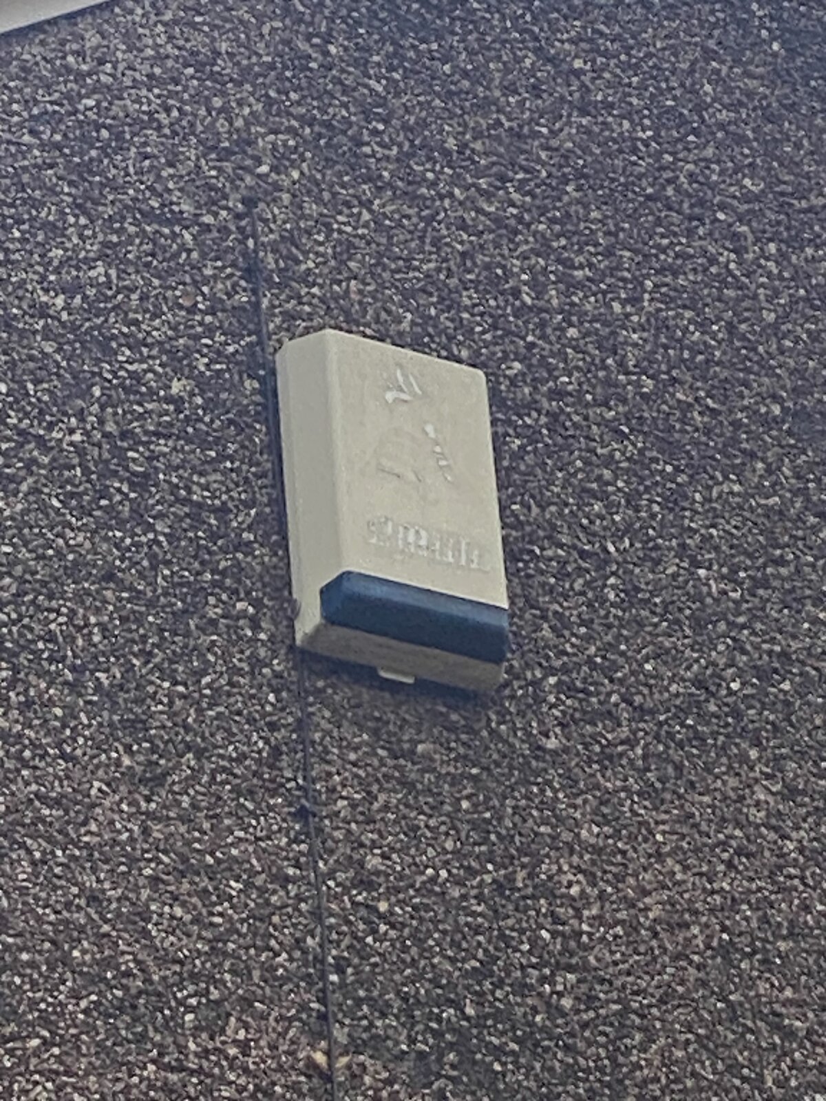

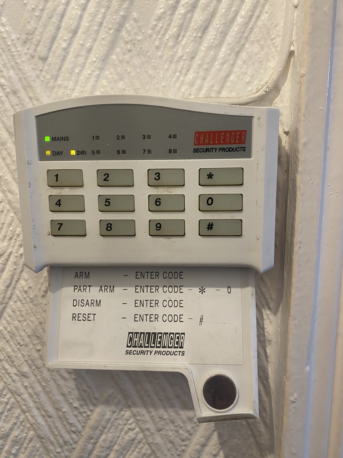

I have just been called to a Securit 800 (L?) as external sounder was going off. Only the rear one?
I suppose these also have internal batteries.
I think the rear external battery is now dead though.
I removed the the cover on the internal control box and obviously it triggered the tamper and internal keypad went into alarm (stupid that it has no tamper indication on keypad).
No external alarms went off.
So I’m presuming I now only have 1 external sounder at front plus keypad ‘sounder’.
I did test this by pulling the low voltage plug to the PCB and the front outside alarm went off.
Also when I try 1234* I do not get 4 leds to put in a new code.
It starts beeping and goes into some kind of monitoring system and I can see the zones flashing when people activate the various PIRs.
Any help to put a new code in please?

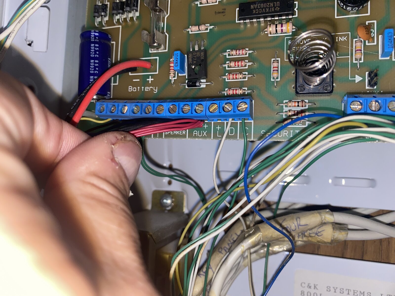

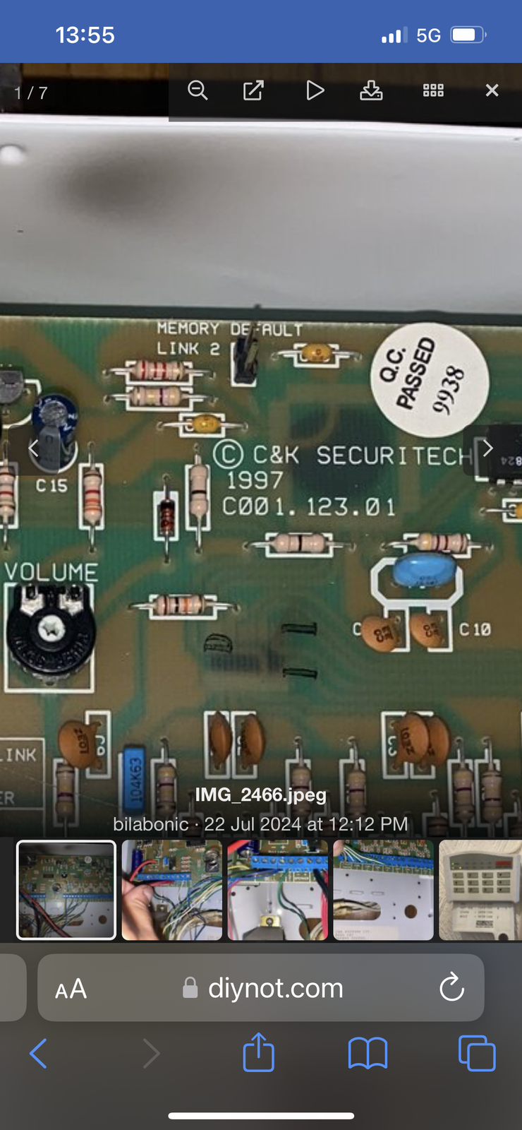

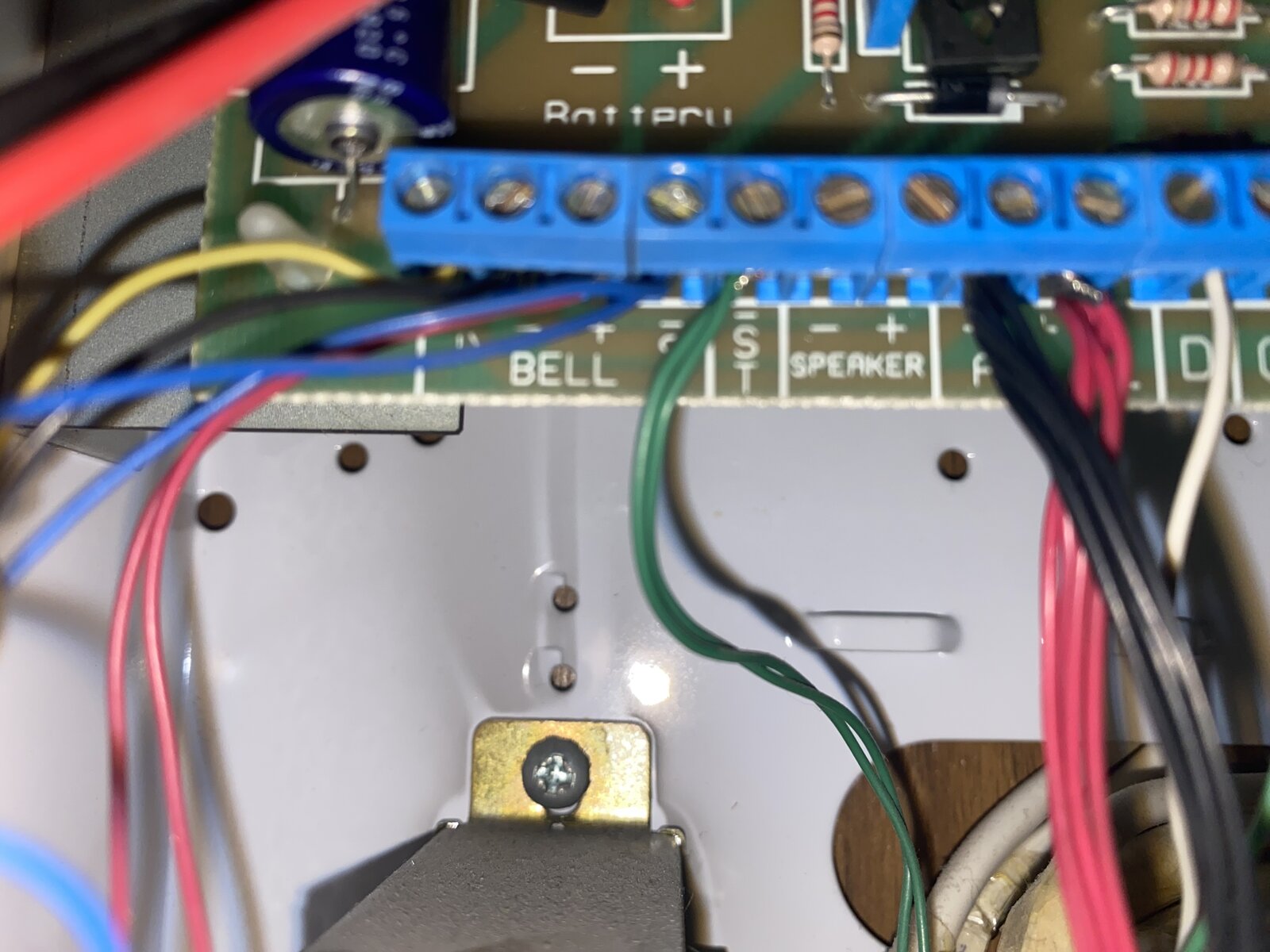

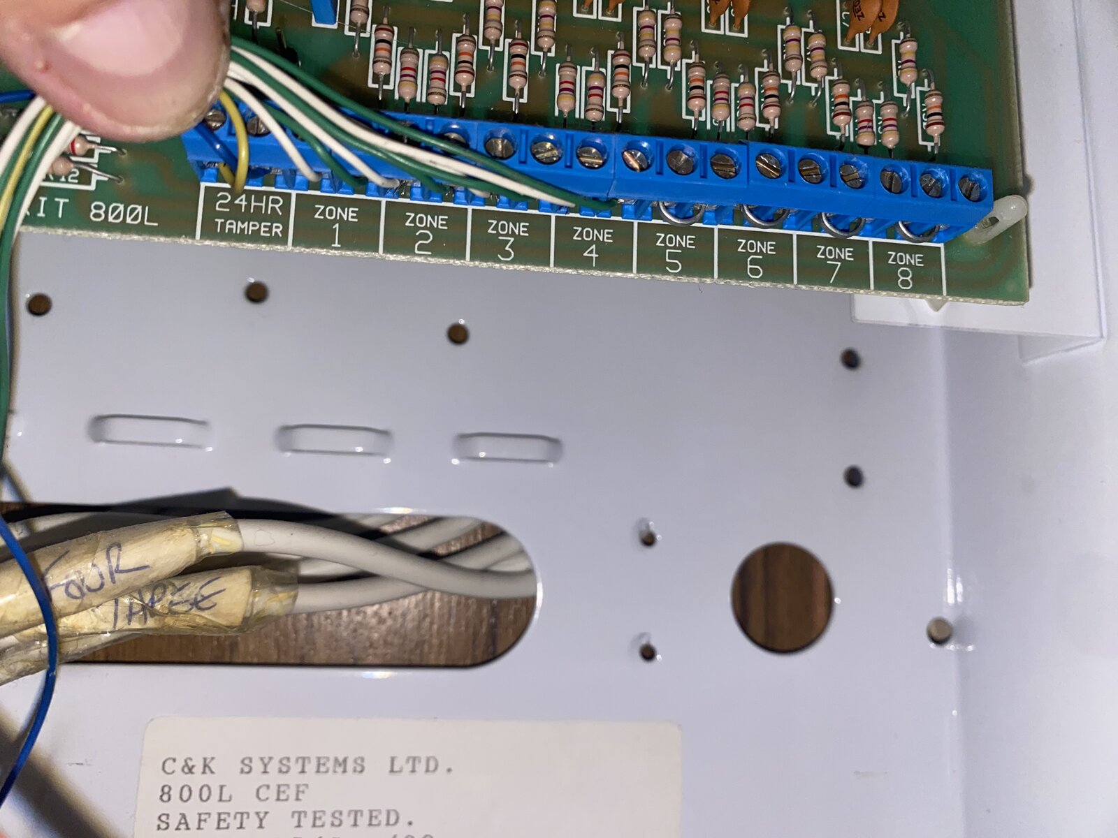

what do you think the yellow 24 let means ? ( tamper )
Obviously the code is not 1234 is it ?
And it looks like you have pressed * before 1234 which has put zones 1234 onto chime …
You need to default the panel back to 1234 if you don’t know the code
Pull off the low voltage connector top left …and battery short the two pins at top of pcb as per photo ( with screwdriver blade ) and power up it should bleep , remove screwdriver and enter 1234 to stop alarm

Alarm is stopping with 1234 as above but it seems as if it’s not the code to actually set the alarm on and off as if u were leaving the property.
Ive tried 1234* as someone above stated do that then enter new pin.
But when I do 1234* it beeps continuously and it’s like it’s in monitor mode as I can see all PIR zones illuminating as people enter them.
Looks like there are only 4 zones.
If I press # it leaves that ‘mode’.
I am thinking the 1234 is the master/admin code.
It does not set/unset the alarm itself.
Cheers
