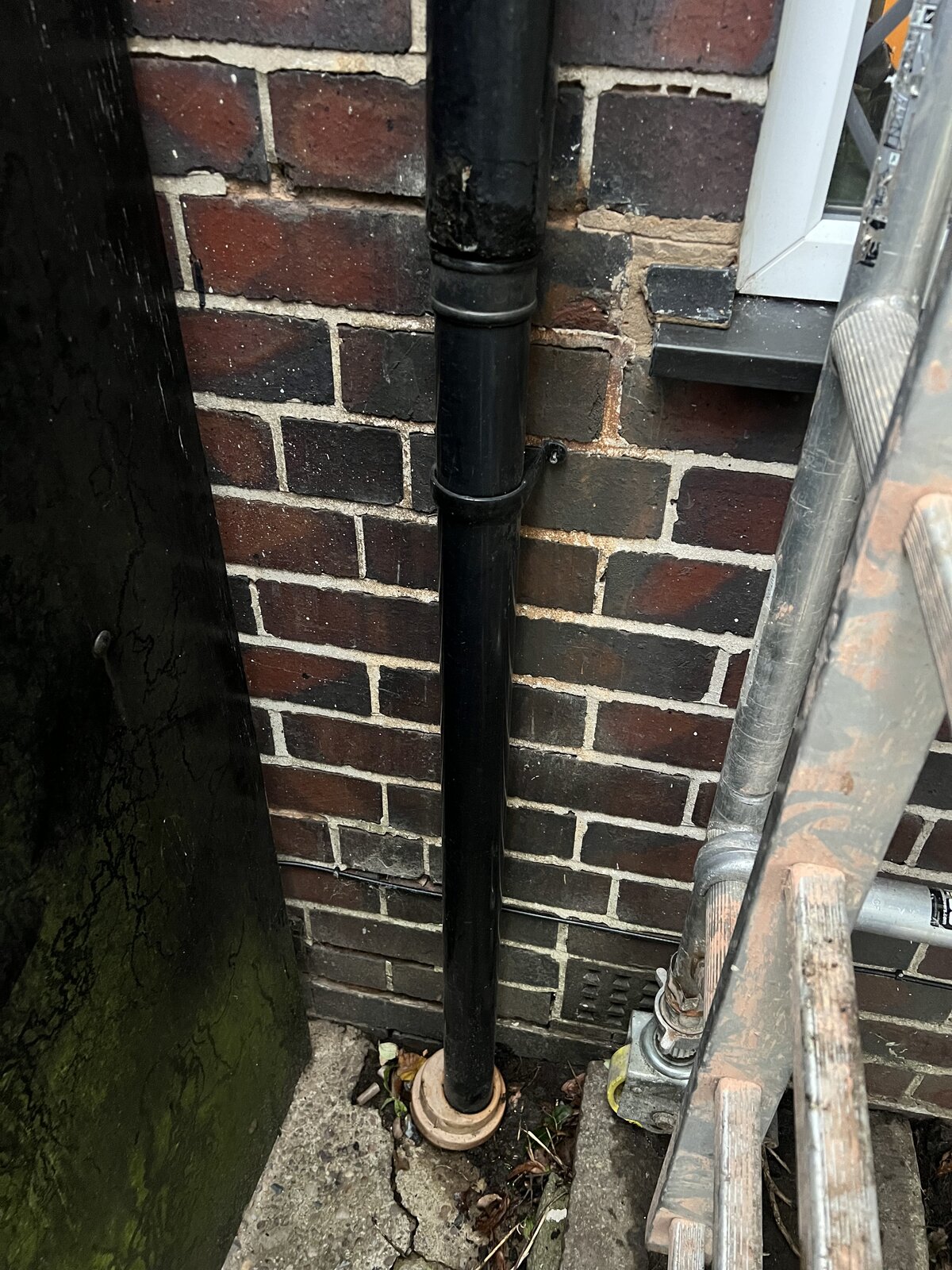

Right, I have been back up this morning quickly, went to see if the swan neck could be easily adjusted and the entire down pipe nearly came off the wall.
So full replacement it is!
I’ll have to wait till tomorrow as that’s the first time I can get another pair of hands to help me lift the current down pipe off (I’d like to just give it a cowboy push but there’s nowhere for it to land that won’t give me another job to do).
So today will be ordering parts. For completeness, thought I’d add a pick of the previous repair at the bottom too as that looks like another thing that I’ll have to work around.

Thanks - sounds good - how would I free the swan neck from the socket?
It'll be a putty joint . A little bit of digging and it'll free off. If the swan neck is indeed cracked just order a replacement .. cast maintained will out last anything else you can buy .

cast downpipes are chuffing heavy -especially up a ladder
be careful!
But the cost will be stupid. From what I can see, if properly installed, plastic can last a life time and easier to work with, just the sort of thing for a DIYer with alum tower.
