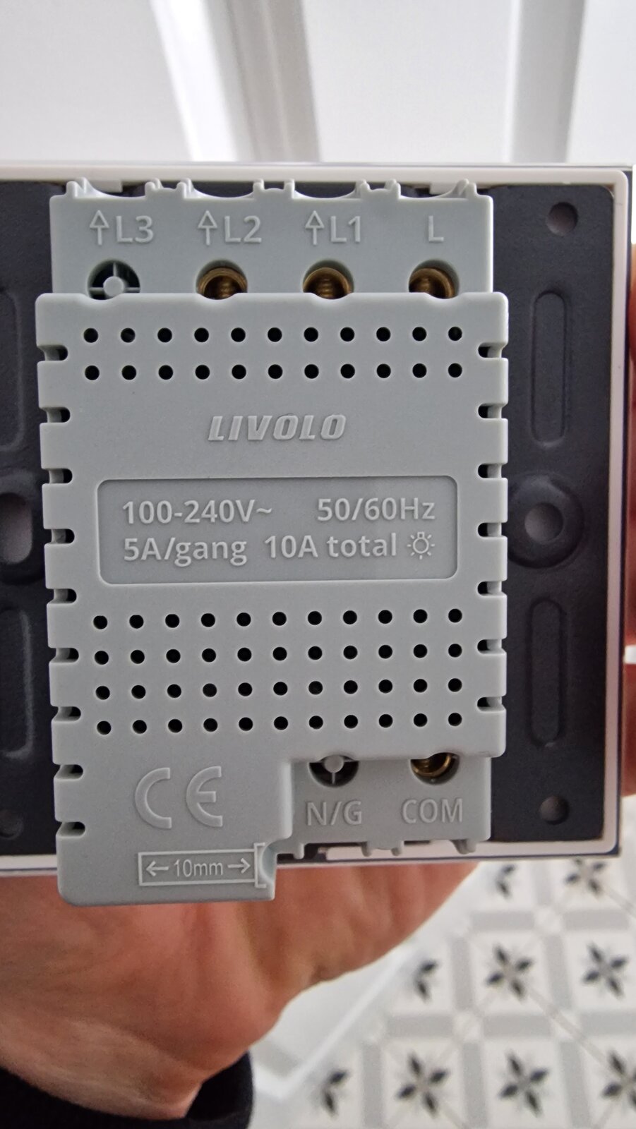

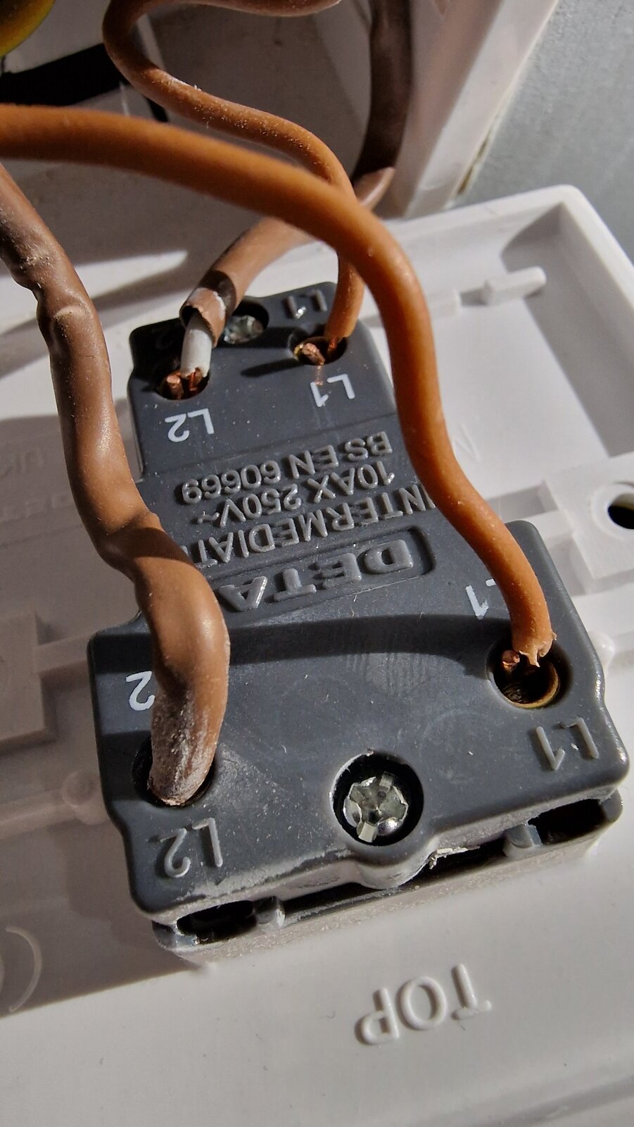

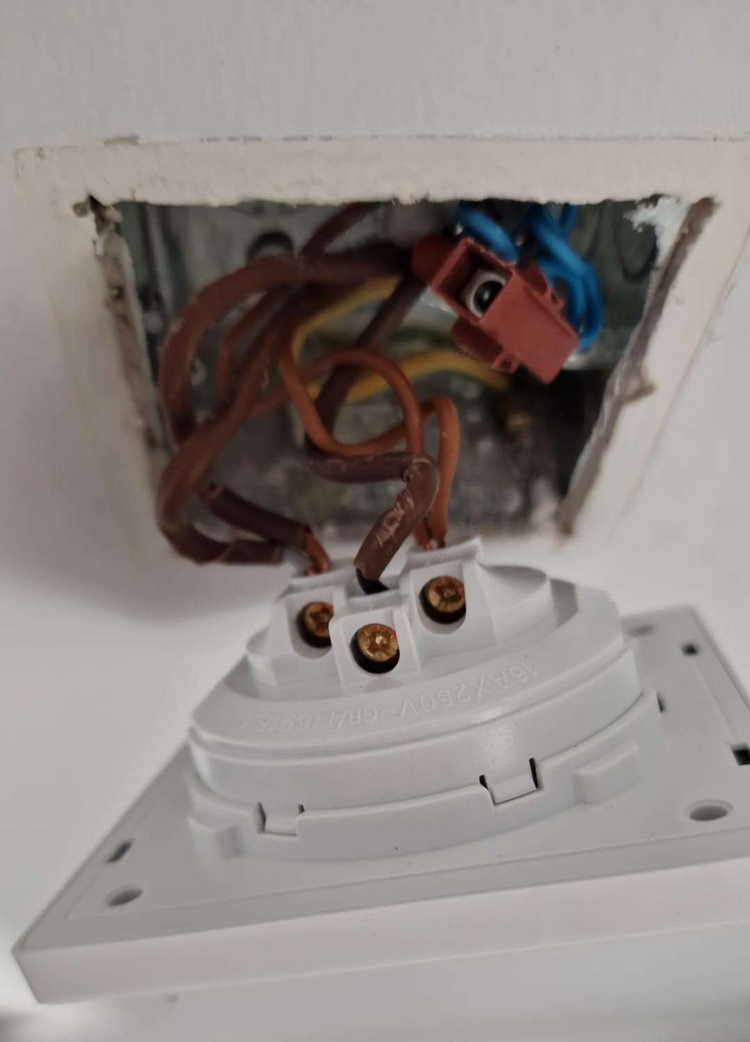

Hello! Any chance someone can tell me if I can switch from the old intermediate switch to a new one, please? The photographs are attached.
We have 2 light switches + 1 intermediate (upstairs).
The old intermediate switch has got L1 & L2 for one switch and L1 & L2 for another.
The new intermediate switch has got Com, L, L1, L2.
Massive thank you in advance.
Of course you can - if you buy a new intermediate switch.
The new one is not an intermediate.
It is a touch switch which, I think, could be configured, with another two switches, for a three-way system.
So three light switches.
No - it is all one switch.
It is not an intermediate.
It works like this - and I think you could add a third - but they will all need rewiring.

Well, intermediate switches can also be used as one-way or two-way so you could buy all intermediate switches which would then match.
Was thinking of buying this set where they have a 1 gang 3 way intermediate switch available, however I am not sure the 3 way will work in our house since I believe we dont have a neutral wire as can be seen on the original intermediate switch.
They do not have a neutral wire. The neutral shown is after the lamp.

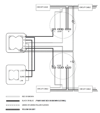

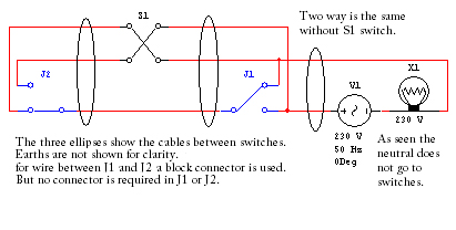

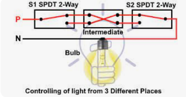

I think you are getting confused with the switches.
Here is a three switch system diagram with two two-way and one intermediate. It is very simple.

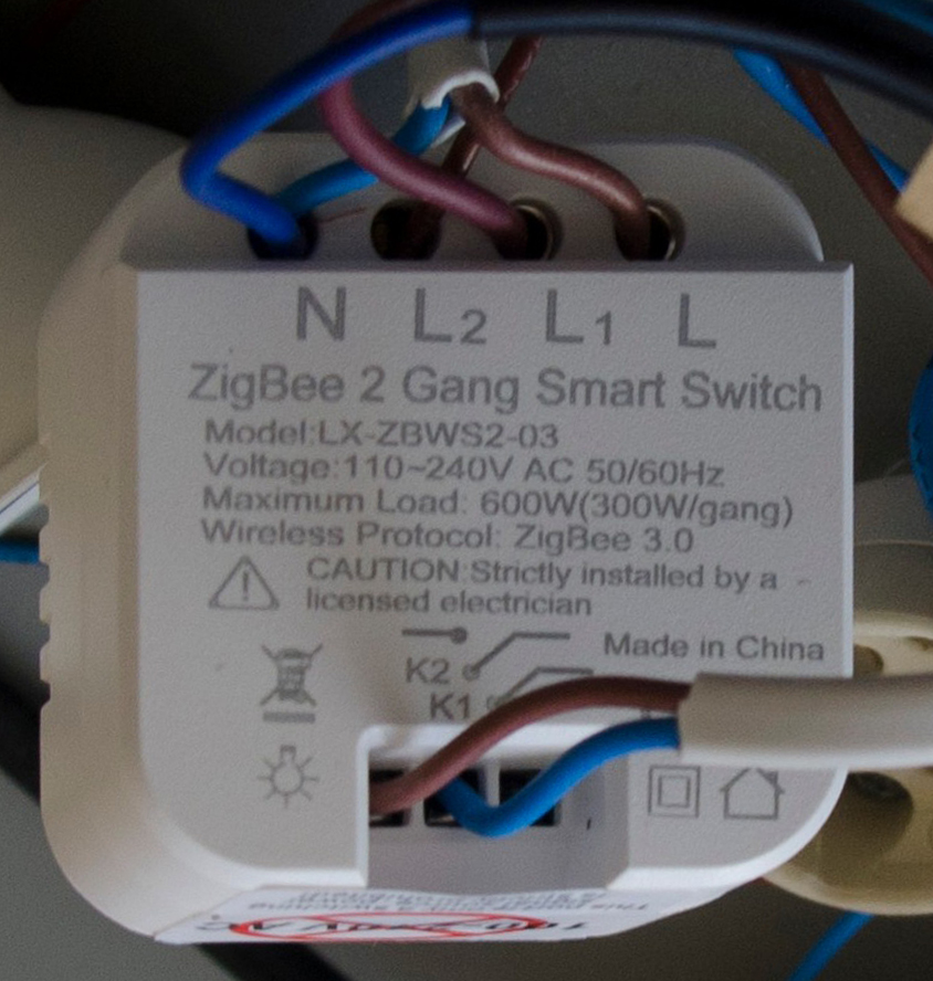

As in EFL's diagram, there is an L in and 2 L's out (rather than the 3 in the diagram), the com is the communications link to the other light switches (only guessing, but receiving an impulse from the other switch to toggle the output? Edit - synchronisation suggests more than just an impulse!)
(a) what on earth is an "Intermediate Switch 2 gang, 2 way"?
Looking through the product range, the 'intermediate' refers to having the Com terminal that allows the communication.
I can't find any reference to 'intermediate' switches on the manufactures official (European) website - they are referred to as "2 gangs - 2 ways"
OK, but in view of existing established terminology, to call that a "2-way" switch is confusing, at least to me!
Maybe - but, again, in view of existing established terminology/labelling, to use "COM" to identify a terminal on a "2-way switch" as one with a 'communications' function is surely more than a little confusing, isn't it?
Yes, definitely confusing.
With these (somewhat misleading) descriptions, why wouldn't you think the switch was a direct swap?

1 way, two contacts, either on or off.
2 way, three contacts either on or the other contact is connected to common.
3 way, the common connects to one of three contacts, not seen many as flick switches, normally rotary connected to three lights illuminating three signs, busy, wait, enter etc.
The reversing switch, intermediate switch, can have a centre off, but since it does not connect to anything, it is still not three way.
What I am saying 2 way refers to the type of switch, not what it is doing, and it could simply light wait and enter lamps, it does not need to be used for multi-switch controlled lights.

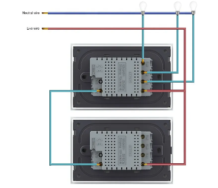

There is the traditional wiring
been done this way for years, but with electronic control, they tend to use the master/slave method, the one linked to never seen the slaves sold independent to master, but can buy master independent to slave, which I admit seems daft.
Looking at diagram 1676549508362.pngthe S terminal connects to slave, and all switches must be the same manufacturer and designed to link together, rather silly to my mind, I had 5 light switches of the make shown, and now down to 2, and at around £47 the pair, plus if you want to use internet a hub, rather expensive.

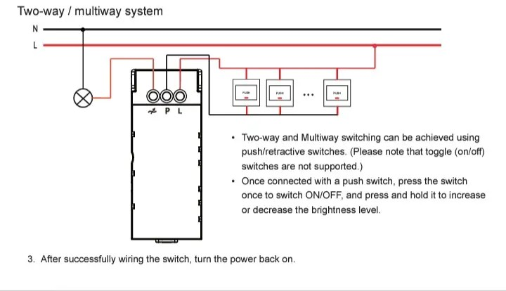

If I was re-wiring I would still wire ready for two way switching, mothers house all switch drops used three core and earth, the third core unused, but ready for either supplying a neutral or two way switching in the future.
But to integrate multi-switches, looking at push buttons, as switch position tells you nothing. Not found a relay to work with pulse yet, but I am sure they now exist. Instructions vary and this to me is the problem, there are so many variants, one puts on a blind fold and sticks in a pin. But now you can buy them over the counter at places like CEF, and at £32.42 not silly prices.

Quite so - that is the standard, and very long-established, terminology for switches (what I might call SPST and SPDT respectively). Also, by long-stablished convention, "COM" refers to the 'common' contact/terminal of a 2-way switch, not "communications"!
Again, quite so. What the OP appears to have, on one plate, is two switches (hence "2-gang") with 1-way ("SPST") switch functionality, each of which can be toggled on/off either locally or from a remote switch (via a signal connected to the "COM" terminal). Since the unit needs to know which of the two switches is being addressed remotely, I assume that the 'signal' has to be something more complicated (i.e. 'coded') than just a present/absent voltage.
That's probably the functionality that a user wants, but the way in which it is being described seems to be totally confusing to anyone used to seeing standard 'switch terminology'!
