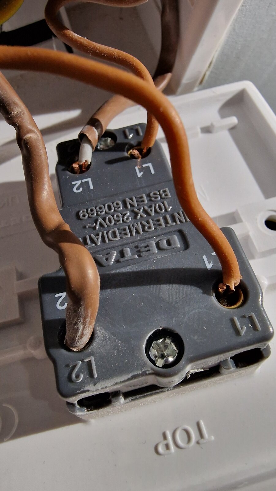

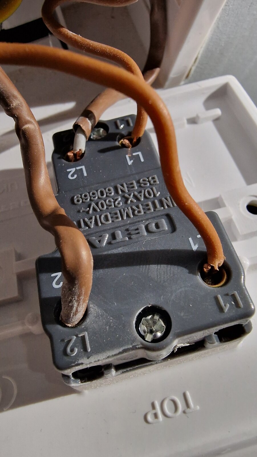

Surely if the original DETA was OK all the OP needs to do is buy a new DETA intermediate from somewhere like CEF. There are other suppliers and other brands.
There's very probably nothing wrong with the existing DETA switch, which is obviously just a standard 'mechanical' intermediate switch.
However, the OP appears to want to change it to a touch switch - and I imagine a touch switch which allows the light to be controlled by three different switches (hence, presumably, the need for three compatible touch switches).

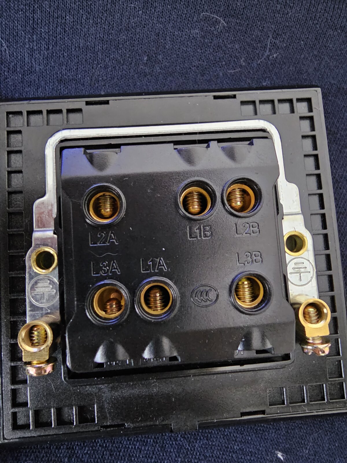

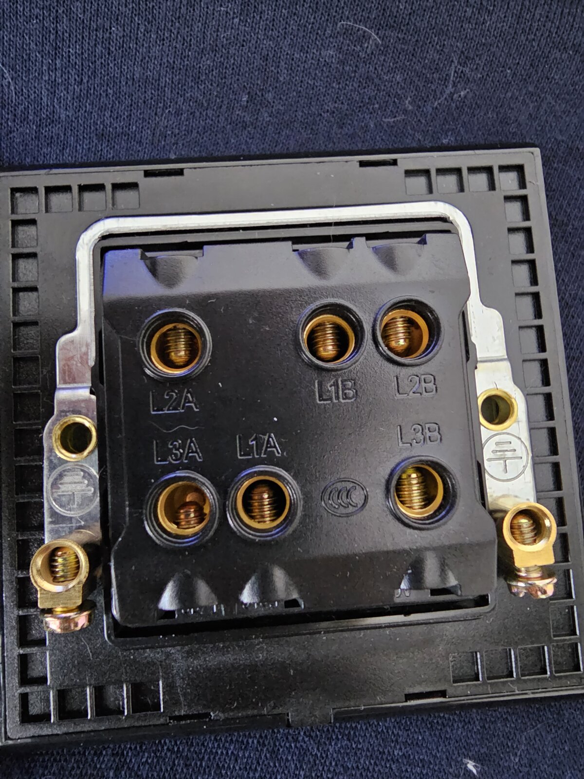

Thank you for your previous replies.
Ive ordered a new intermediate switch as suggested and wonder if this one can be used to replace the old one? Or am I need to find another one? :)

That is true if there are two switch rockers on the front. If it has only one rocker that operates both switches then it can be wired to act as a intermediate switch ( requires two links to be added )
That is theoretically true, but if it were as you suggest, then it would be the electrical accessory with DPDT functionality which I could often have made use of but have spent decades looking for without success :)
Kind Regards, John
@Headtotoes You could prevent a lot of bickering by showing a picture of the front of the new switch. :)
He could, but although I'm not really a betting man, I think I'd put a fair bit of money on what the front looks like - if not, all my years/decades of looking for a DPDT 'standard electrical accessory' (not including massive DP 'Changeover Switches') will have eventually come to a satisfactory conclusion ;)
Kind Regards, John
