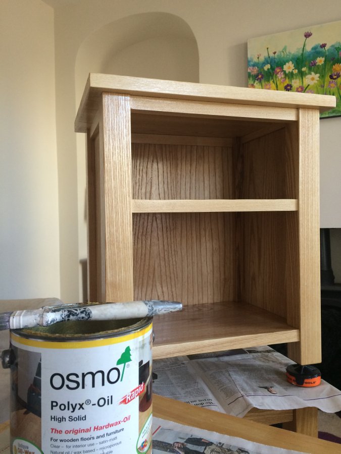

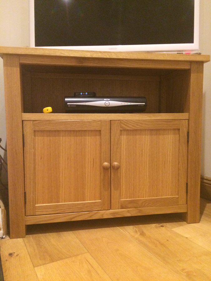

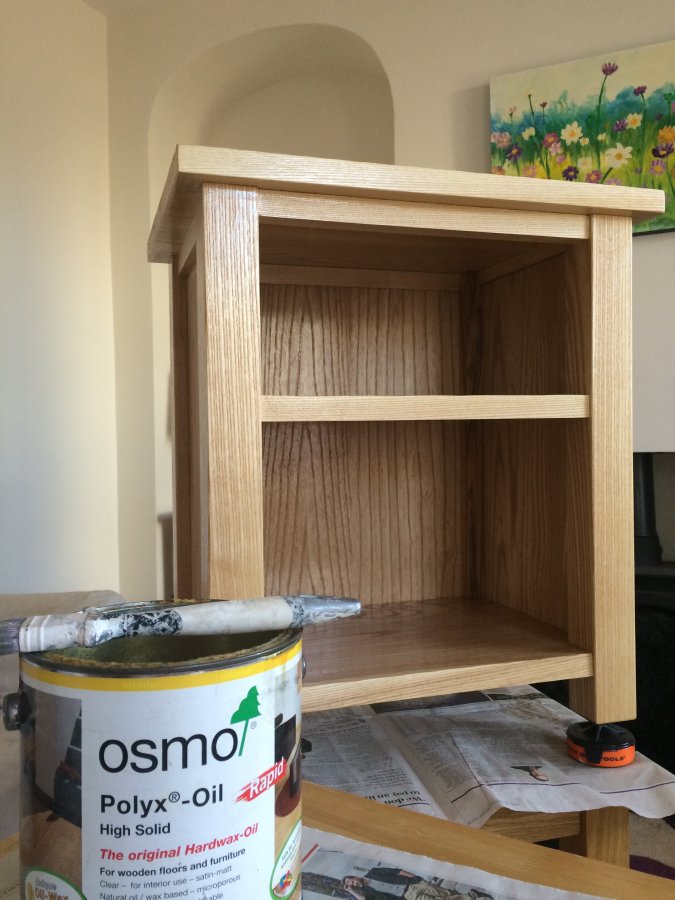

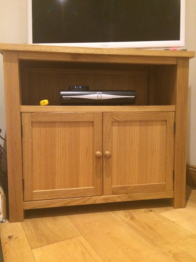

I use Osmo hard wax polyx oil for everything! Pitch pine doors, oak skirting, ash tv cabinet and oak furniture. It's so easy to use and does not have the awful varnish look! My neighbour put 12 coats of varnish on her doors, I swear she had to make the door openings bigger!!!
