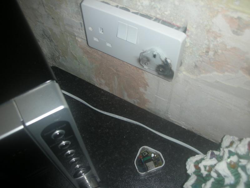

I plugged my Ipad in to charge last night and came down stairs to find this:
The Fuse board didnt cut out which led me to believe the fault is with the Plug. When i looked closer which is the next pic you might be able to make out that in the bottom left of the picture (the burnt area) next to the resistors which are still there, there are 2 holes and a picture of a resisitor but its actually missing (very faint black rectangle):
Ive tested the socket and everyother socket in my kitchen and everything is fine but these plugs have potential to cause some serious damage.

Many plug in units have a simple spring soldered onto a contact so overheating will melt solder and so it will lose contact.
However what you show is really bad not because it failed that's a fact of life but in that it did not fail safe. The part of the plug left in the socket would be lethal if a child touched the exposed live parts and so this really needs the HSE involvement so these items can all be withdrawn from service.
It's not the fact that it failed but that when it failed it exposed live parts.

Is that a genuine Apple charger, or a FleaBay special?
I've just found out they are flea bay specials but they were advertised as official. The seller will be getting a world of hurt opened up on him. I need to add though I do have 2 official Apple ones and they have worked fine for years. Sorry Apple.

FYI unless you have an iPad mini, the iPad charger is a two-parter as its 12w rather than the typical 5w
MD836_GEO_GB
No excuse for what happened but the IPad charger is a substantially larger device rated at 10W.
This one looks like the standard 5v 1A USB charger so maybe not suitable for the iPad and not having proper overload protection.....

The official chargers from the apple store are only £15, free delivery if you order today. You have to ask why are the ebay ones cheaper, OK some may be official apple ones but there's a lot of cheaper fakes out there.
With ebay you pay your money and take a chance!
My Ipad (3rd gen) came with a 10w charger which is double the size of a normal iphone charger. I believe the 4th gen come with a 12w charger however the 12w one is fine for charging instead of a 10w one.
