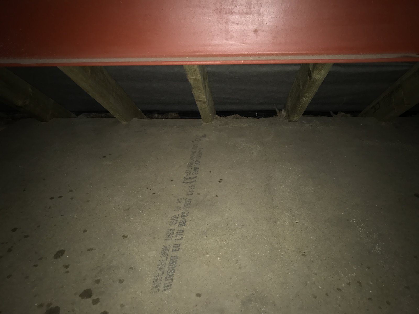

I wonder if I would be better off cutting my floor back a bit? I boarded right to the edge but have 200mm between 8x2 joists.

You're fine Ian; there's enough of a gap to allow the airflow up, so nothing to worry about.
You'll be fine, if an SE was calculating floor loads due to ceiling height the live loading would be small there.
Also there are plenty of joists to support by the looks. Maybe a 500mm cantilever would be risky, but not 200 there.
You should be more worried about losing things out the back of the cupboards, but presubmitly you'll be plaster boarding or something.
