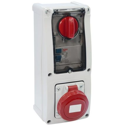

Not that I know anything, but a few of our recently installed machines are plugged into units like this...
Yeah, combination units, both single socket variants and multi-socket variants.
At least the single outlet versions seem to ship configured with only RCD protection though, not overcurrent protection.
They are available in all sorts of combinations, including empty.
