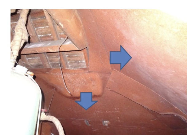

Hi all, We want a Velux loft to a 1930s semi in north London. Our roof was closed-boarded in the original 1930s without any membrane. A not so great photo below.
There has been a debate on whether the roof must be "membraned" to meet building regulations for loft conversion. One builder told us we need to lift all the tiles to put in a membrane, while others say you can probably get away with not doing it.
I wonder if anyone has any idea if the membrane is a "must" or just "good practice"? Is there any way around this? Basically, for where the house is, lifting the roof up will add a significant cost to the project.

No requirement to add a sarking felt membrane but you will need to add insulation below the rafters and create cross ventilation above the insulation.
Obviously if the roof tiles are getting towards the end of their life it would make sense to strip the roof and add a vapour permeable sarking felt to remove the need for cross ventilation.
Whilst there's no requirement IME Mr Building Control will want to have a look see beforehand to be satisfied the roof isn't gonna leak like a sieve.
BTW what's that brown stuff?
Thank you both for the reply! I think the brown staff are just some sort of sheets that have been stuck on at some point. They are only on a small part of the roof, though.
