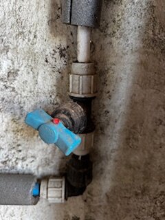

So I haven't bought a pressure gauge yet but the flow rate is 15 litres per minute, which isn't good news. I've also looked at the mains pipe, and before it even comes into the house it runs under a porch with quarry tiles on the floor.
It seems like I've got the worst of everything - converted loft, combi boiler, low flow rate, and kitchen taps at the other end of the house. Would it make more sense to start over and replace the combi with a system boiler, cylinder (and perhaps a pump), or will I have the same problem because of the mains pipe? Sounds like this is going to costly!
What diameter and colour or material is it?
That's about the same ID as 15mm copper. House built around 1980?
On the small side, but plastic seems to give better flow, possibly because it bends easier and needs fewer elbows.
Where did you test the flow?
Check the size in case it is 25mm.
I did it at the kitchen sink which is at the other end of the house. But then I repeated it at the porch tap near where it comes in and it was the same
It’s black plastic before the stopcock then blue plastic going into the porch. The circumference is 7cm so I make that a diameter of 22mm
Photo of the stopcock. The house is on a hill, the mains comes in from above and down through a retaining wall into the back porch.
