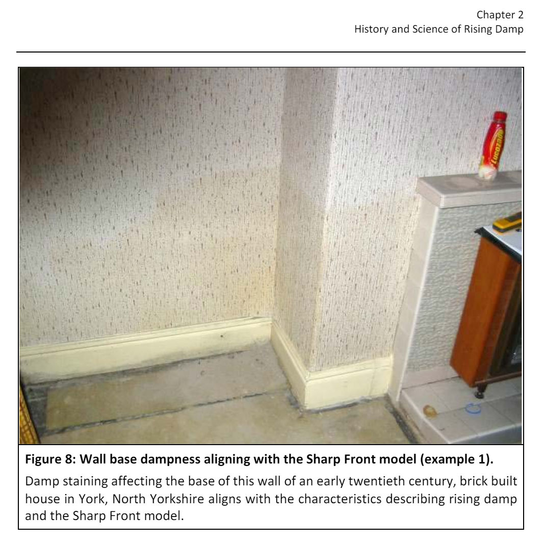

It's worth reading the report carried out by Salford Uni a few years ago. It's goes into detail about how moisture gets through the mortar joints after a number of years. They had the finance to carry out a number of surveys on older, damp properties. Rising damp has always been difficult to reproduce in the lab.

The mortar course on new brickwork forms quite an effective barrier against rising damp. That's why Jeff Howell found it wouldn't rise. He only managed to get it to rise a couple of courses by using a special, more clay based mortar.
The sorptivity of the materials means that the moisture will normally evaporate before it rises too far. What the studies have found is that the ground salts over a period of time change the properties of the masonry, especially the mortar, which means that the wall doesn't desorb moisture as well as when first built.
This means it can rise further up the wall.
I've read it and it sets out to prove what the writer wanted to prove....except look at this from that report- "rising damp" in an early 20th century house.....around a fire place, that inevitably would have had coal fires burning for several decades. IMHO, (and as found in my own house) damp around the breast is salt contamination caused by reactions of combustion gases, condensation and building materials.
