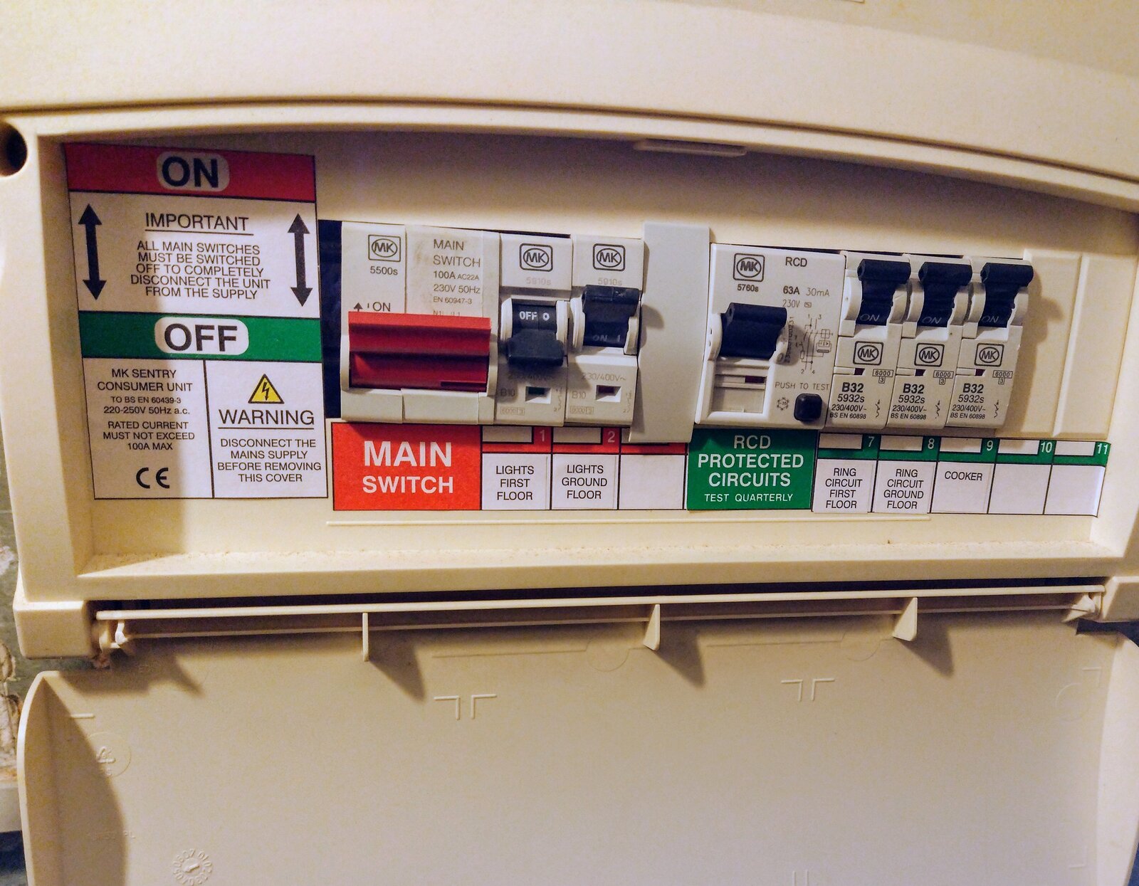

Am i right in saying that my Consumer Unit does not have RCD protection on the lighting circuits?
Correct it doesn’t but those MCBs could be swapped for a RCBO’s so the circuit has got RCD protection

Thank you.
So, i should swap the two lighting MCB's for RCBO's
And i can leave the other MCB's because they are RCD protected?
