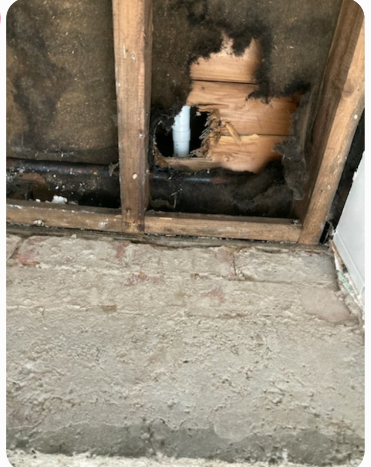

Is it normal to have hole under bath?

Well they had their ceiling replaced as they said it was damp, trying to blame me. Then said when they had their ceiling removed they SAW A BIG HOLE IN MY WOODEN FLOOR BOARDS (I PRESUME THE ONE I HAVE POSTED THE PIC OF) AND THEY SAID IT IS THEIR BUSINESS AS IF WATER GETS UNDER MY BATH IT WILL GO STRAIGHT THROUGH THAT HOLE IN TO THEIR CEILING!! AND I NEED TO GET ALL FLOOR BOARDS REPLACED IN MY BATHROOM! NOT JUST FILL UP HOLE!!!"

Your photos seem to suggest that only the trap protrudes below the floor? [1]
I don't think it is unreasonable that you have a hole in your floor for the trap. My semi has the bath's trap set a little way below the floor, so the bath itself can be set nearer the floor. Any leakage from the bath would only be delayed by floorboards, rather than stopped. Cables and pipes run between floor and ceilings is perfectly usual and just one of the things which needs to be accepted.
I can see his point if his ceiling has been damaged and if true - strictly that would need to be repaired at your cost. Obviously he would need to produce evidence of this damage and its subsequent repair. Perhaps the actual damage, if there in fact was any damage, took place prior to or during the installation of the present bath?
If [1] is the case, rather than having to move and refit the bath, plus repairing the hole in the floorboards, can I suggest....
Find a plastic dish or bowl large enough to catch any slight leakages and add a battery powered electronic leak detector. I have seen these on Ebay, mainly designed to detect leaks from below washing machines and dishwashers.

Earlier, I suggested a roasting dish- I should have said a foil one- they are disposable. You could reshape it into a tin foil bowler hat and slip it under the U bend, the "brim" resting on your floor.
If your floor is wet, you need to sort it. If it's historic damage, is it older than your ownership?
Maybe it's the picture but that waste run looks like it goes uphill...?

Here is the long awIted picture from my neigjbours bathroom? Any thoughts guys?
