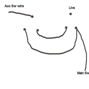

Is it possible, safe and allowed to have the following light switch setup?
As there are two switches to operate, one may as well operate the accent and the other the main and fan.

How about a 2-way switch. One side of 2-way switches Acc and Main lights, other side of 2-way switches Acc lights only which is then wired in series with a simple 1-way switch. So 1-way off and 2-way switched to Acc lights only = all lights off, but Acc lights can be switched on with 1-way switch. 2-way switch to Acc and main lights = all lights on.
Maybe I'm missing something, but I don't quite see how that would/could work - can you draw (or explain in more detail) what you mean?
Kind Regards, John
Second try:
two 2-way switches:
I 2-way live common, one side to main and Acc lights, but the Acc lights go to one side of other 2-way, of which common is switch wire to Acc lights.
Other side of first 2-way goes to Acc lights only, which goes to other side of second 2-way.
so first 2-way switched to main and acc lights, main only on unless second 2-way switched to allow acc lights also.
first 2-way switched to Acc lights only, and second switch to allow Acc lights on.
I'll try to draw it.

... isn't that the problem? As I understand it, the OP wants to be able to use the "main + acc" switch to switch both on (and both off), regardless of the position of the second switch?

This would allow main lights only, also.
I don't think it's a tidy solution 'cos it might cause a bit of switch juggling at first.

This would allow main lights only, also. I don't think it's a tidy solution 'cos it might cause a bit of switch juggling at first.
Yes, I suppose that would more-or-less do it. It might cause some confusion, because if the 'accent light only' switch were in the 'on' position, then switching the 'main+accent' switch 'on' would cause the accent lights to go out! The DP switch approach doesn't really have any such potential confusions!

Off-the-shelf you could use a 2-gang 2-way switch to do it as follows:
Switch 1 (Everything):
Com to main light & fan
L1 to supply
Switch 2 (Accent lights only):
Com to accent lights
L1 to supply
L2 linked to Com of Sw. 1
Turning on the main light with switch 1 will then also make sure that the accent lights are on as well, regardless of whether they were already turned on or not with switch 2.
Isn't that what the OP was setting out to achieve?

Off-the-shelf you could use a 2-gang 2-way switch to do it as follows: ...... Turning on the main light with switch 1 will then also make sure that the accent lights are on as well, regardless of whether they were already turned on or not with switch 2. .... Isn't that what the OP was setting out to achieve?
Yes - as with Himaginn's similar suggestion, that would more-or-less do it. It doesn't guarantee that switching 'off' switch 1 will always turn off the accent lights, but I doubt that would be a concern. The fact that it can be done with a standard light switch certainly makes it a more attractive (and cheaper) option than what I suggested.
