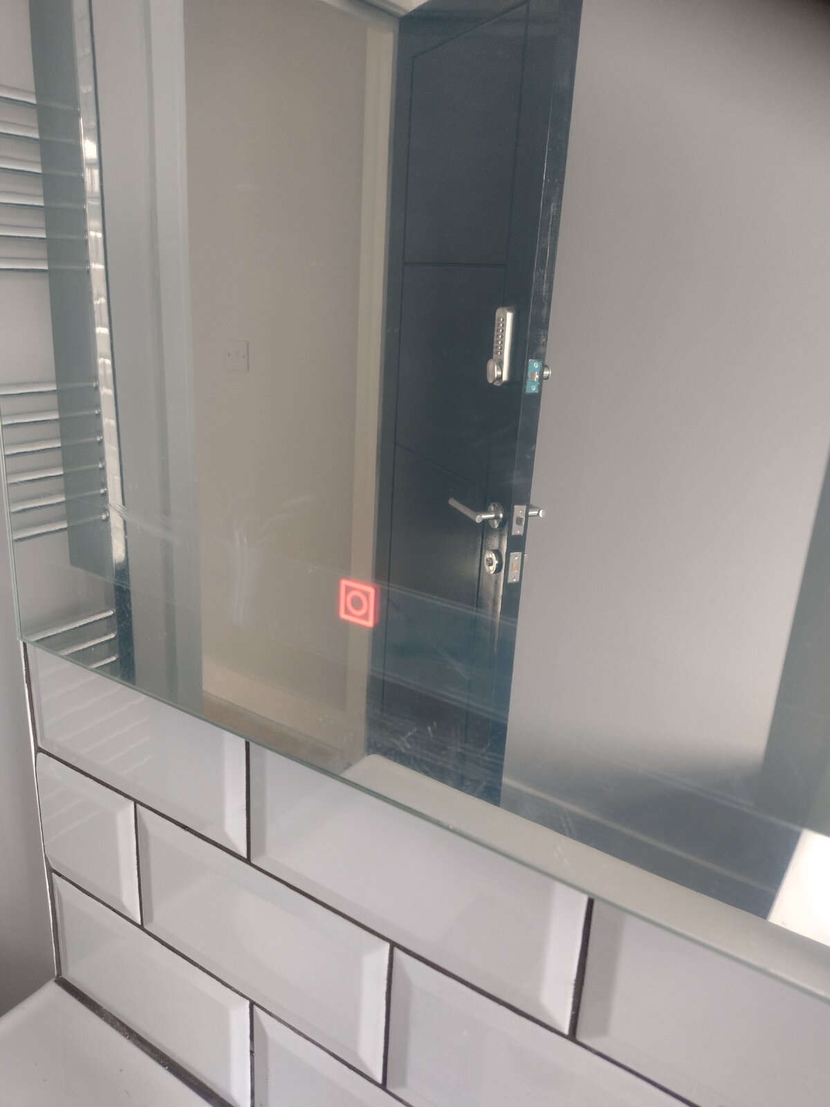

Bought a powered bathroom mirror which I love.
To turn on the light strips, you press the red button on the mirror itself.
When not in use, the button stays red.
I find this annoying and don't want the red light always on
So I wanted to know whether it is possible to disable this?
I'd have to open up the mirror but before doing so, I wanted to ask whether this is remotely possibly?
We still want the mirror to light up but I don't want the red light always on when not in use

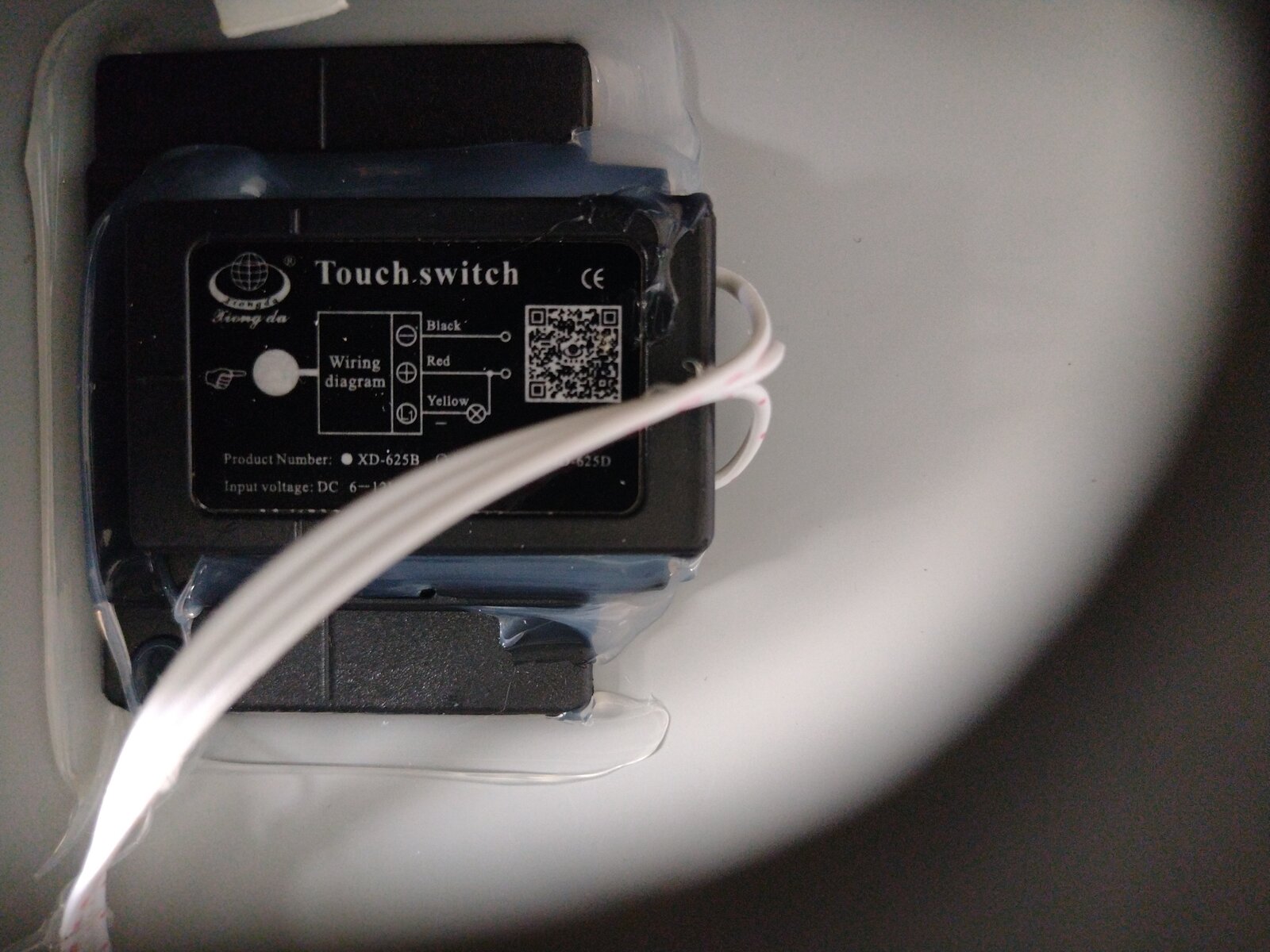

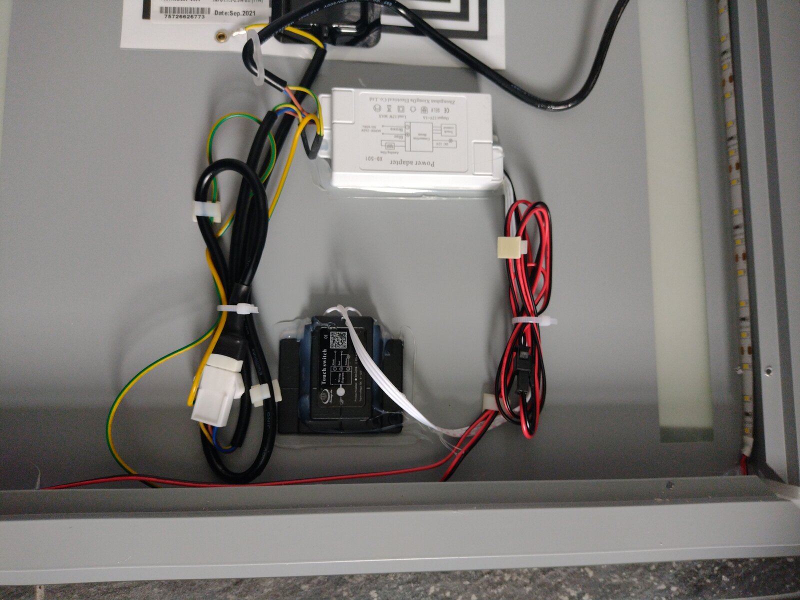

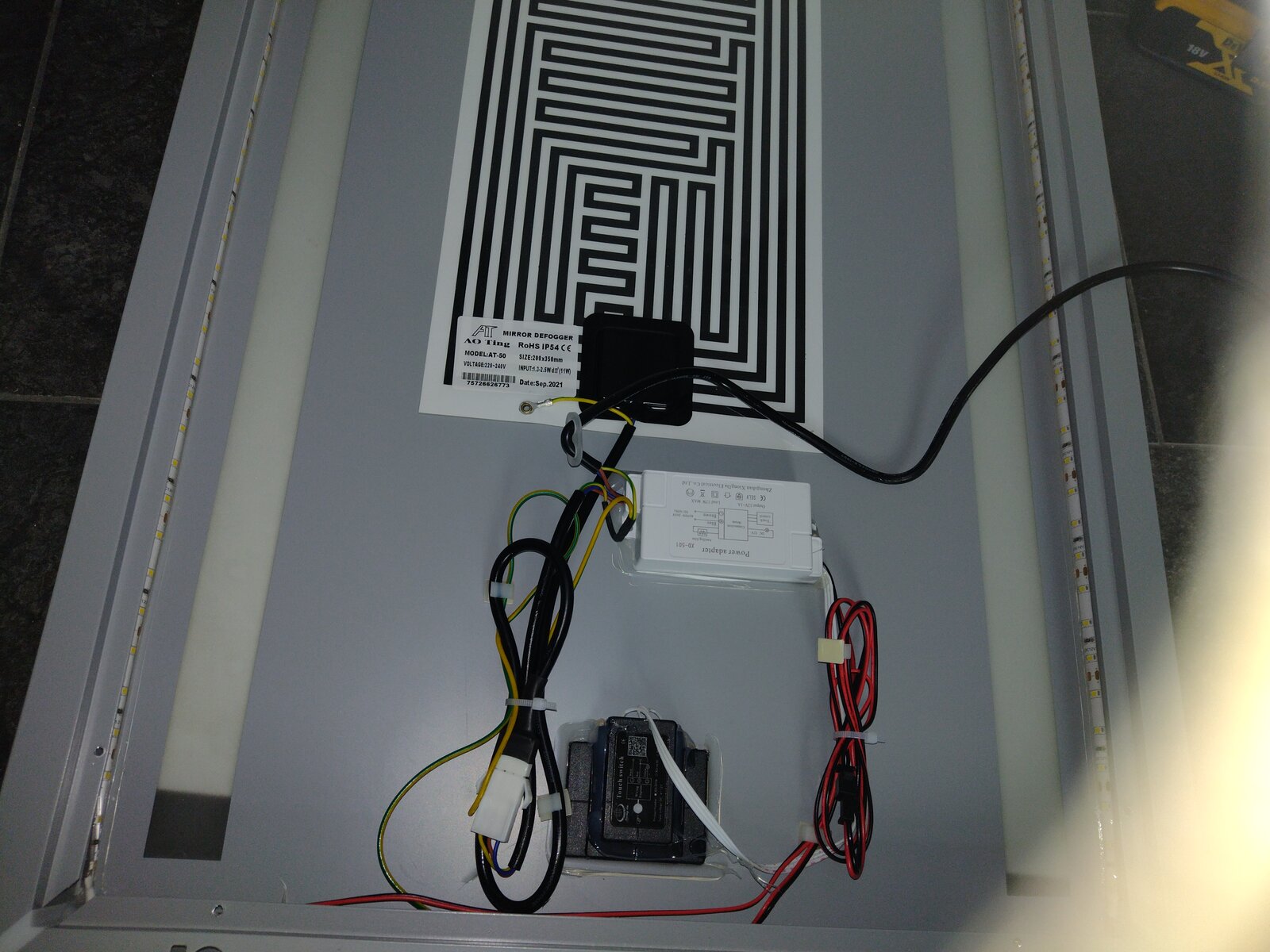

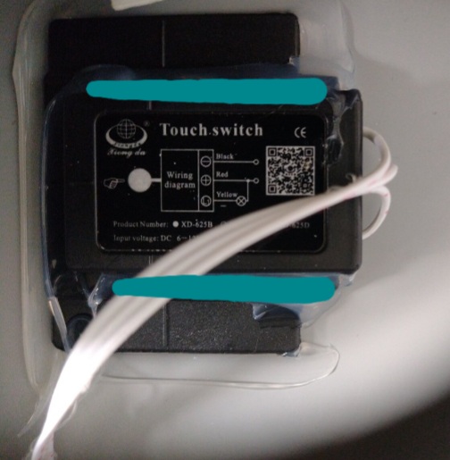

Update: I opened up the mirror and I have attached pics of the switch which has the red led.
It is labelled as the 'touch swich' and it's in black it appears to be glued/siliconed in place.
3 white wires comes out of it and this goes to the 'power adapter' (in white)
@JohnW2 @RandomGrinch what are your thoughts?

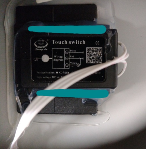

It looks like silicone rather than hot glue?
Carefully remove the silicone/glue along the sides (leaving the backplate in place):
Then slide out the sensor.

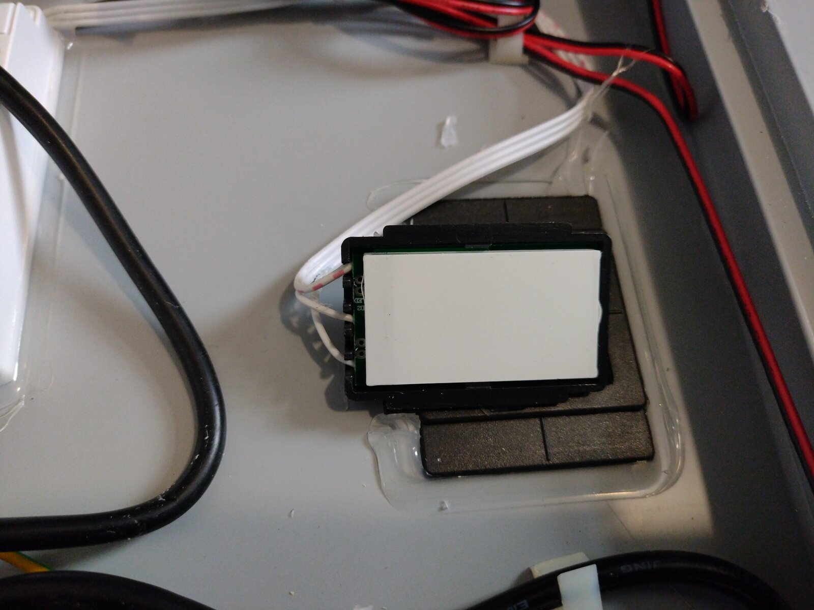

Thank you.
I removed the silicone and slide out the sensor
I took a pic of the sensor (turned over)
If you disable the led, how will other people know where to touch the mirror?
Is this a business property? I have never seen a domestic property with a pin code lock on a bathroom door.
I wondered about that in post #3 - I *think* the etch in the mirror, that allows the led light through, should (hopefully!) also be visible when the LED is off - we will wait and see! :)
I also wondered about the code lock - (ex?) HMO?
