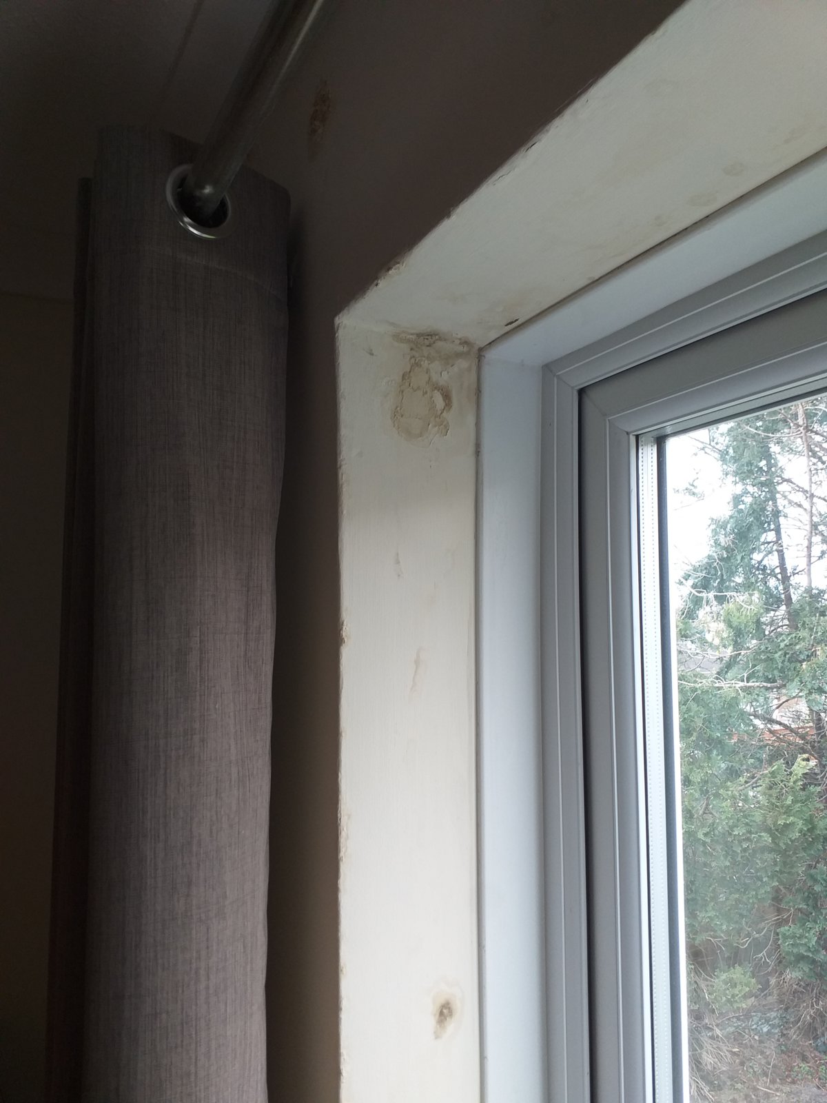

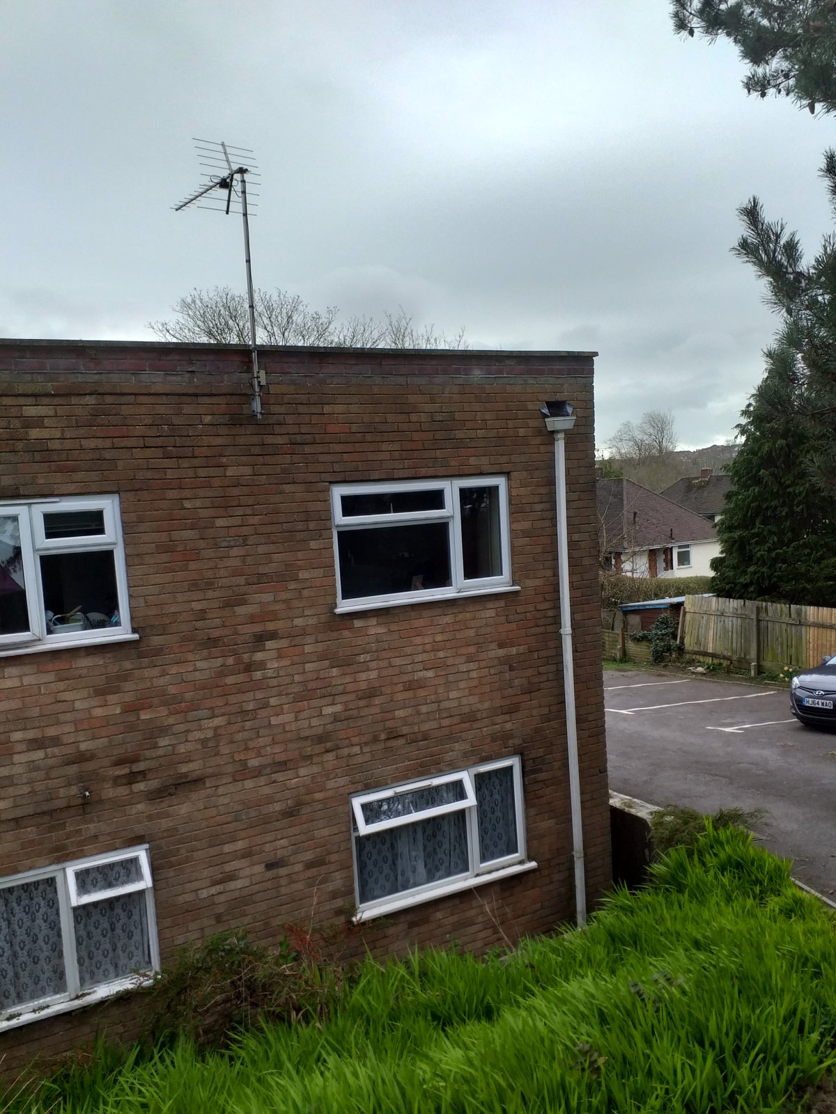

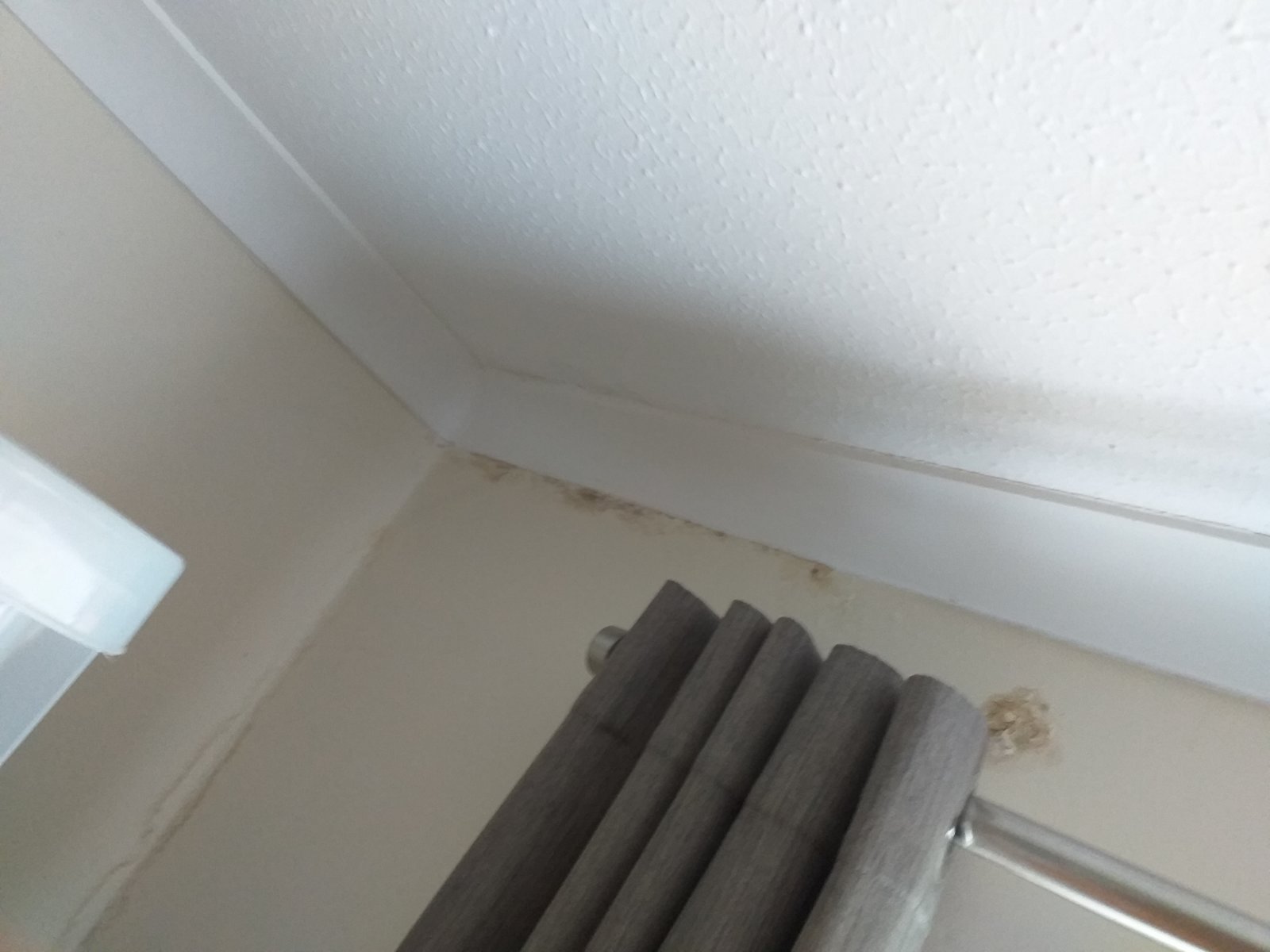

I've had this on my walls inside the corner of my bedroom. Is the roof leaking? It's right near the downpipe (which isn't blocked ) and I had a similar problem on the walls near the downpipe at the other side of my house.
Does my flat roof need repairing or a new one laid? It is moisture, right?
Cosmetically, do I just sand and paint?

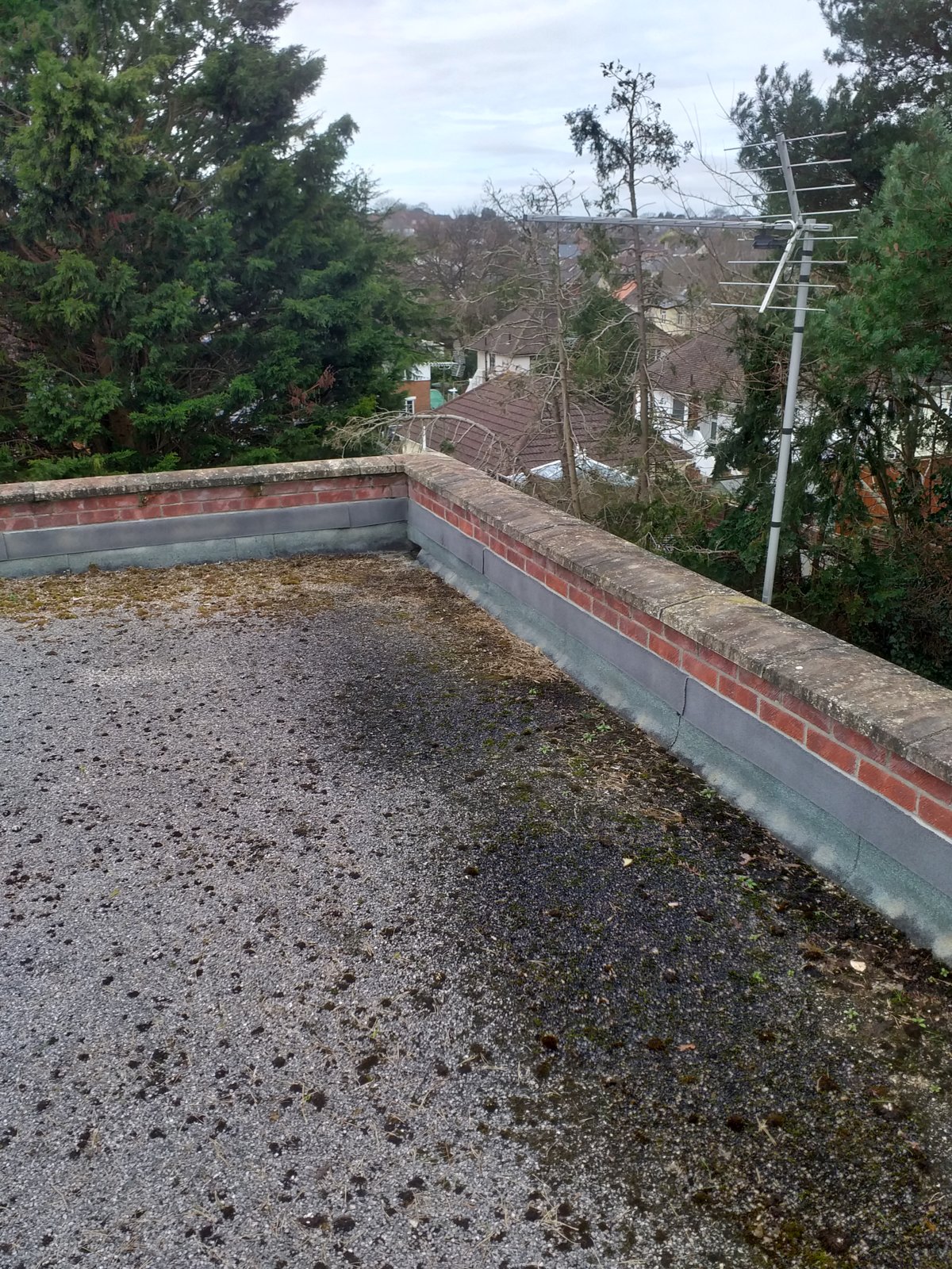

The felt must be leaking because the damage is on the inner leaf. You need a flat roof company to look at it. Modern felt don't need stones on them, so it must have some age. Life span is normally 15 years.
If it was mine, I would strip the roof, take the parapet wall off, fit trusses and tile it off. Only because it wouldn't cost me any labour.
As for decorating, rub down, Zinsser primer-sealer stain killer then emulsion.
its hard to be sure, but the staining below the cornice indicates water or damp getting through the inner skin -implies a roof leak.
the window head and reveal indicate a leak into the cavity -which could be caused by a leaking parapet.
without further investigation its hard to know whether the cause is a fault with the flat roof felt or the parapet detailing.

I would go with the parapet caps allowing ingress of water - as mentioned before. I'm genuinely sorry for your bad experiences of trades. Unfortunately roofing and tarmacing do tend to attract the unscrupulous.
Parapet walls have a dpc in them.
