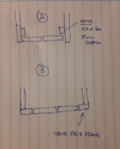

I think that means it will be easier to to start by deciding on what the carcass structure looks like. Is it one of these?

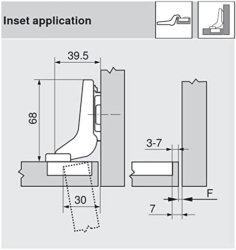

My cabinet looks like diagramme A. I plan to use the Blum 71B3750 or the 75T1750 which i think is the sprung version of the same hinge (i think).

My cabinet looks like diagramme A. I plan to use the Blum Inset 110 Degree Cabinet Hinge 71B3750
Actually your cabinet isn't like either of those, it's a conventional box structure where the hinge cruciform mounts directly onto the cabinet gable end panels and the hingr arms are cranked to accommodate the required throw. This means that when the door is opened to 90 degrees it is parallel to the carcass gable ends, but inside them:

Spot on. My cabinet is conventional box structure. What type of cabinet is diagramme A?
It's the type you sometimes see made up on site for electical cabinets, as per the Skill Bulder video I posted a link to
