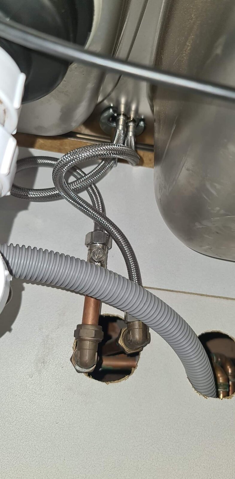

I had to get my kitchen tap replaced today due to a leak, and the one the plumber installed is very shakey.
The plumbers excuse basically was "the wood/metal under the tap is rotting, and he was worried to tighten it too much incase it broke".
Alarm bells are ringing with the work he has done, for example the pipe in the sink was left disconnected after he left which I had to put back on myself, so I am not exactly full of confidence!!
I have attached a video and a picture of what I mean.

Nothing under there, which appears to be rotting. Your original tap was perhaps copper pipe all the way, which helped stabilise. He has used flexi pipes which give no support at all to the tap.
One way to make it more stable, is to cut a piece of material to go under the metal sink, as big as reasonably possible, to fit under the tap clamp, to spread the load. Usually a bit of 6mm ply or similar will do it, cut to fit into the recess.
That RH flexi looks as if it might be twisted in the photo.

A cheap s/s sink will flex quite a lot, but if you look at the vid, the tap is just plain loose, it's rocking about and the skin of the sink isn't moving.
The retaining nut looks like it would be a nightmare to get onto so I guess he just nipped it up with his fingertips. I'm sure a good plumber would have a tool to tighten it properly.
There is usually a clamp of some sort on taps of this general style to prevent rock and seal off the tap. Looks like the rubber is there for that. The clamp might be a couple of screws and a plate that can be seen underneath. If they wont clamp firmly they probably need shortening.
Hard to see what is there from the photo. A close up would be better just showing the connection to the tap and the area above them.
Loads of people use flexible tap connectors.
He didn't fit the extra backing plate which is normally fitted to s/s sinks. Most plumbers always carry a spare one if not included in the tap fitting kit.

A plumber that doesn't carry a spanner for getting into awkward places? Says it all.
Somewhere, in one of my tool boxes, I have a standard set of 8, 10 and 13mm which are bent at right angles for these kind of situations and I'm not a plumber.
