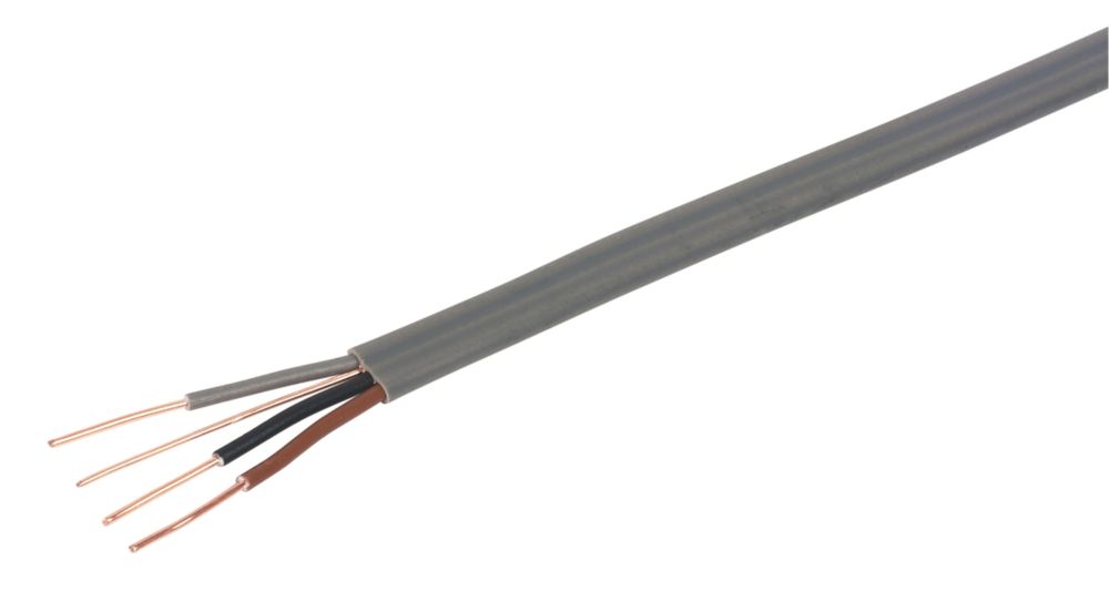

So it would seem only problem is with intermediate lighting switches? Looking at a standard triple and earth
ae235
if grey always is permanent line then the earth will stop LED's glowing. Only with intermediate switches is there a problem in that L1 and L2 are swapped so permanent line will not always be other side of earth to other two cables.
So have I read your answers correct? on/off no problem and two way as long as grey permanent line no problem only with intermediate switching is there a problem and the suppressor is used only with intermediate switching?
ae235
Unfortunately not.
With two way switching you have the permanent live and the switch live but you also have at least one wire that depending on the position of the switches may be connected to either the permanent live or to the switched live. Capacitive coupling to and from that wire must be considered as well.
Unfortunately not.
with lights off and we are not worried about with them on the brown wire between the switches is the only line wire. As long as we use the grey wire for this link then in off there will always be an earth wire between line and dead wires.
Unfortunately I would have naturally selected the brown wire as permanent line not grey as I did with drawing. With old cable then blue would have needed to be permanent line which does go against the grain.
