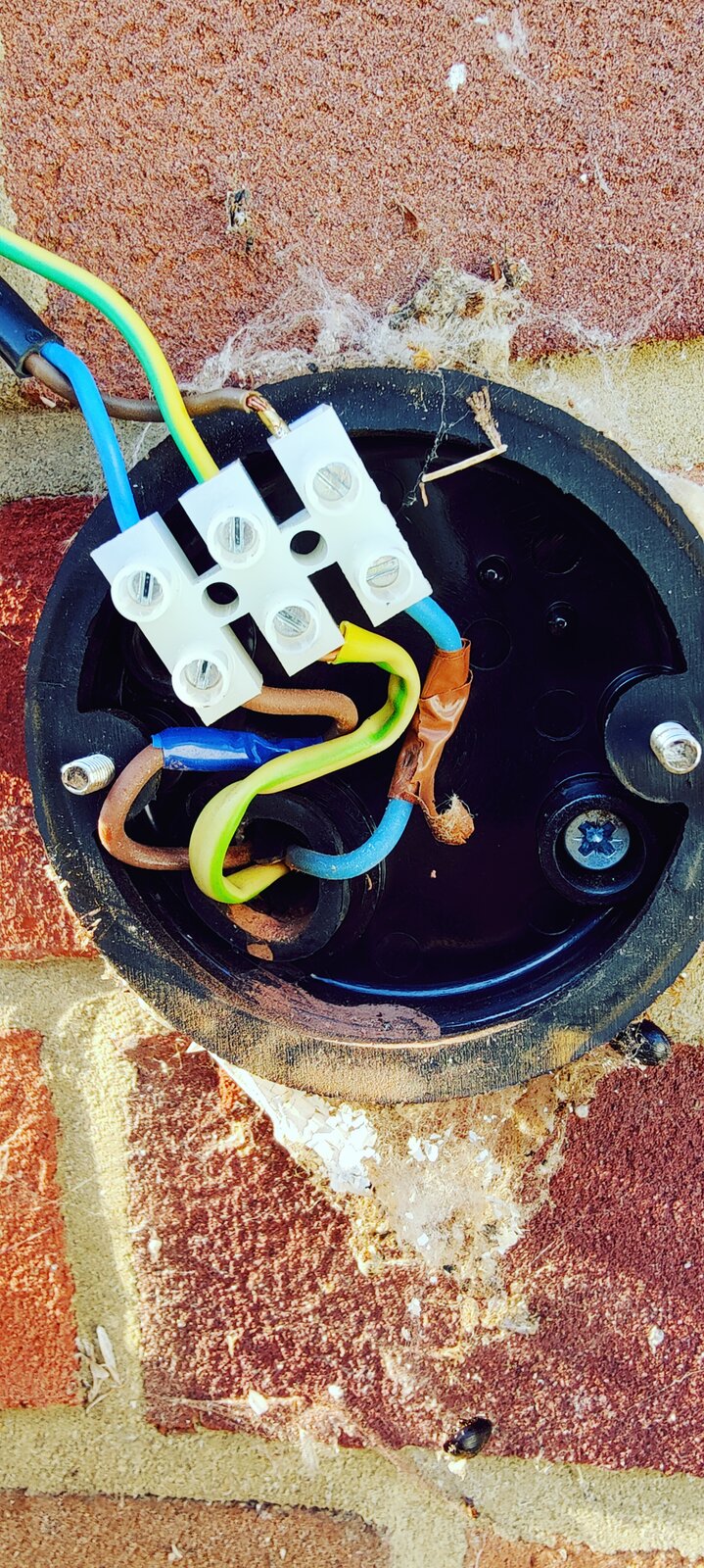

I am changing an outside light
when i removed the light. It had brown tape on the blue wire and blue tape on the brown. :unsure:

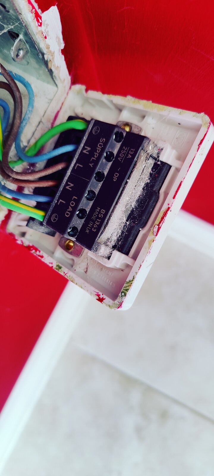

So i inspected the spur. spur had LOAD wired in reverse (L and N reversed):notworthy::unsure:
But the wires going from the socket to the spur all seem correct. (until they get swapped going into the spur)

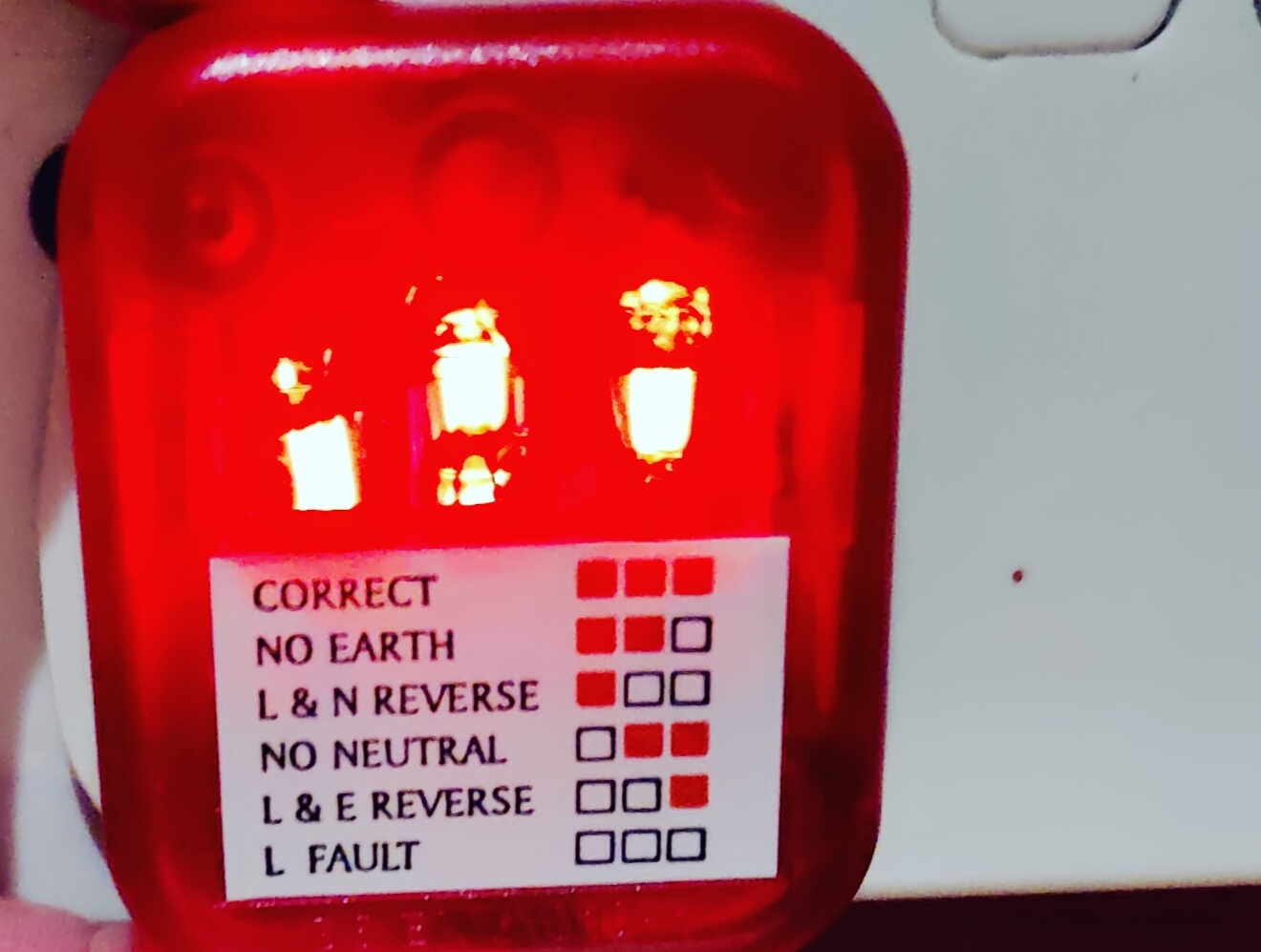

On testing with the pen tester thing ...the L was giving a signal. so I think all the mains sockets are good. plus I tested the socket with the plug in test thing,

outside light
inside
Well, to be accurate it is only the colours that are reversed; the actual L and N are correct.
Hang on..the LOAD part of the spur has L an N .. Reversed..
The Supply part looks ok.. but it's been reversed by then..
Am I getting this right

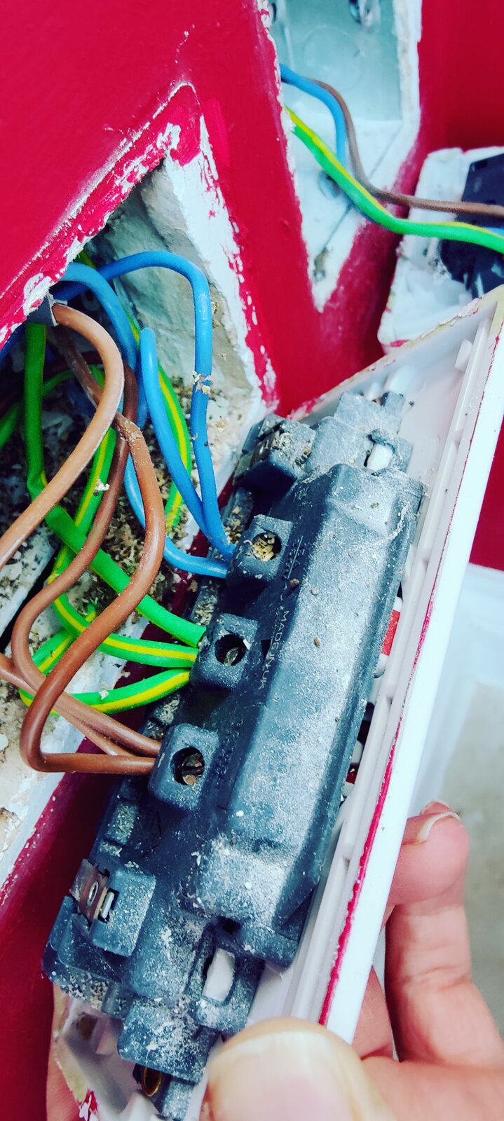

The cable going though the wall is a single piece of twin and earth with no joins.
The cable coming from the sockets to the spur also appears to be a single cable. And the pen tester indicates live on the line coming to the spur.
So that all looks ok
If you was to forget about colours it's still the same and would work as normal, just cant get my head around why.
I suggest the original light fitting was a basic bulkhead or so where the error at the switch simply wasn't noticed. moving on and the light fitting was changed by a DIYer and the error was spotted and sleeved.
Quite a simple scenario.
'course it's also possible there is a brown to CPC fault and this botch stopped the MCB tripping.
Looking at the pics again the switch still looks original and doesn't look got at. So doesn't look like a DIYers secondary balls up
