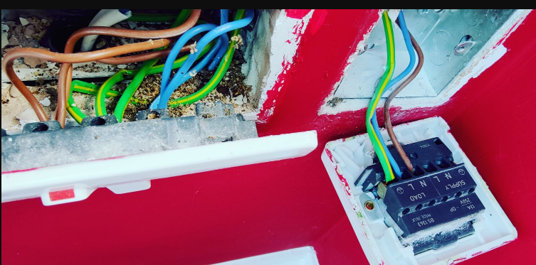

Is there any reason a spur would have L and N transposed on the load? (Ed.)
I suggest the original light fitting was a basic bulkhead or so where the error at the switch simply wasn't noticed. moving on and the light fitting was changed by a DIYer and the error was spotted and sleeved.
Quite a simple scenario.
'course it's also possible there is a brown to CPC fault and this botch stopped the MCB tripping.
Yeah there are drill holes for an outside lamp before the one I'm changing. I thought someone just added tape rather than investigate the problem any further down the line...
Brown to CPC... MCB tripping. What's this and can I test for it?
It looks like the spur was wired by a professional, who made a mistake by connecting the load wires the wrong way round.
It looks like the outside light was connected by an amateur, who at least realised the live and neutral were reversed and went to the trouble to sleeve them to warn the next man.
I would connect the spur up the conventional way, and then check the polarity is then correct at the light, and if so, remove the coloured tape.
What's these bits about tripping things.
If there were no RCD protecting the circuit, and L/brown, were shorted to earth, then it would repeatedly trip the MCB. As a botch, someone might have remarked the brown, as blue/neutral, which would allow the circuit to work normally, without tripping the RCD. A neutral shorted to earth fault, cannot be detected by a fuse, or MCB.
The supply, versus load side of the switched spur being swapped, will make no difference, but correct it anyway. It's just a matter of easy identification, for anyone who follows on later.

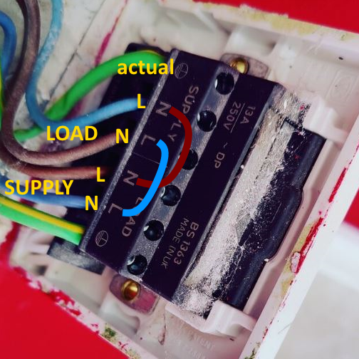

Hang on..the LOAD part of the spur has L an N .. Reversed..
Am I getting this right
Not sure.
The SUPPLY is the cable from the socket and the LOAD is the cable to the light.
So according to this picture:
Weren't they the wrong way round as well?
The Supply part looks ok.. but it's been reversed by then..
Except it appears NOT to be the SUPPLY
So the SUPPLY (if that goes to the light) and the LOAD are also the the wrong way round.
Am I getting this right?
Yes.
It's crossed over at the load input
Still crossed over at the Supply output (but the colours look correct)
Then at the light obviously still crossed over.. So someone added tape.

Not sure if you are understanding correctly.
Apart from the wire colours being crossed over, the supply and load are crossed over as well.
The supply is the cable from the socket and the load is the cable to the light.
As with the colours being crossed over, this doesn't really matter unless the FCU (Fused Connector Unit - the cable is the spur) has a neon warning light which would then be on all the time.
Would you please confirm for me that the cable in the FCU load terminals is the cable from the socket - i.e. actually the supply?
Yes, which made it apparent something was not right.

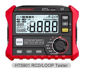

This should be soon apparent when corrected, however as far as testing goes, the problem is the cost of the meter to test it. These meters VC60B.jpgLoop impedance tester.jpgare the cheapest I could find, blue one £35 and tests installation only, red one £70 and also tests the loop impedance and RCD as well, however having them does not mean you can use them.
With the switched FCU turned off, testing both lives (Line and Neutral) to earth with a cheap meter on the ohms range will only show a direct short, and even a plug in tester with loop, 1726836842172.pngwill not likely show a neutral to earth fault. The problem is neutral is outside ones house connected to earth, so only way to test is with the circuit isolated, a MCB does not isolate it only turns off the line, a RCBO also normally does not isolate although some do, so the switch on the FCU or the RCD, or isolator needs turning off to test neutral to earth.
And water will often connect a wire to earth enough to trip a RCD but not enough to detect with a meter using 9 volt, the meters shown use 500 volt.
So if swapping the cables correct way around works without tripping anything then all seems good. But if it trips then likely neutral has an earth fault, which needs correcting, as it can cause what seems random tripping of the RCD. So may as well swap to correct colours, but both line and neutral are classed as live, so colours being swapped was not really a problem. It just raises the question why?

The wires coming from the socket go to the load. The wires from the supply go to the light.
Is that the information you're asking for.
Ok. Yikes Thanks for that.... so that's also bad... crikey..I don't know why I didn't spot that in all the goings on.
How on earth was it working wired with the supply and load the wrong way?
Well, it's not that bad but there is no point doing it because then all the "identification" is wrong.
That is all the colours and L and N markings are - identification.
Because it doesn't really matter - the switch just connects two wires together; it doesn't know which is which - unless, as said, a warning light to tell you it is 'on' would be illuminated all the time.
