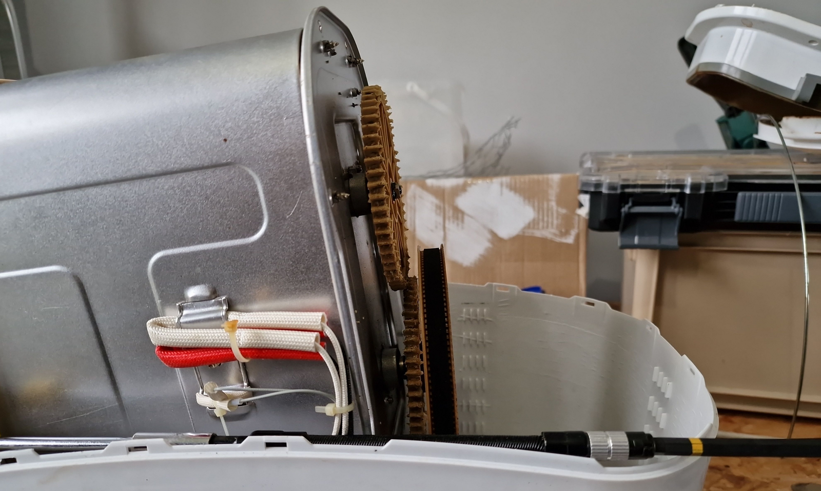

Here's this year's bread maker - Breville VM015:
The two large gears aren't aligned properly, so they slip past each other [sometimes, but not all the time] and it makes an incredible racket. I think the bearings are worn so that's why the gears are no longer in the same plane. I could probably replace the large gears with pulley wheels...if it's worth the effort.
Might it be the case that the teeth have worn down?

Ours seems to be OK, but in the past we have bought items which could be repaired, until discontinued and parts no longer available. First one had a toothed belt, and replaced it a couple of times, then could not get replacements.
This one just seems to be a design flaw. The toothed gears are so large that the leverage means they will only engage fully if perfectly aligned. Any play in the shafts and that's it, they grind each other up and align even worse. It made it out of the warranty period, so it was engineered just well enough, I guess :(
