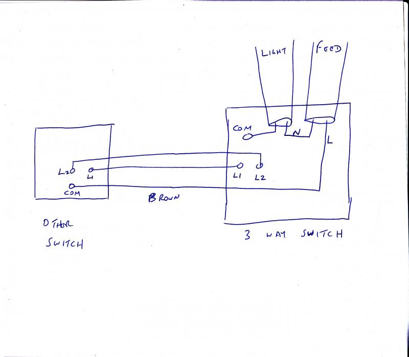

Hi, hopefully you guys will be able to clear this up for me. A friend is having to rewire the house he has just bought, I'm giving him a hand and his electrician has run all cables in and is happy for us to do second fix before he comes to sign it off. I have 2330 and regs just not part p or testing and inspection yet. I'm almost hoping I've not missed a simple trick here being shattered in evening but if I explain the switching for kitchen light I'm hoping someone could shed some light. The basics are this, there are two switches in the kitchen. One is a two gang and one is a three gang. The two gang has the feed from the kitchen light going to it and also a light out to conservatory. It was decided that a 3 core would be run for this from the kitchen light so as to achieve a neutral as access to conservatory is tricky. This switch seems fine for me to wire up, it also has a second 3 core going from this switch to the 3 gang switch also in the kitchen. The switches for this are: 1x1.5 twin and earth which switch two lights in an alcove within the kitchen, one 3core which is linked to the first switch in the kitchen and a third 3 core which goes to the front room 2 gang switch as they wanted to turn kitchen light off from front room.
It seems to me that the 3 gang switch in the kitchen is acting as an intermediate switch? Is this correct? So how do I go about connecting the two 3 cores into the switch itself?
So, really you have two way lighting with the loop-in at the 3-way switch. Yes?
If so this is not intermediate (the only time that you need that is if there are three or more switches operating the same light.
I dont have time for a pretty drawing, and it is not the best method, but using the wiring that you have got you are stuck with doing this:
EDIT. Pic should say 3 gang switch, not 3 way.

or use the other method, which means one less joint in the right hand switch.
The differences are: (in right switch)
You connect the COM to COM
The feed live wire goes into L1 (as well as wire to other switch)
The light wire goes into L2 (as well as wire to other switch)
