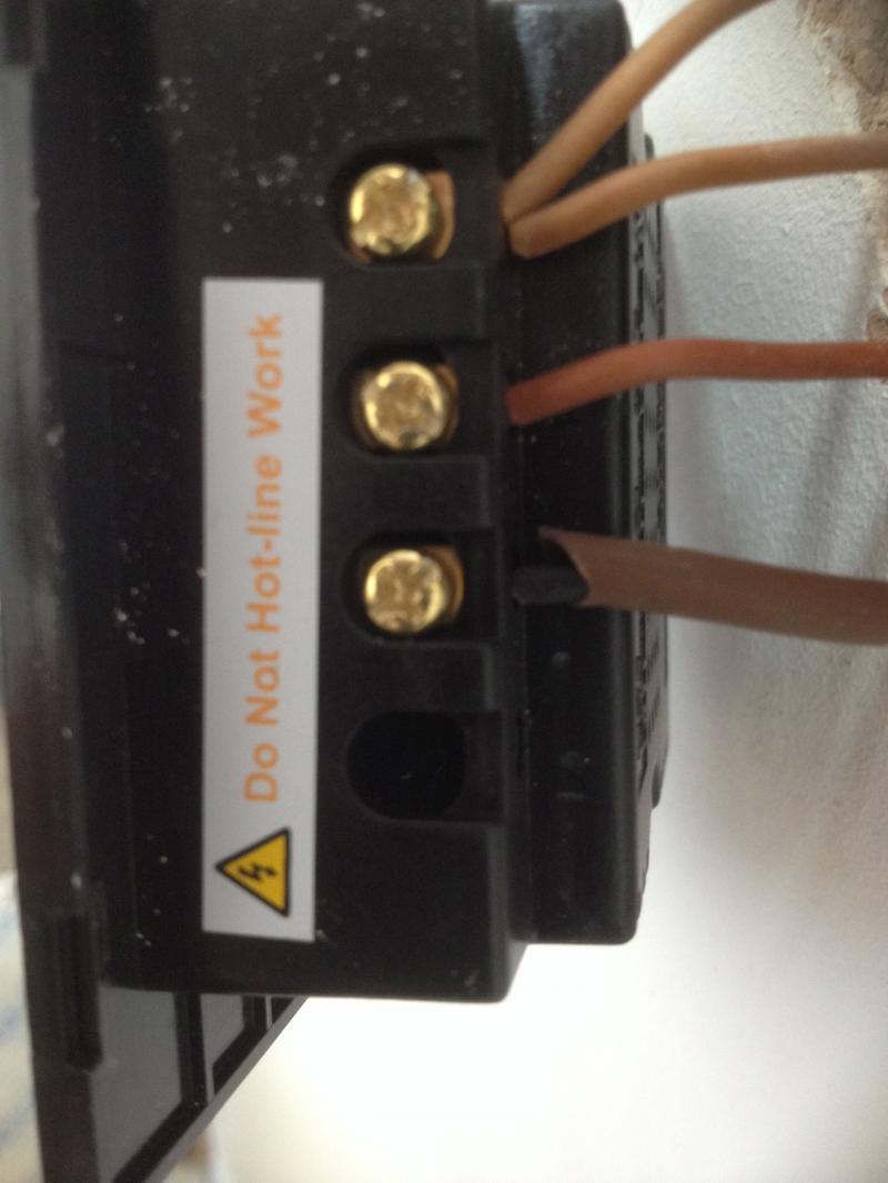

Slight diversion.
This week I was installing a large quantity of fancy RETROTOUCH switches for a customer.
One of the switches was marked with this warning label
I have asked the manufacturer to translate this into English, but have had no reply. Does anybody fancy having a guess?
