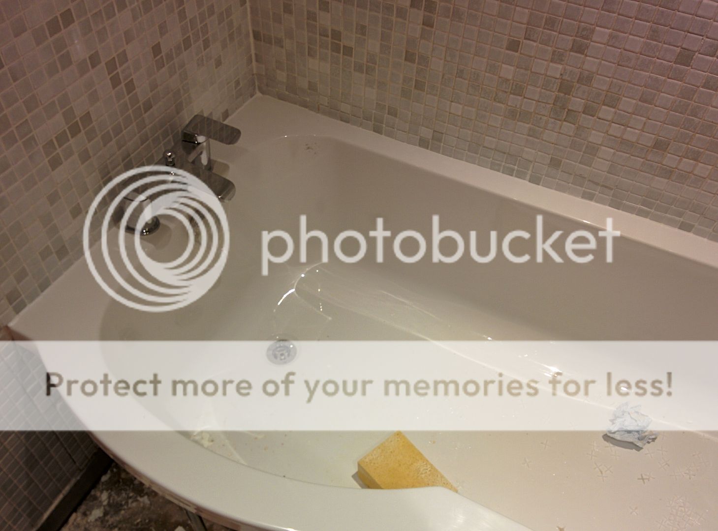

Just fitted a reinforced shower bath from bath superstore.com they are a reseller for Trojan plastics. Very heavy and nice quality.
I kept telling the customer to get the thickest bath they could. Then there's me sliding backwards on the stairs as its some damm heavy!.
