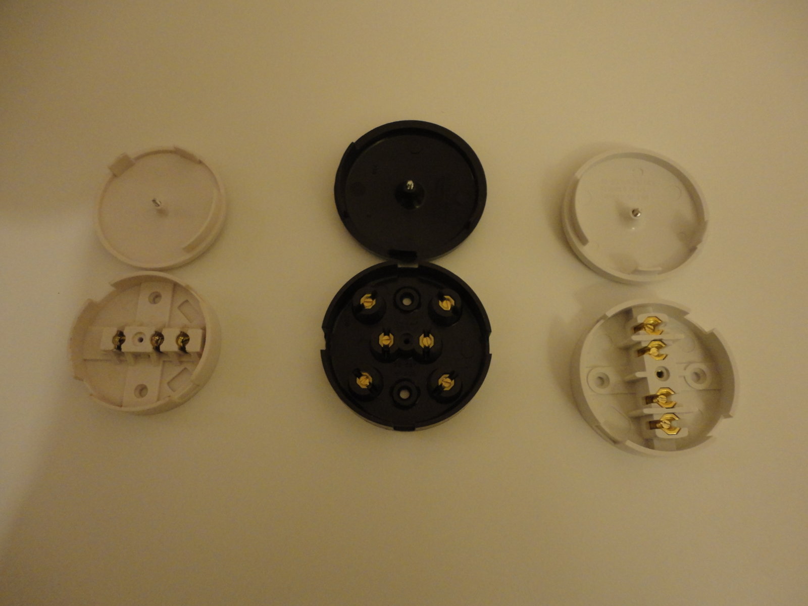

I am surprised about the comments on using 30A or 20A junction boxes. I have a couple of 20A ones as well (see photo) and cannot see why they would be any better. (If one had paired terminals so that the 2.5mm cable went into one and the 1mm into the other, maybe.)
Without extending the debate further than need be, is there any problem with using the 30A (3 terminal) box?
