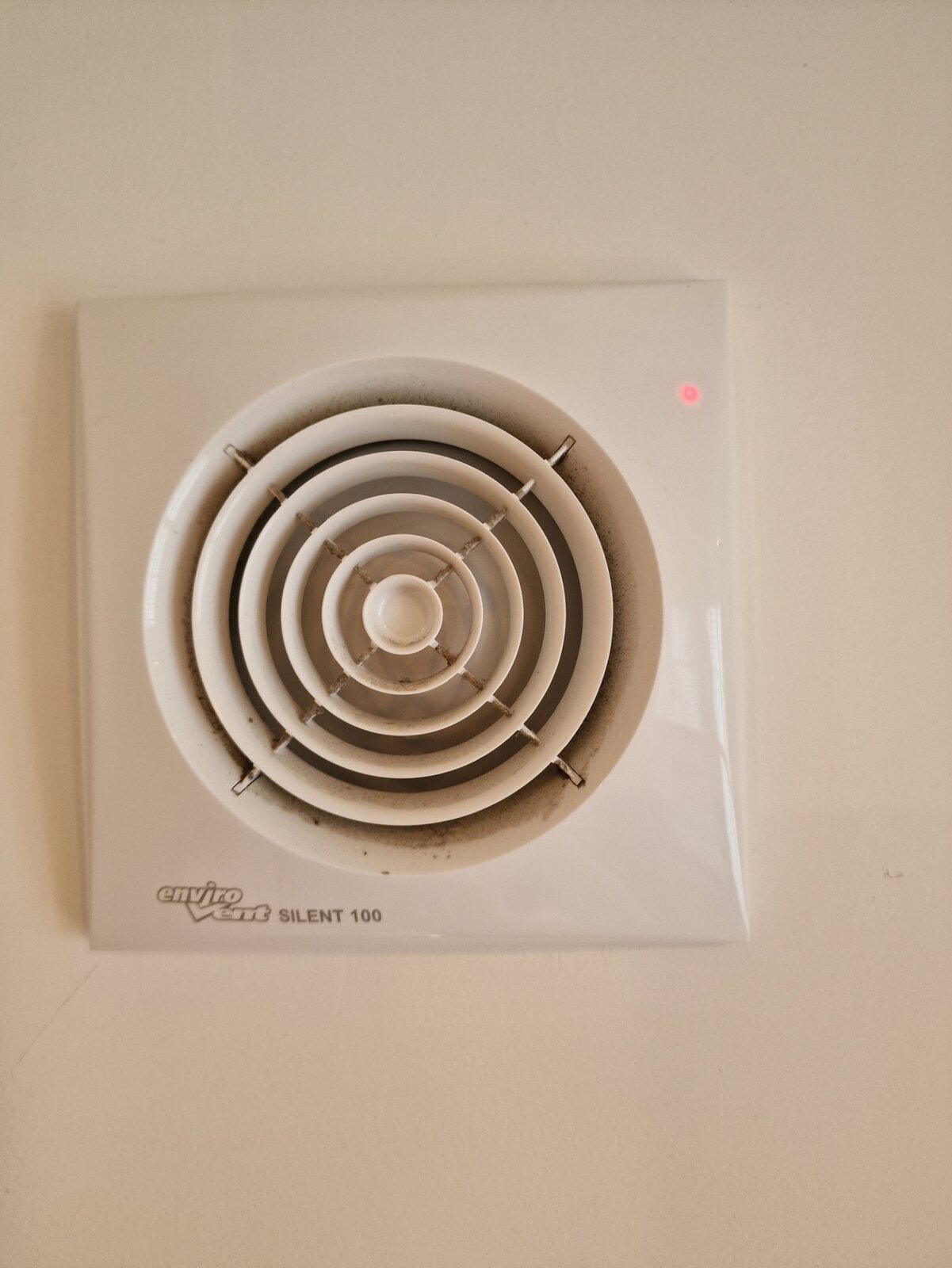

I have the extractor switched off since it's quite noisy in my bedroom. Whilst on the subject, can anyone recommend an effective and quiet extractor or ceiling dehumidifier?

Yes. Please post a photo of the one you have, and the outside vent. Can you see a makers name or model?
Does it go straight through a hole in the wall? Or is there a duct, for example in the loft?
Is it a 4-inch (100mm) diameter fan?
Does it turn on with the light switch, and does it have a timed over-run?

I have this. It's with a timer switch and a timer as well, through the wall to the outside.

By the way, you have just told us the reason for your excessive condensation.
I'm never convinced about these little things doing so much work as to remove all the condensation. They're in a corner and run quite low.

Well that's interesting. The Envirovent Silent 100 is one of the best, though yours looks rather old.
The current one has a ball-bearing motor mounted on resilient rubber. I find them very quiet. Inaudible with the door shut and drowned out by the noise of e.g. a cistern refilling or outdoor noise if the window is open.
I suppose yours might be worn out, or possibly the fan is rubbing on the case, or the case might be vibrating
Push the case with your finger to see if it is vibrating.
If you take the front plate off (clean out the dust) you will see if the rotating fan is rubbing. This can happen if it is distorted by tightening tbe screws on a wall that is not flat.
Does it seem like it might be a worn out bearing?
