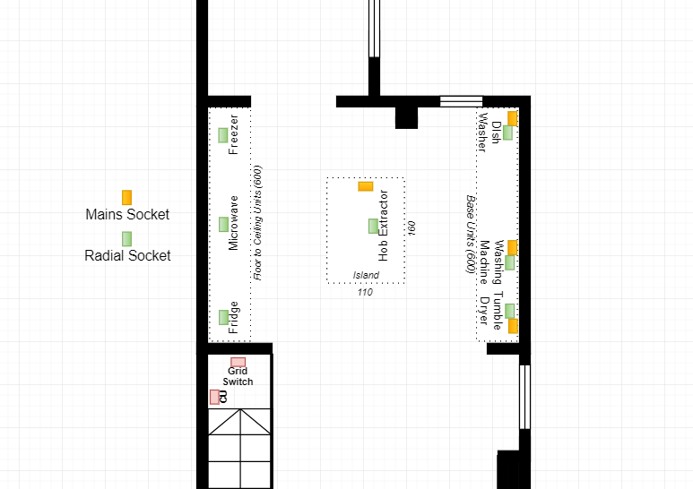

Is this okay? Kitchen Isolation Grid Plate Diagram

Views about this are clearly polarised, with quite strong views on both sides. In relation to your last point above, those who are 'anti' (not me, I'm essentially 'neutral'!) would say that the converse is also true - that, with switches, appliances like fridges and freezers can be "accidentally switched off without realising"!
The one thing which is clearly true is that, as flameport has said, to have all the major kitchen loads connected right at the very end of one leg of a ring circuit is not appropriate (and not compliant with regs, either).

Would the longer length of cable serving the kitchen sockets serving perhaps a kettle, toaster occasional low power small appliances provide enough current once combined with the shorter cable?
Current from something connected to the ring divides between the two routes back to the CU in inverse proportion to the lengths of the two paths. Hence, if the load is, say, only 10% of the way along the ring, 10 times more current will go via the 'short' route than via the 'long' route - hence only one-11th (about 9%) of the current will go by the long path - and, more to the point, around 91% will go via the short route.

would you rather a ring circuit wired in 2.5mm2 serving JUST the bank of switches?
I would not suggest anyone had such switches.
If someone insisted they had them, it would be done as a 4mm² radial with MK grid switches which can accept 2x4mm² in the terminals.

Thanks all for your inputs.
I understand the load would be very close to the CU which isn't ideal.
Equally I want to be able to easily access integrated appliances power supply.
What is the most common method to do so? Should I just install switched sockets as part of the kitchen ring above/below or in adjoining cupboards to the appliance to switch them?

When it is done (and, as you have been told, it's not 'necessary' and some people seem to have quite strong views 'against it'), the 'most common method' is probably what you are proposing. BUT (because of the layout of the circuit and the location of the CU) with the bank of switches much closer to the centre of the ring - in which case the issue of potentially loading the 'short leg' of the ring doesn't arise.
Since that's not possible (without being silly and installing lots of 'unnecessary cable'!) in your situation, the best alternative would probably be what you have already been told - namely to use a 4mm² radial (rather than a 2.5mm² ring), and use decent grid switch modules (like MK) which can happily take 2 x 4mm² conductors. With such a radial, it doesn't matter where the loads are connected to it.

I can't see the problem with fitting 4mm cable, rather than 2 lots of 2.5mm cable.
Would this be regulation compliant?
4mm cable to the grid switch
2.5mm cable for the ring.
Both fed from the same 32A MCB

What about 2.5mm ring for kitchen worktop sockets and then separate 4mm radial to grid switches for appliance sockets?
Sure, that's what essentially has been suggested, since we've only really been talking about the grid switches for appliances - it is that which (if you're having the switches) would be best on a 4mm² radial.
An alternative, of course, would be to have the grid switches on just their own 2.5mm² ring circuit (hence with both legs of the ring would be almost equal in length). That would almost be a 5mm² radial, but it might be slightly easier to implement, since one would only be having to deal with 2.5mm² conductors in the grid switch terminals.

Thank you John. You have been very helpful on a number of topics of mine.
I think I will run the grid switches on a separate ring and then have the conservatory and kitchen sockets on a second ring. (instead of having separate rings for kitchen and conservatory this balances things and still equals two circuits instead of three).
