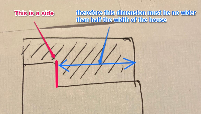

As you are also extending off the side of the garage it would need to meet all of the criterea for a 'side extension' as well as a 'rear extension'. And as Mr Planner has pointed out it's non compliant as it's too wide.
But with the garage been part of the original dwelling then surely it’s just a rear extension?

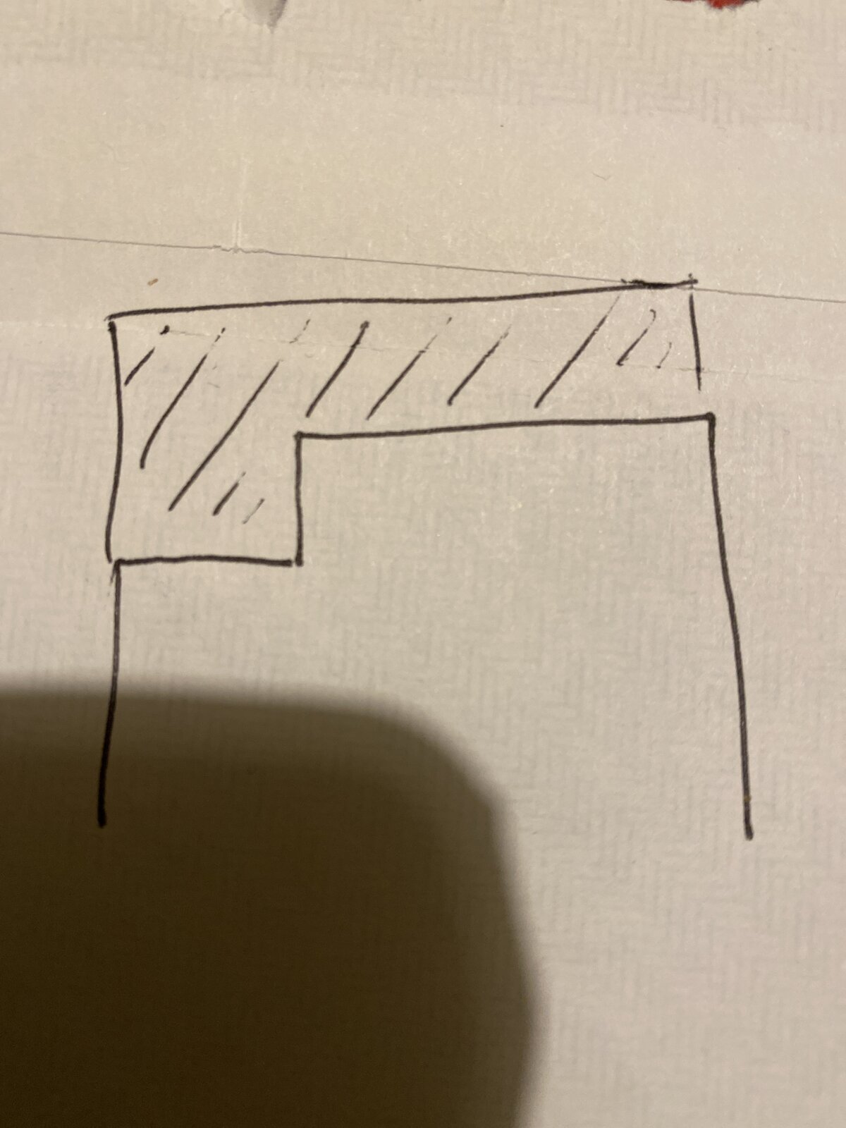

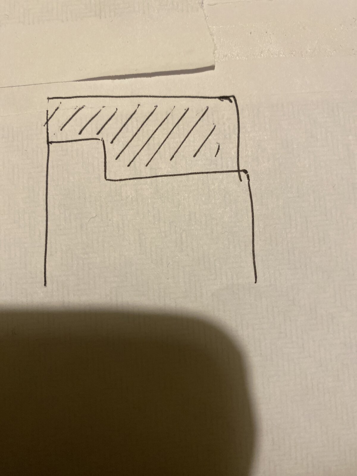

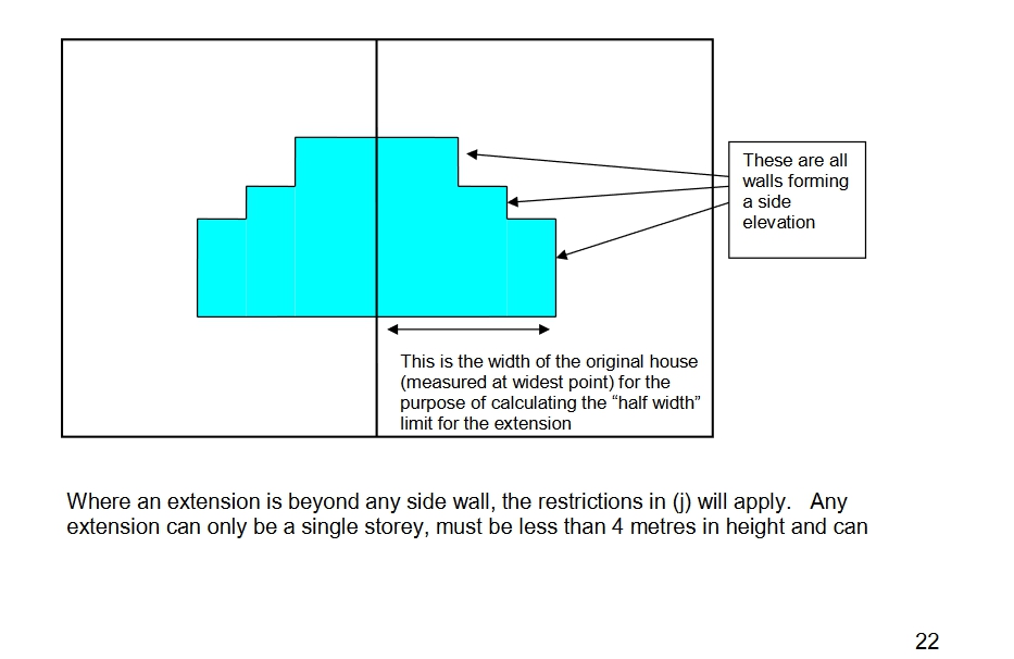

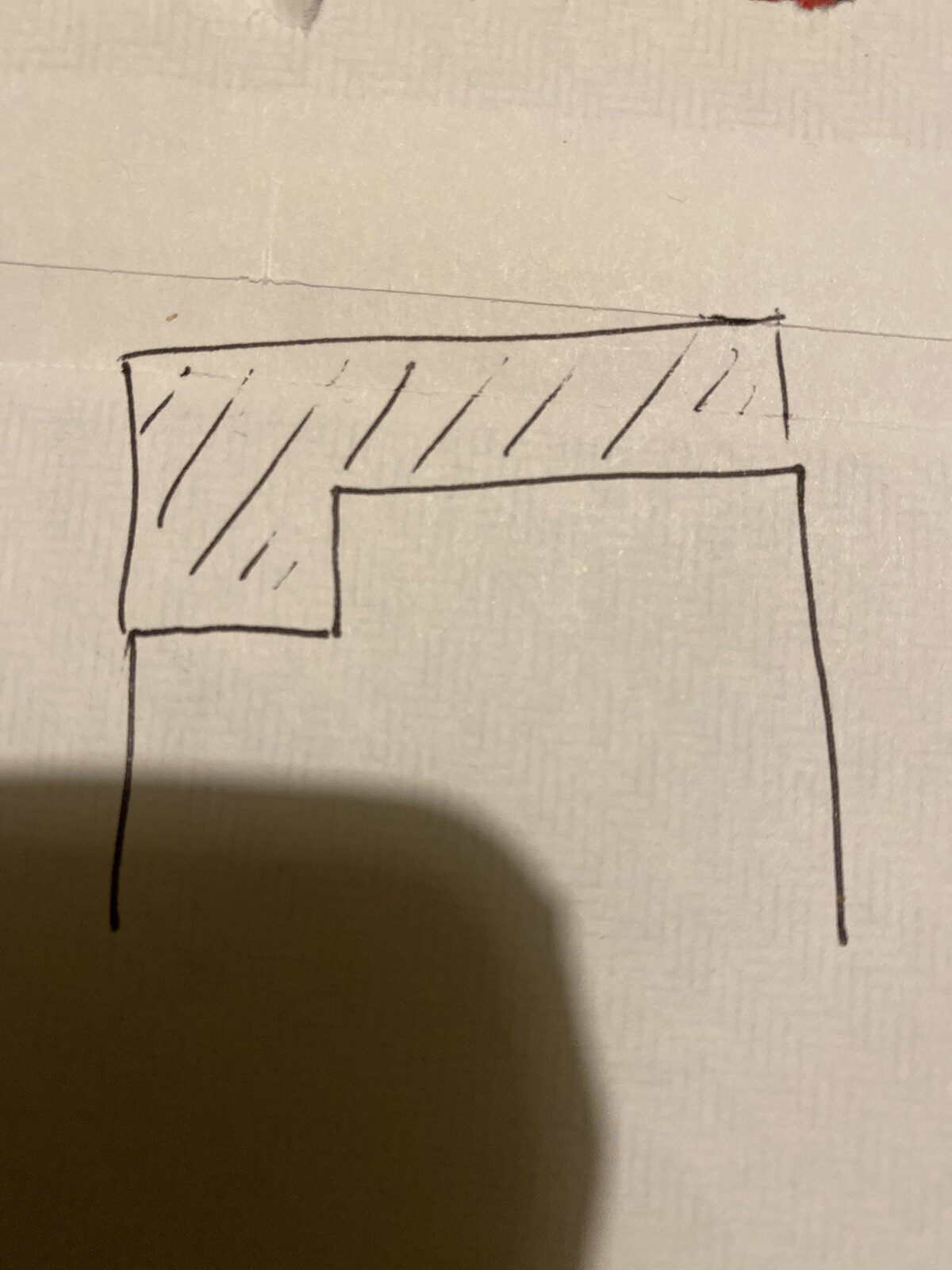

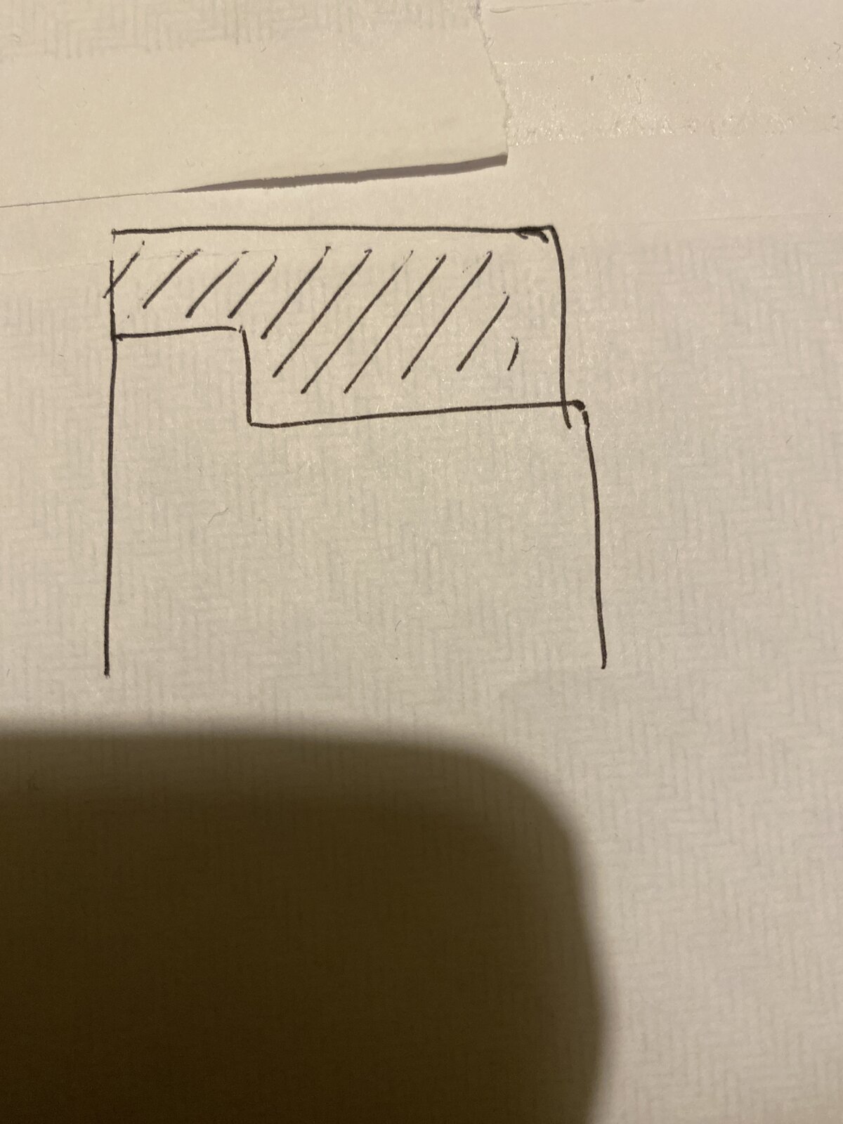

Ours is stepped the opposite way, the garage is originally set further back from the rear of the bungalow. On page 23 the steps are forward if you get what I mean?
The first doodle I’ve uploaded is like the example in page 23 but ours is the the 2nd doodle. Is it the same thing? I’m genuinely confused. Are you saying If I didn’t build behind the garage then it would be PD but because I’m building behind the garage then that’s why it doesn’t comply?
