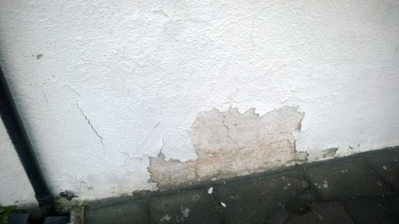

Had a few rendering quotes through, does this look right:
Yes strip most or all old render , treat with s.b.r/an til sulfate-maybe.
Start again rest new smooth waterproof render. With salt inhibitor
New drip beads bottom of wall at damp coarse level .
New drip bead a rounds windows make Walter-tight.
1/2 scratch coats .
1 top coat render with small amount of lime - stops cracks/allows to breath.
I render 1st class no nasty bumps/dips
I float 2 times/sponge 2 times with soft and hard sponge - taking exsess sand build ups off.
Many other methods - developed over 15 years of plastering-e.c.t
You will need to supply a scaffold.
You will need to supply materials- basic stuff 1 tone Building-sand 1 tone washed -plastering sand. Waterproofing/bonding agent.
I guess materials - 400/500 top wack.
I can do this for u 4 1800 pounds.

I wouldn't have much confidence - These bits above give me most cause for concern.
If I was the pro doing this, I would want to ensure I had sourced the materials myself to avoid possible problems.
Price and mats are quoted a bit vague. Not much confidence inspired there.

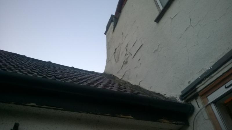

Without going on about stuff i can see in the pics, you should be aware of for example: the ground level step up shown in pic 5, and the roof sand and cement fillet in pic 1. Just saying.
I think the quote is alright but that is irrelevant until you get more of them. Nothing wrong with you getting the scaffold or materials. Better perhaps than the plasterer putting a few quid on top. If you agree on the job, he will probably give you specifics on the materials.
I don't think saying 400 to 500 is that vague in this case. He's giving you a max so you can budget.Different merchants might supply the beads or sand for example at different rates. It might take a few bags of cement more than planned etc . You are in control of the cost, so will know exactly how much. Lots of plasterers allow the customer to buy the material. First, it saves you outlaying on a job for a new customer who might not pay promptly. Second, it shows you are not trying to diddle anyone on marking up material.
I think the breakdown of works is more detailed than most quotes we see here, though I would like the beads to be specified plastic or stainless steel.also who removes the waste/debris? Bear in mind until you start you have no idea of how hard it will be to take off ALL the render, or what will then actually be needed until it is off.

As for the fillet etc it would be more helpful to the OP if you did more than ' just saying' having raised a concern!

we dont know what was offered or discussed - synthetics, or insulation, are commonly offered modern options. Perhaps the OP declined them? Perhaps the OP requested galv beads, or wishes to keep the debris - who knows. Hence, i mentioned a few significant items that might have been missed.
I'm brief regarding remedial items on the pics because it gives the OP the option of following it up if they wish. In a sense, all comments on here are causes for concern to the OP.

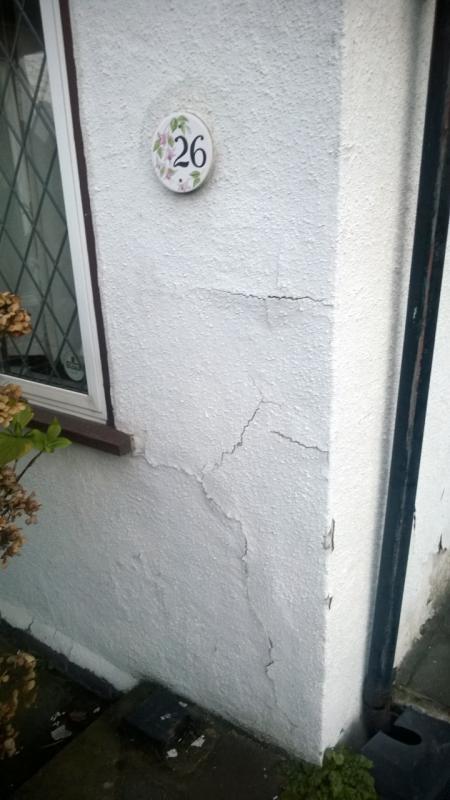

Render has sometimes been applied to older buildings to hide damage, cracks etc. When the old render is knocked off, structural damage, or failing brickwork, might be revealed.
