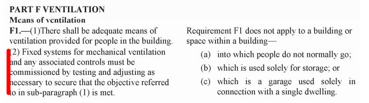

The requirement for those who fit bathroom extractor fans to take courses, and show they know what they are doing.
Who/what imposes such a "requirement" ?
I have installed many bathroom extractor fans in my time, and I know, or know of, countless other people who have done likewise, but I've never heard of anyone "going on a course" to teach them how to do it ;)
You may have missed this thread...
If you were cynical, it may be seen as some are using an interpretation of the Part F guidance, to enable money to be made from training sessions, an increasing number of building control applications and professional registration requirements.
Otherwise, it could be seen as a way to encourage installers to properly design and commision ventilation systems.
And why this has blown up now, after the amendment has been enacted since
June 22, I have no idea!

... and, in turn, I refer another honorable gentleman 9probably several!) to the fact that we have agreed that that is not a 'requirement', merely guidance.
Yes, again agreed.
However, did you read the email response in the other thread, that I had from Envirovent (sorry, it's a poor screen capture from my phone)?
They (and indirectly the NICEIC) are stating that the installation of a single extractor fan is notifiable work.
This is being publicised through the electricians news channels.
This may be difficult to ignore for electricians, and householders who could start asking for the electricians accreditation.
And from their reply, Envirovent aren't backing down on this - even though their reply seems to be based on a specific interpretation of the part F 'guidance', definitions that aren't in the document, and some flimsy quotations from the 'secretary of states intention'.
But what can we actually do?
Envirovent et al, will continue to promote this view (and their courses), do we ask for clarification of part F, or just ignore it as there are no actual requirements?
Are you both thinking that this company and NICEIC are taking advantage of the wording of the regulation and making out that an extractor fan is a 'mechanical ventilation system'?

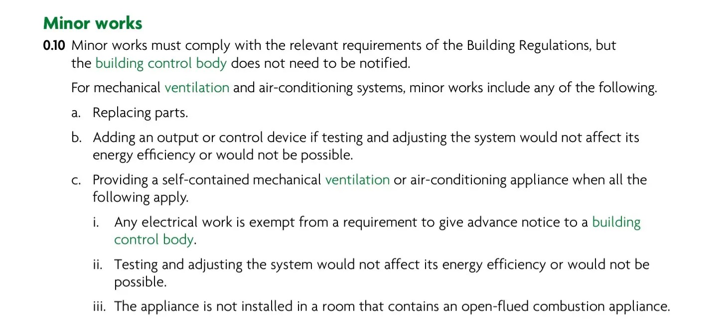

If we ignore the issue that approved document part F is purely 'guidance' - the issue comes down to whether the installation is notifiable.
For it not to be notifiable, It must come under minor works...
I see there is enough wiggle room here to fit an extractor fan, but Envirovent don't.
