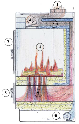

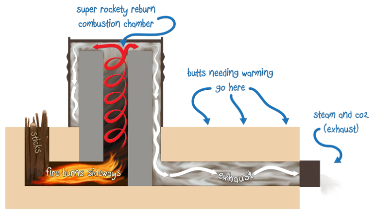

The DIY model rocket-mass-heater-diagram.pngis built with a rock or concrete seat which stores the heat, note near horizontal flue, as it is condensing so water needs to be able to run out, look up rocket wood burner to learn more, not sure what insurance companies would say? Another condensing wood burner here Hughes Condensing Stove 2 small.jpgI looked at it and emailed to find out what safety system there is for a power cut, as it clearly relies on having power to it. I got no answer. But some are not so complex this one wallnoefer.PNGdoes again rely on electric, but it would seem one could at least rake out the fire, and today with solar power and the battery which goes with it I do have an UPS supply. (uninterruptible power supply)
