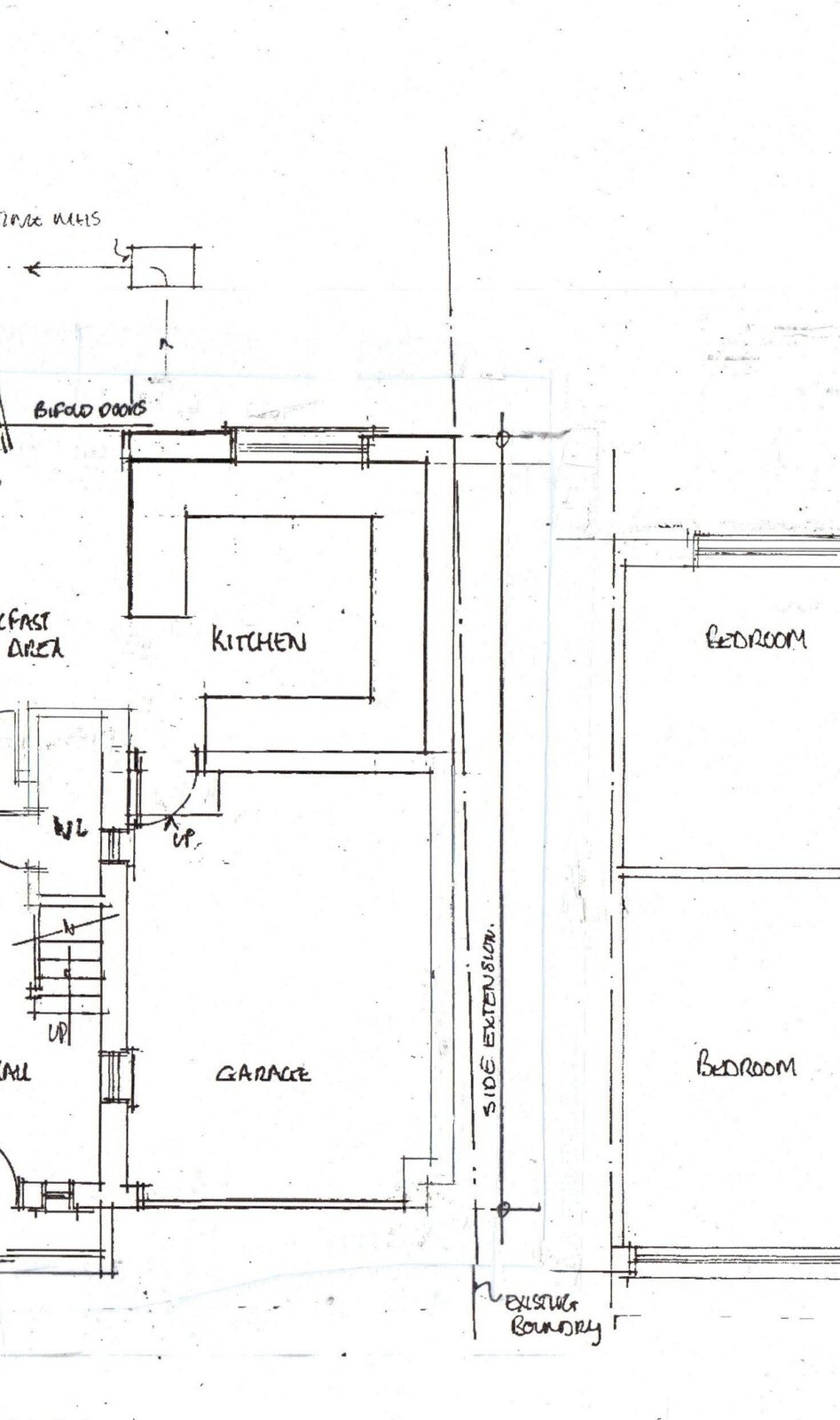

Attached a pic of my architect plans when he came for survey, clearly shows boundary line and that garage wall sits on our side.

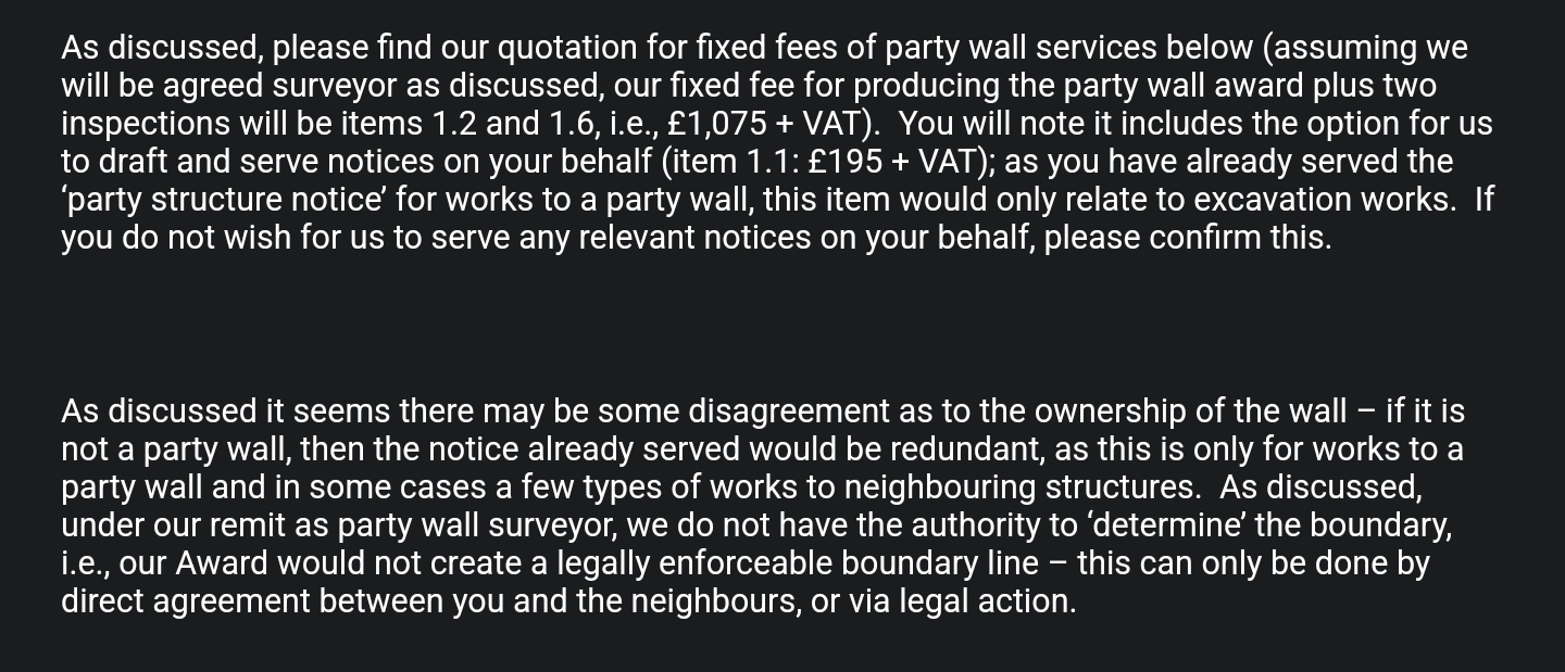

Attached is basically what the agreed surveyor said, they say its redundant, but still want to move forward? Is it not possible that I pay for a site visit and they can determine that themselves and then let the neighbour know, thus putting an end to this matter?

If the latter wouldn't this just cement the 'fact' that the wall is a party wall when of course it isn't?
Well, yes, that confirms exactly what I said. Quite often a wall is dealt with as if it is a party wall when actually it may not be. It just makes it simpler, from a procedural point of view. But, the flip side is that the procedure allows your neighbour to appoint a surveyor, which they obviously want to do. What I am saying is you may be better off swallowing that and following that route and let the surveyors do their work. It will cost you but at least you will get your extension done. If you can agree something with the neighbour that's fine as well, but that doesn't sound likely from what you've said.

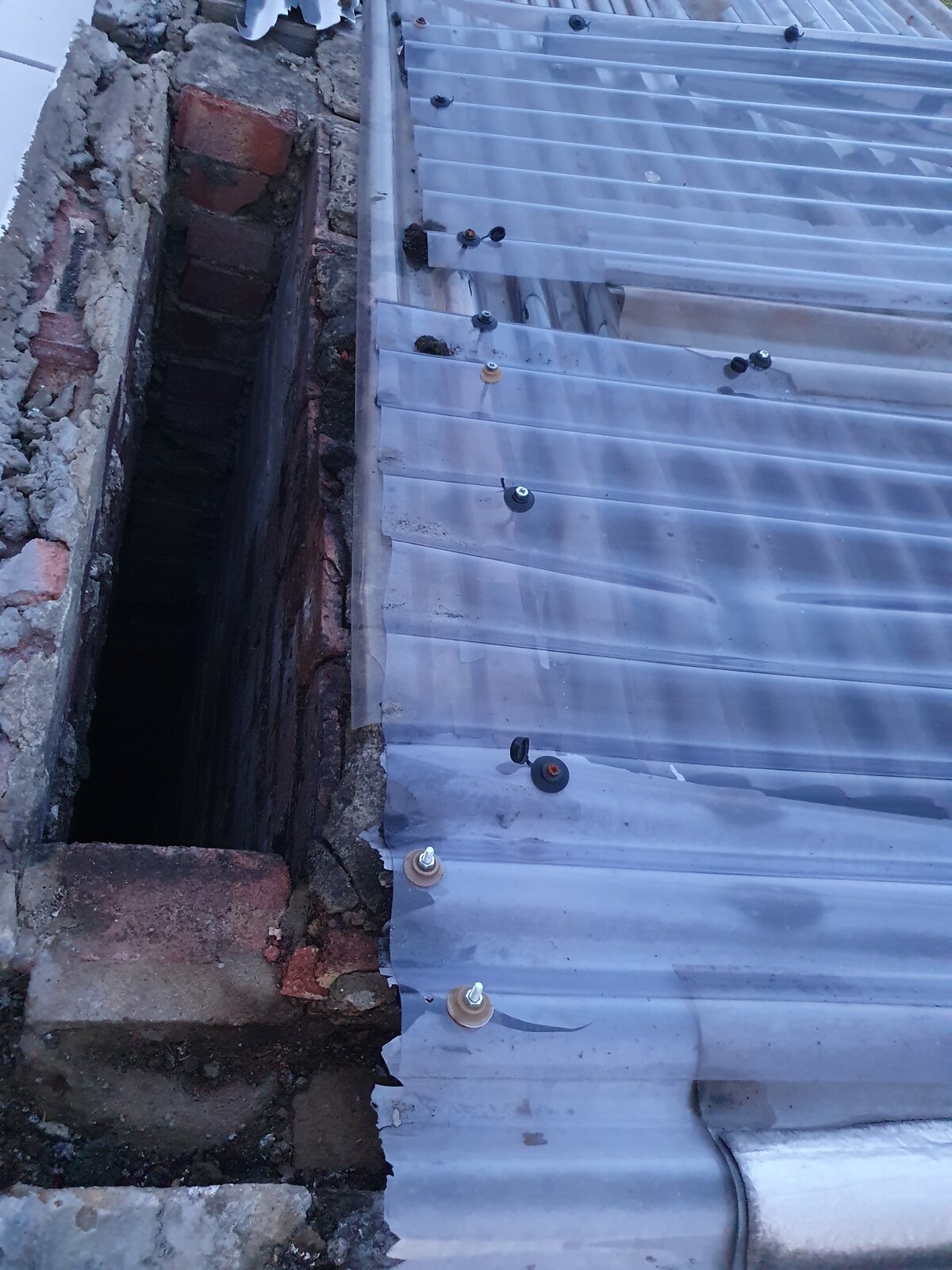

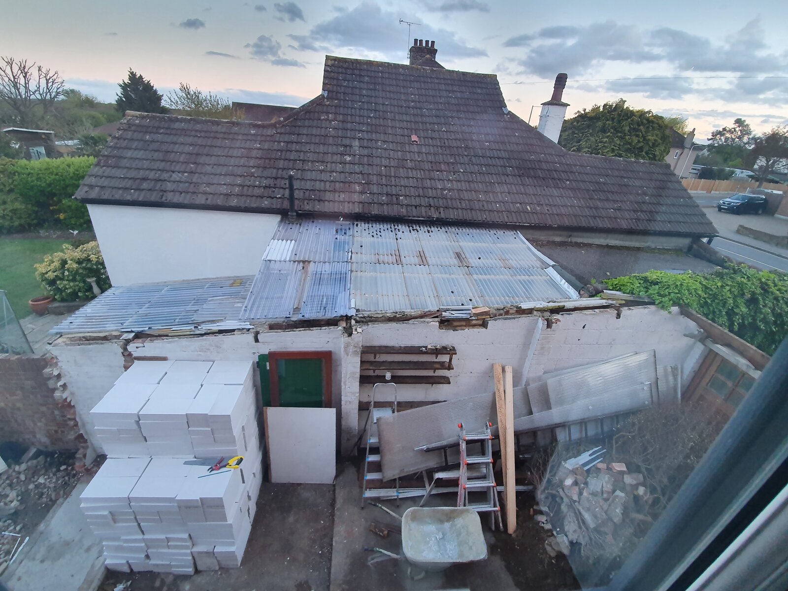

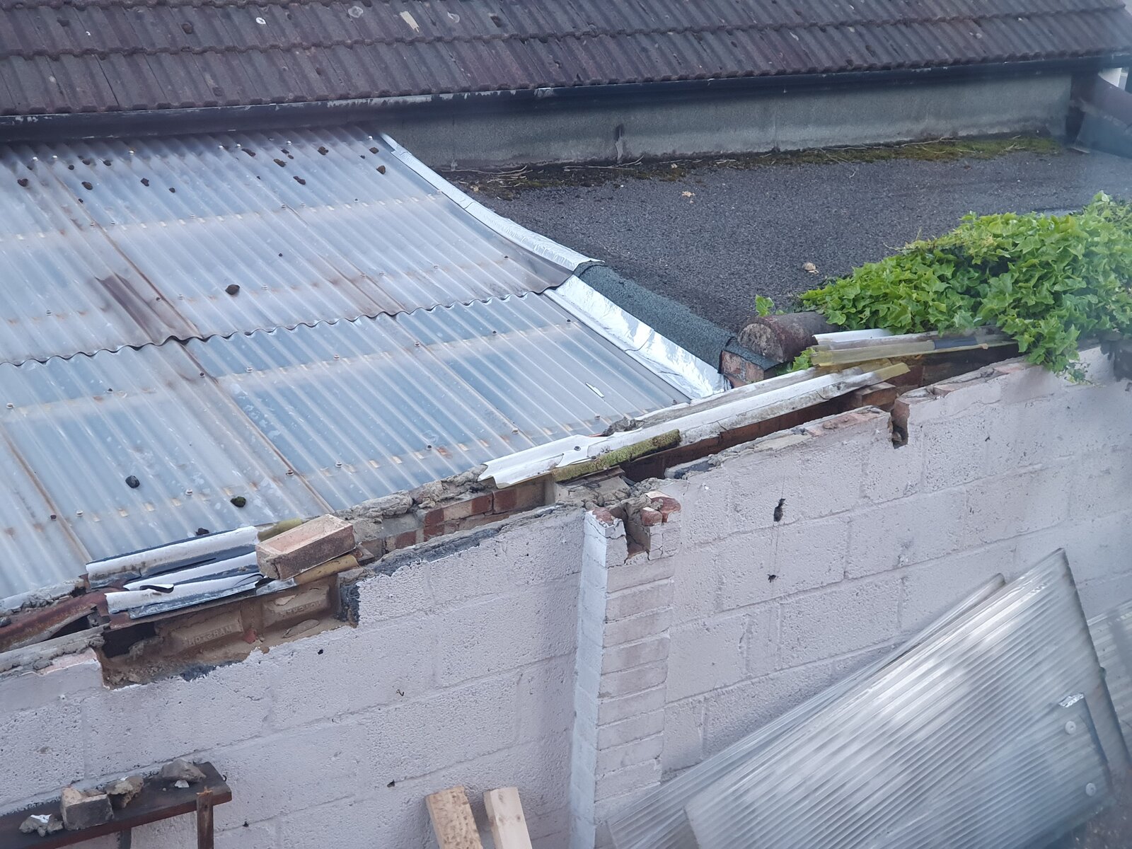

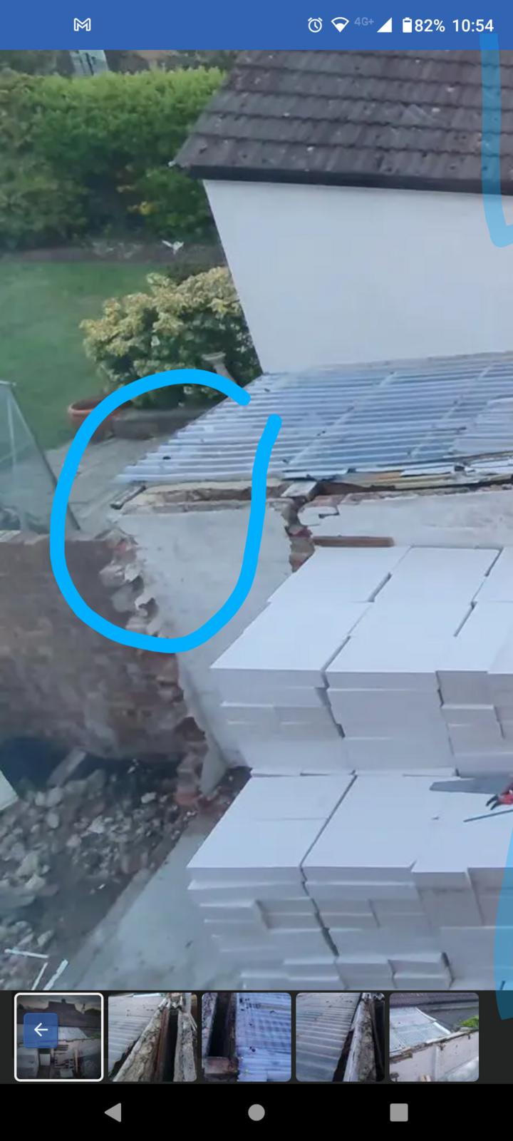

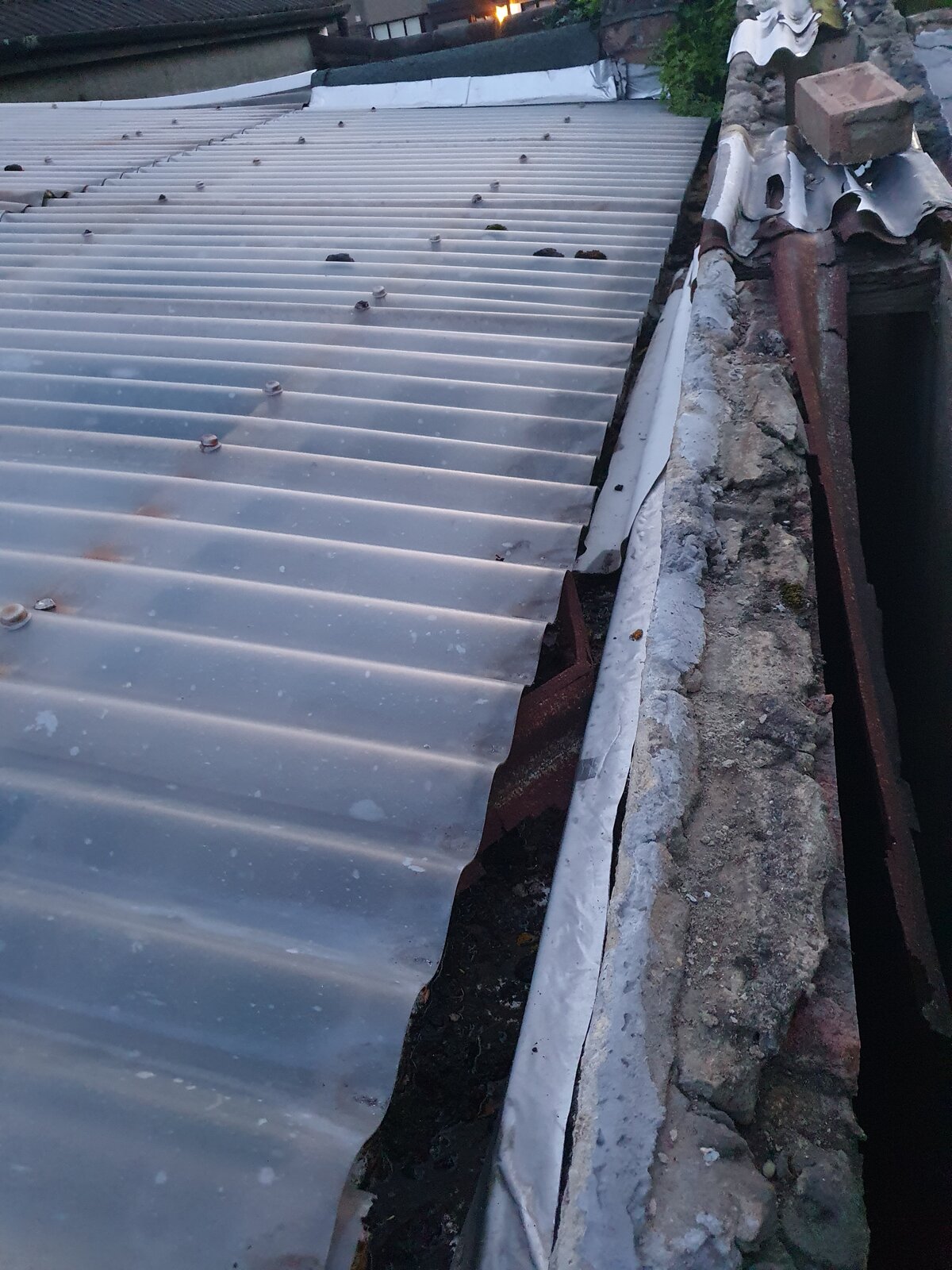

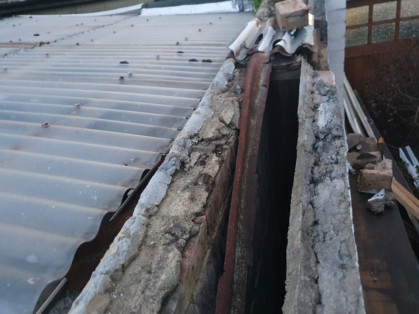

I've attached some pictures of the wall in question. This was when we removed the garage roof. We discovered it was indeed a cavity wall. They were using the outer skin to rest corrugated plastic sheeting to keep rain out. The elevation, slope, bricks used (same as our house), position indicate that it's within our boundary. Its a straight wall. There is a gap between their garage at the front and ours, covered by ivy.

Well it's clearly obvious it's not their wall.
I presume they are worried they will have to remove the 'shack' they've erected against your wall.

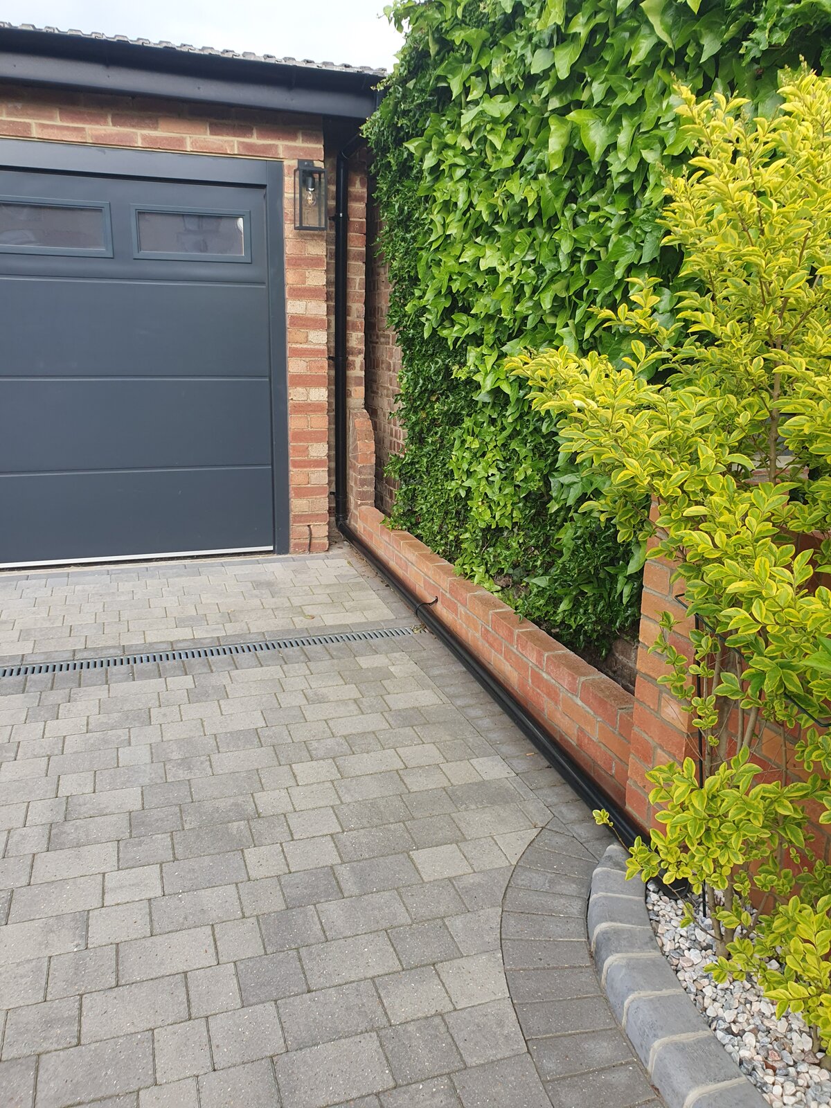

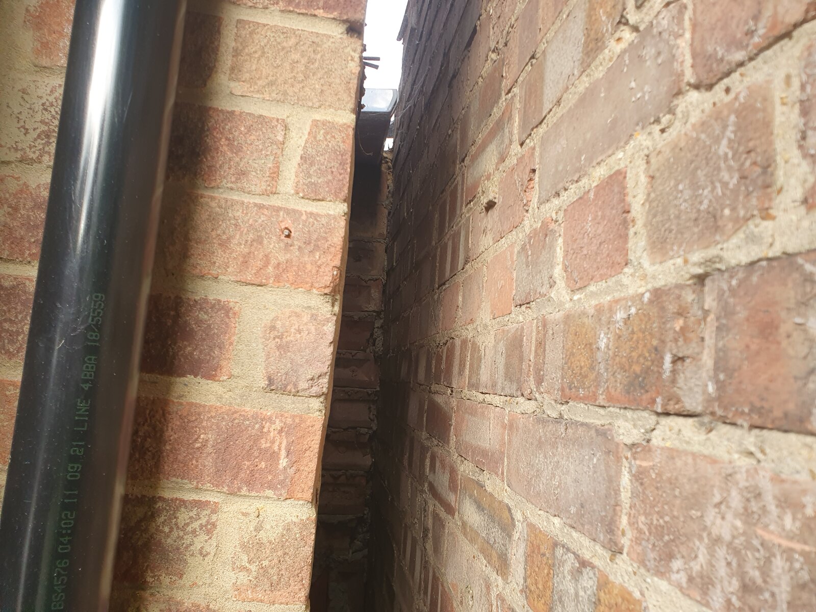

I've let that pass. I've attached some updated pictures from the front. You can see the gap between the garages and then the boundary wall as well for the driveway. They've bricked up the gap from their side and then erected the corrugated plastic sheeting, so turned it in to a lean to area, hence why they think its their wall.
I also spoke to the agreed surveyor and said that their main gripe is with the wall ownership, so I proposed if he would come down and give his impression on whether or not it is a party wall and relay this to the neighbours. They don't want to hear it from me but from an 'authority'. I'll pay for the site visit but if they still object what can they do exactly?

That looks strange to me, if it was built with a cavity wall it wouldn't need piers, almost as if the outer skin has been added at a later date. What was the detail of the front and back walls?
