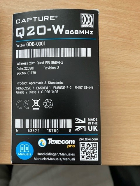

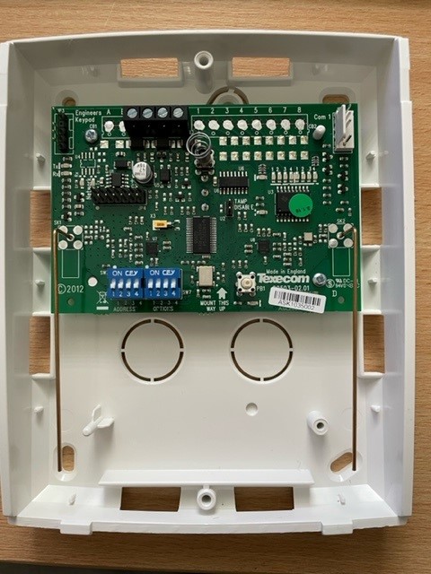

I have purchased a GCD-0001 and a GDB-001 as shown, is there anything else required to get this setup?

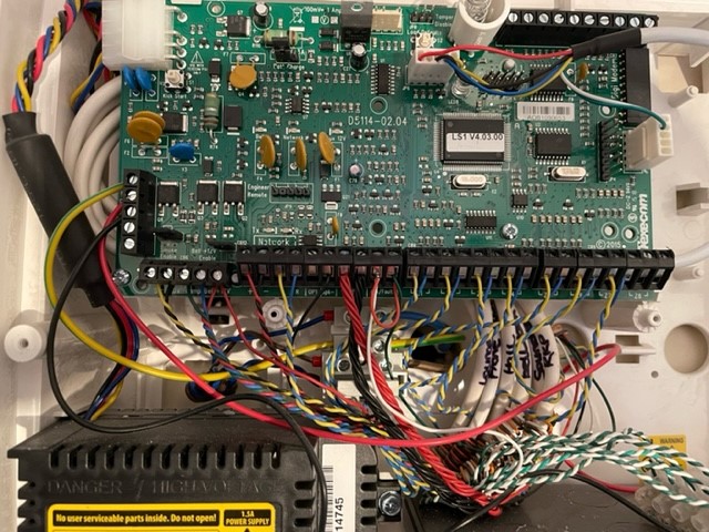

I’m just checking that I have all that’s required with the pics I posted and where on the panel it connects.
I have mounted the GCD and put a cable through to the panel but I’m confused where it connects on the panel.

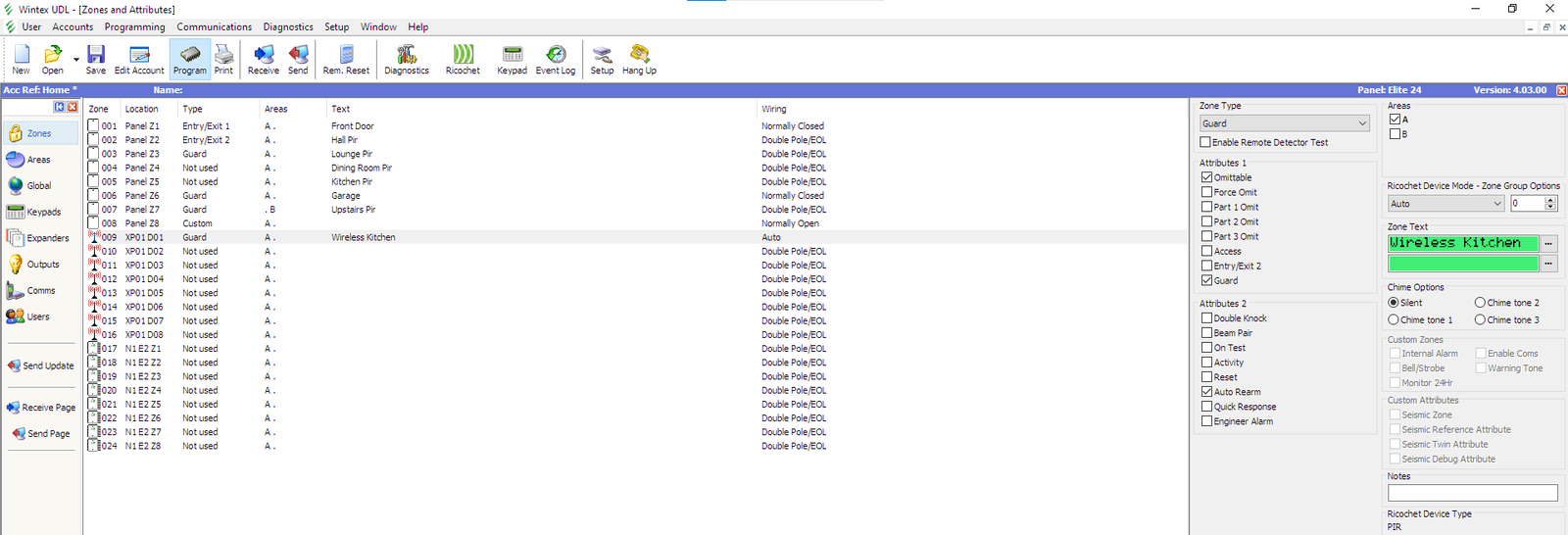

Once it was showing in Wintex I set it up in the correct zone and it's Zone type is guard on zone 9 but it doesn't appear to light up or when armed it won't set the alarm off. I assume I am missing something. If I do a walk test it won't pick it up first unless I walk to another pir and then back to the wireless one and it will then show. I have attached a screen shot from Wintex to see if anyone can spot where I have messed up.
Thanks!

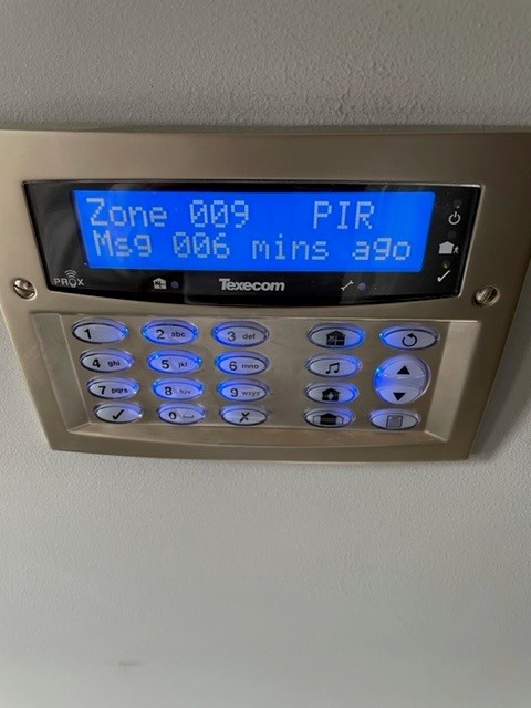

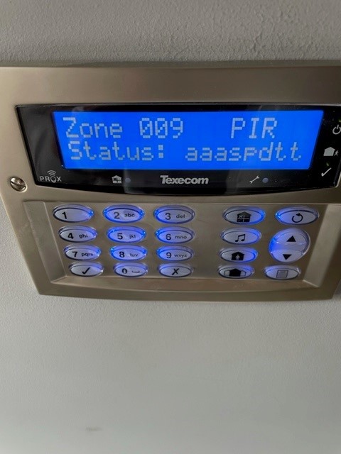

Wireless PIR's only light up in walk test.
Wireless PIR's sleep for 3 mins after activation, so if you have just walked past before setting the alarm it wont go off.
Wireless devices have a slight lag between being activated and the panel responding.
The most important thing is signal strength, there is no mesh as there is only 1 device.

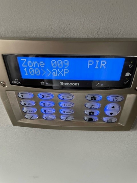

Engineer utilities>ricochet diagnostics> set zone to 9, pressing Chime will take you through the values for that wireless device.

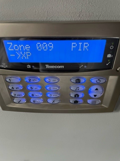

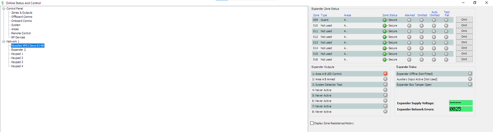

So I have set the alarm from the app and sat in the kitchen and waited over five mins and I move and it just doesn't pick anything up or set of the alarm. I have done another walk test and it does just light up as you say but it doesn't seem to pick up motion like the wired ones but not sure if it should?
I have attached the status from Diag.
Thank you!

I don't understand what you mean by
"just light up" and "doesn't seem to pick up motion like the wired ones"
