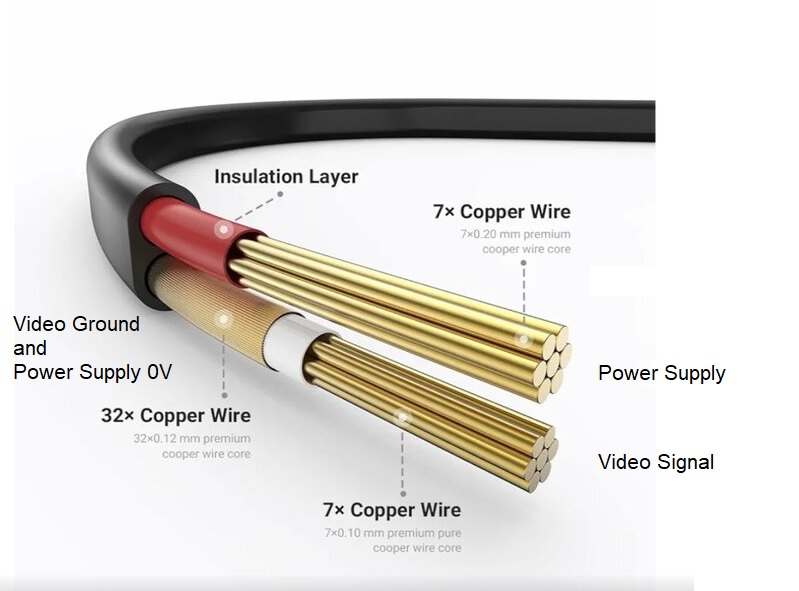

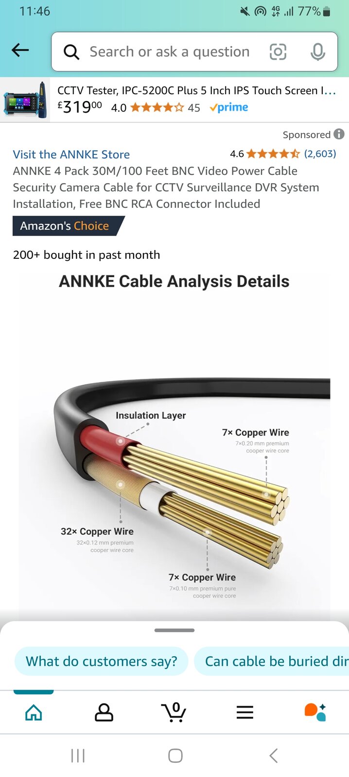

Here's inside the cable
That's what I thought.
It appears that you have cut through the power supply and coax cable.

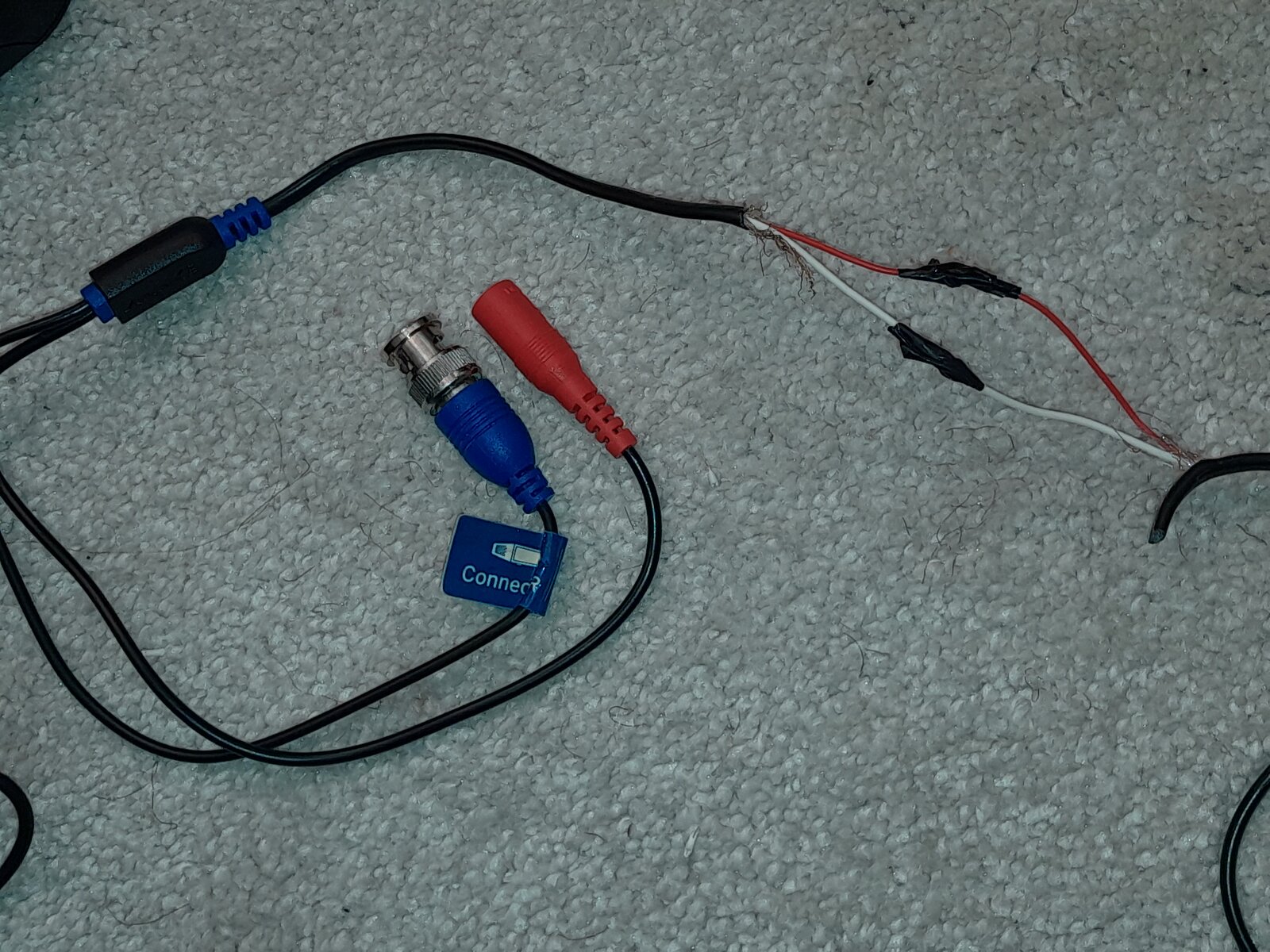

If u look carefully u can see the outer copper bit there as well. Which in this pic I haven't joined together... but that is very 'flakey' ie falls off easily.
It's either this the problem or i think i have nicked a cable outside when I was clipping against the wall.
Theoretically if I was to join the copper together and tape it. Would that be OK?
Then I should look outside if there's issues with the cable?

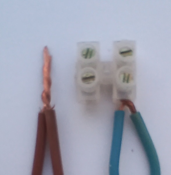

Try connecting them together in a terminal block, something like...
In the photo, I see a screening wire, which in your photo remains unconnected, one end to the other, which will certainly prevent it working.
Ideally, you should connect those wires, by soldering the joints, then use some heat shrink tube over the top. Second-best way, is to use connectors, but remember you must also join the screen/ the outer copper fine wires too.
