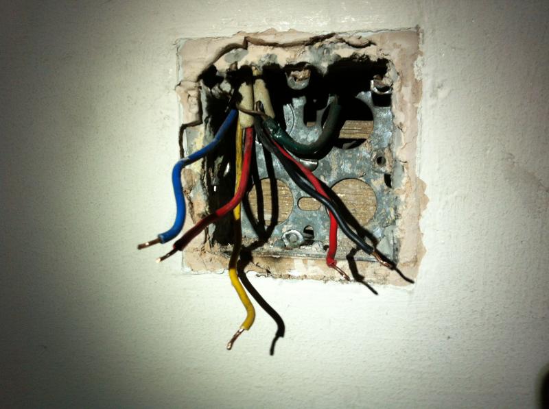

I've got 46 volts between black wire and earth
well tell me in plain english. I went to change a switch which isn't unreasonable. I phoned an electrician too who in his own words 'talked himself out a job' by telling me to simply copy the original layout even though I explained the voltages didn't seem right. I've come on to ask advice as it didn't seem right even though the light works.

Post a pic of the switch wiring.
Does the metal back box have an earth wire?
there are 2 cables. One has red, black and earth. The other has red, blue, yellow and earth and links to the 2nd switch. Yes the earths at both switches are attached to metal back box.

here. Yes I first noticed the neon light up which is why I started checking with a voltmeter. I got the stated voltages when I checked between black and earth and red and earth on the incoming cable.
sorry hard to get pic on iphone there are some shadows in above pic
Was your meter Set to ac or dc
There is no neutral at the switch.
I think I'm beginning to agree with your electrician but if the metal is live then its not right.
with switch connected and light on I get:
between yellow / ground 33v
between reds / ground 33v
between blue&black / ground 33v
with light off I get
between yellow / ground 89v
between red / ground 89v
between blue&black / ground 65v
perhaps there is no problem but can someone tell me how to check 100%the earth is not live as mow I'm worried.
edit sorry I wrote it wrong
red and yellow together, black and blue together, link cable red on its own.
