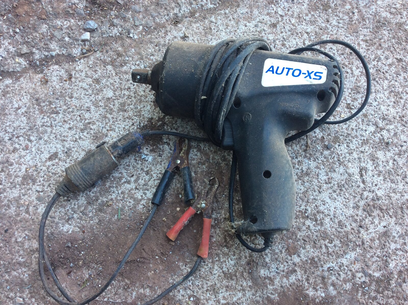

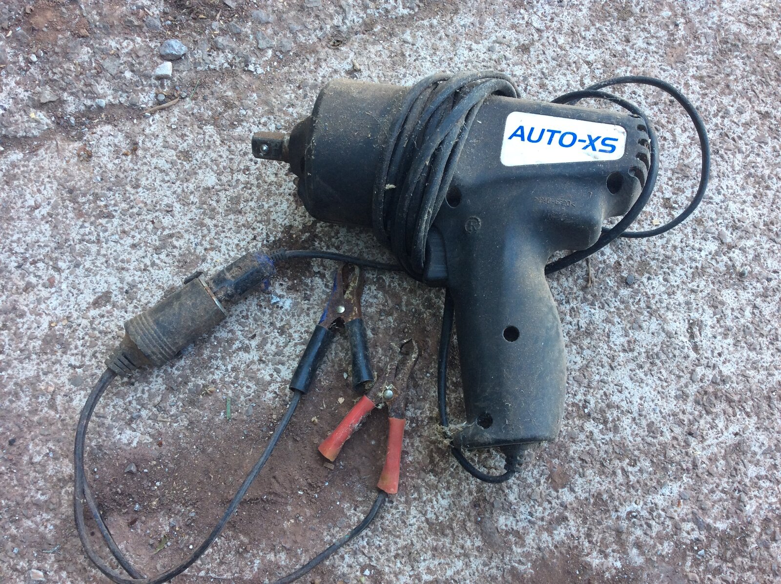

Your best bet is to look on youtube for the cheapies reviews, In the past ive used one of the cheap wheel nut wrench to 12v lead to car lighter socket it was great cracking them off
