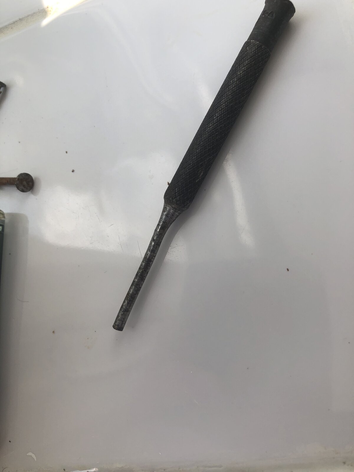

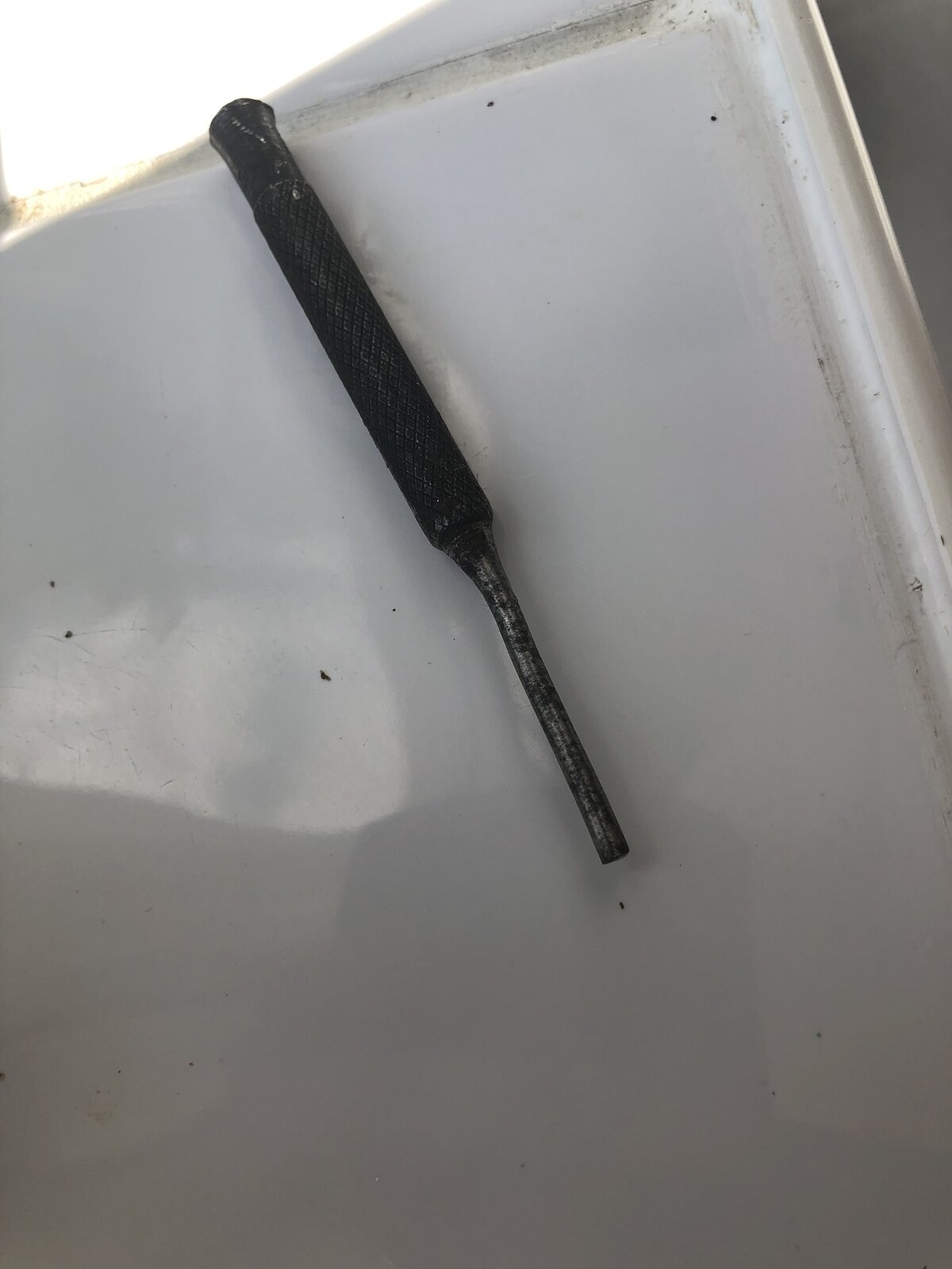

I went and brought some bolt cutters, and a new solid heavy crowbar, and this is my new plan that seems to be working… but have questions.
I am prying a gap in the pallets, cutting the nails where it won’t pry apart fully. I am then knocking the nails through using nail punches.

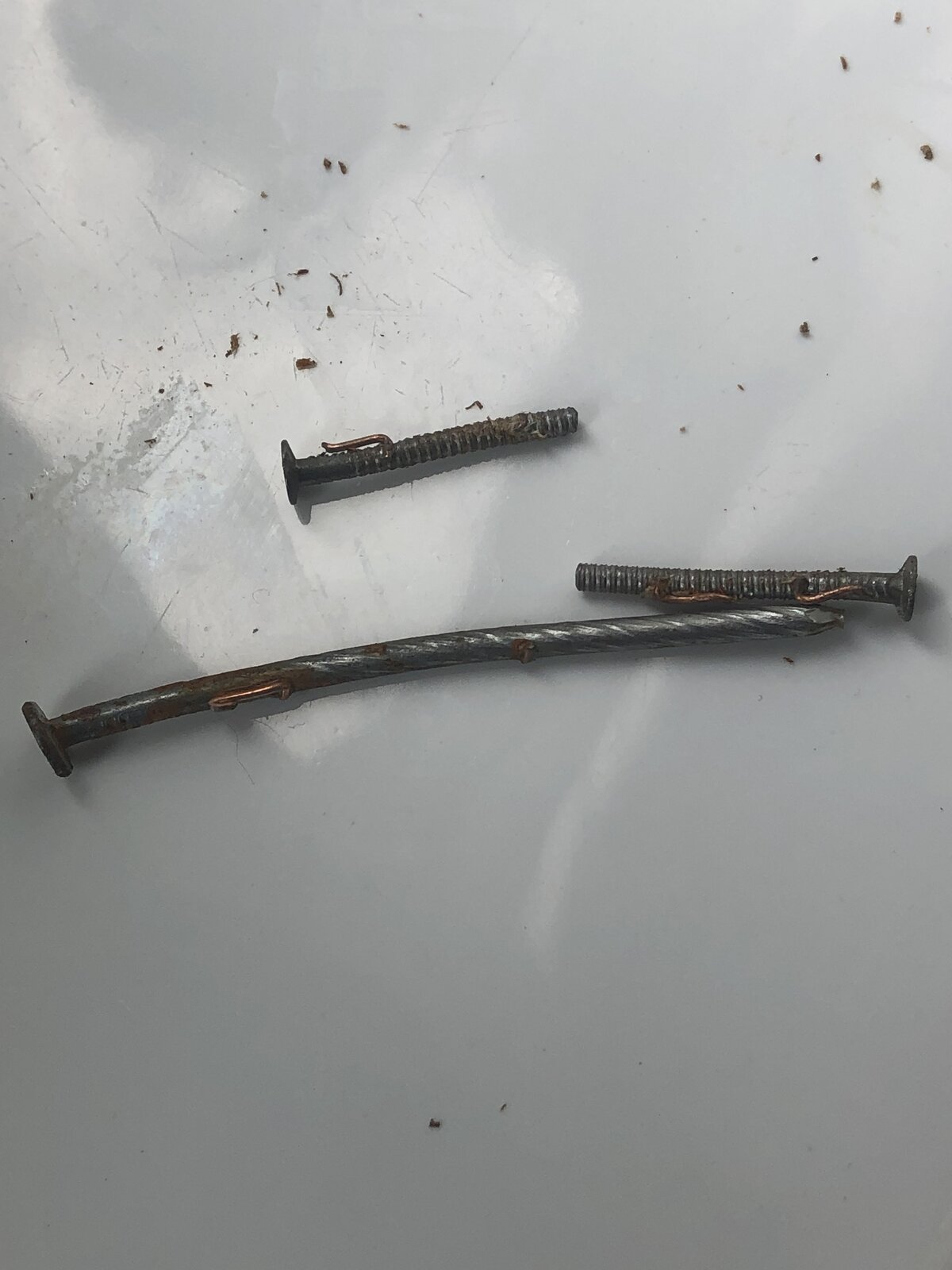

Why would nails have some sort of copper wrapped around the nails?
Could I bang the nail punch back straight, heat it up so it’s glowing hot and clench it to reharden and make them usable once more?

that nail punch is for panel pins with heads around the small end size [around 2-3mm]just to knock the head below the surface for filling before painting
I'm quite surprised its only bent as much as i has.
the nails will have been fired in with a nailing gun, i guess the copper will have held the nails together in a cartridge that loads into the gun.

They are wire nails, the copper help prevent them coming loose. Don’t know why you struggle ! Takes 15mins to dismantle an average pallet.
