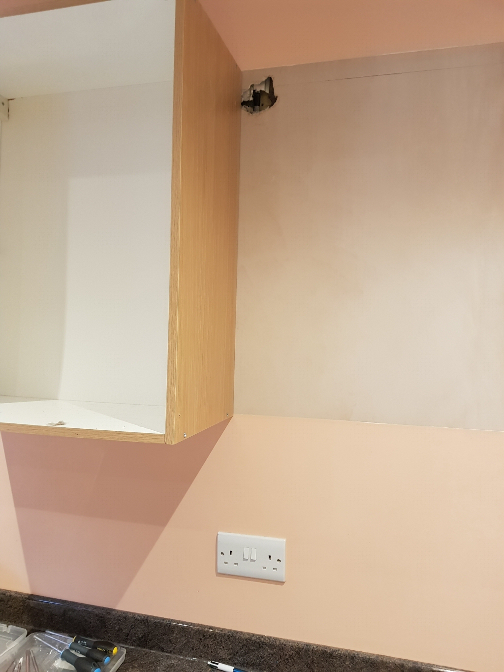

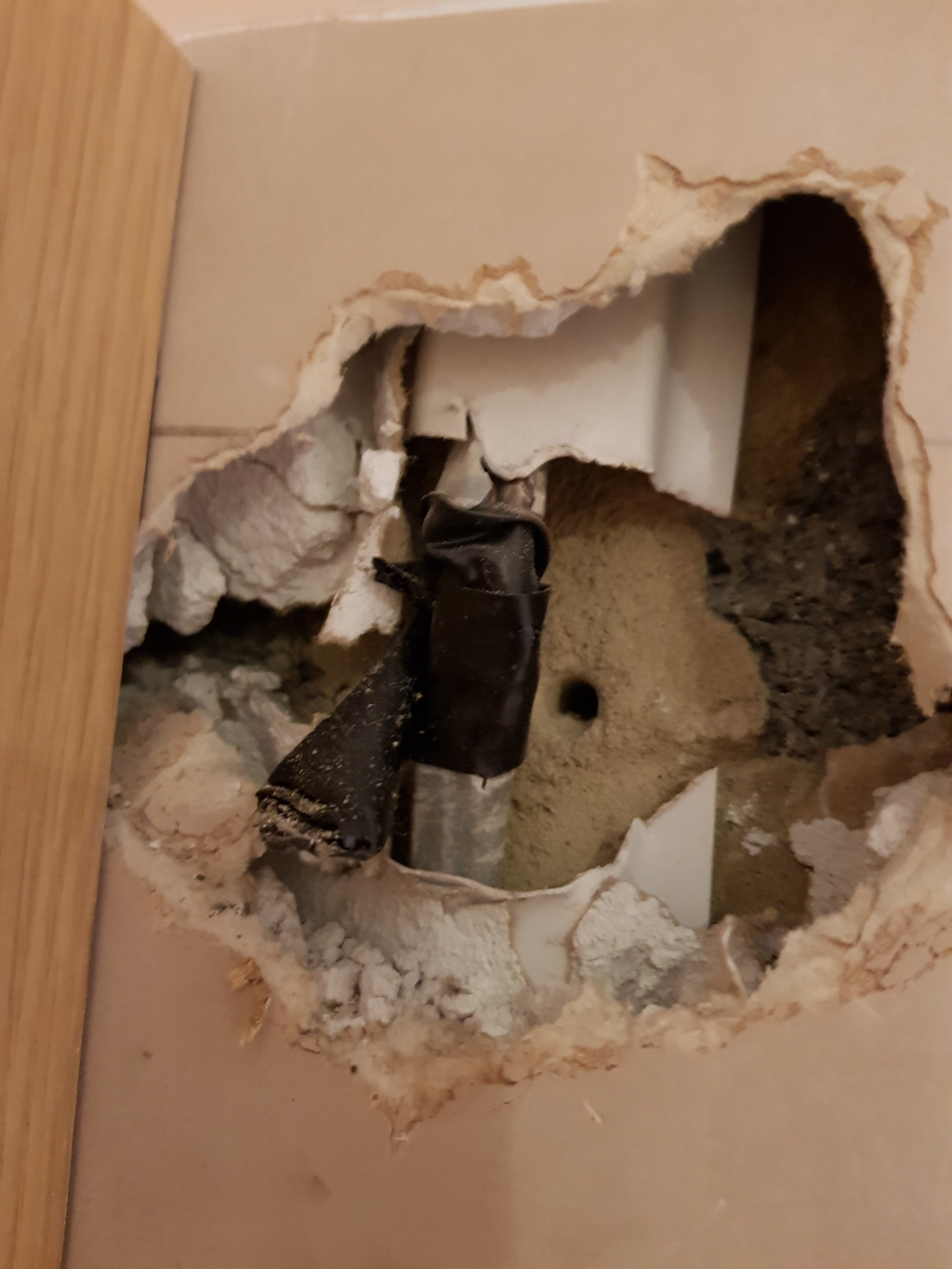

I've bitten the bullet and removed the wall unit, attached are two pics:
Not good is it?
I would like to next test for continuity. I have a multi meter and have asked in previous posts about how to do this. My plan is to remove a socket cover and test this way rather than at the consumer unit. But do I need to turn all the power off to the house or just the circuit in question.
Thanks,
Bob
So how to repair this?
I done some research and come up with.
1) Replace the damaged cable completely, so will need to find the other end of the cable. Thing is directly above are a sink and shower so access from above is impossible. Also above the ceiling are water and CH pipes, very reluctant to start cutting the ceiling plasterboard with a knife. Also thinking about it this may be the first socket from the CU.
2) Get an electrician to crimp and sleeve it, but after reading about this on DIYnot, doesn't this become a weak spot that could fail in the future?
3) Use a junction box placed above the wall unit and on the OUTSIDE of the plasterboard, then I just need to replace the cable down into the socket. A junction box like this should be classed as accessible should it not? Ugly maybe, but surely safe?
Or something else?
Bob
As it's plasterboard over blocks:
Single 25mm depth metal box recessed in the wall above the cupboard
Pull old cable up and into that box - cut away damaged piece
Pull new cable from that box to the socket below
Join cables in the box using connectors
Fit blank plate over the box.
Should not be visible from ground level once the cupboard is refitted.
Great, many thanks
I would use a flex outlet plate rather than connectors and blank plate, the connections are more robust
