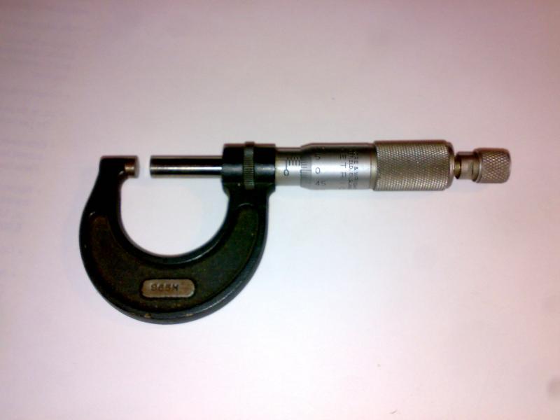

Maybe you should have bought one of these off ebay:
Then you could have accurately measured the strands, and worked out the csa of the cable.
Edit: Is that better RF.
