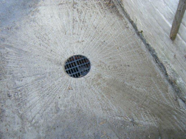

Hi, just a quick post to say thanks for everyone's help.
It was the nastiest, toughest and most horrible job I've ever had to do, and I hope I never have to do another like it :cry: Got it done in the end though, with much help from my dad mixing and shifting concrete.
The pipe was easy to cut with a hand saw, and I used some stubs of pvc pipe with rubber collars to make the join.
