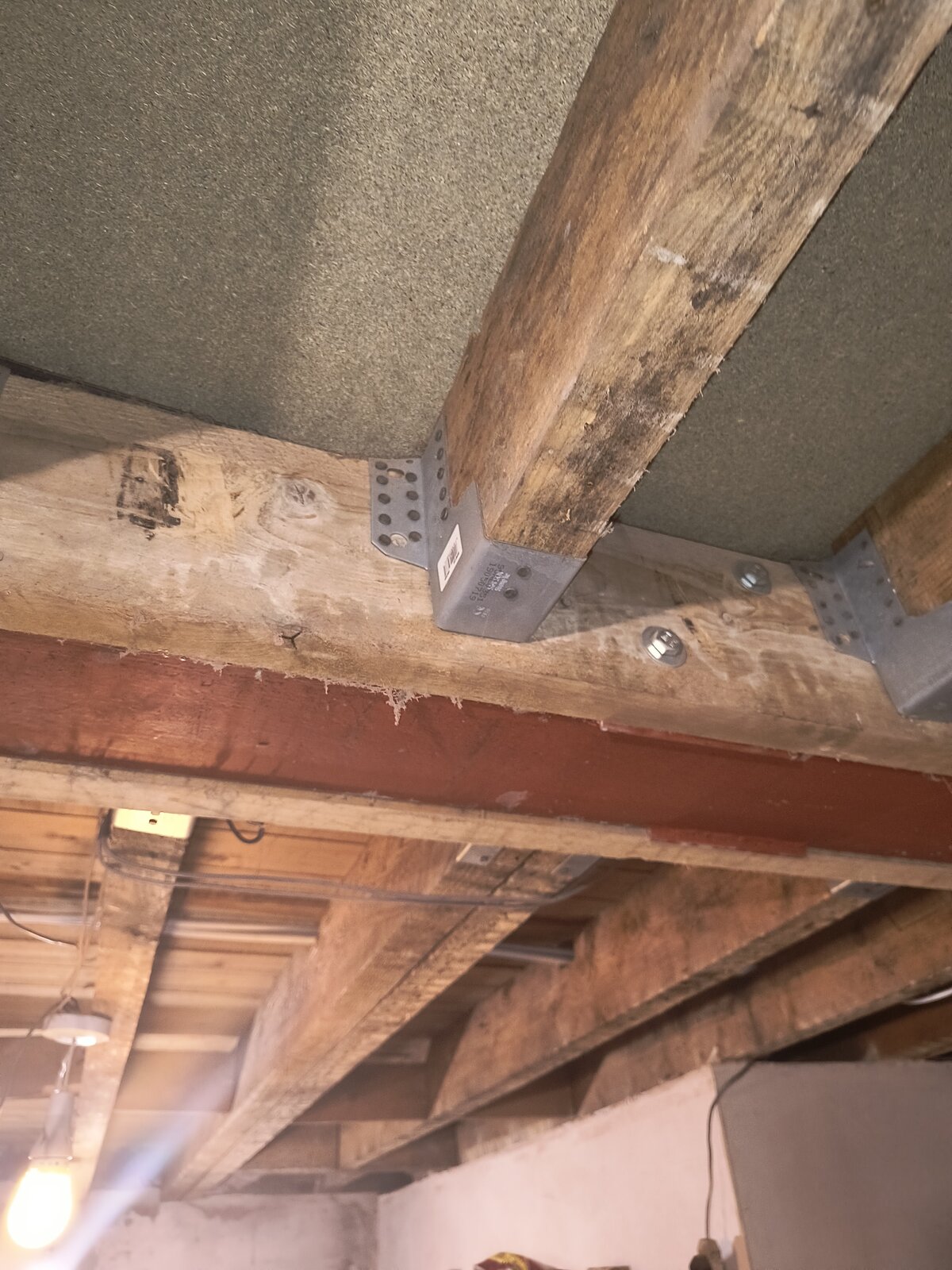

My parents house, loft conversion done in the 1970s by a respected local builder, hangers nailed with 3 x galvanised plasterboard nails (before they invented fancy plasterboard screws) per hanger - still standing and us kids gave it plenty of punishment over the years.
I was quite amazed when I pulled up the floor, but I had bigger fish to fry so just left them alone.
However, it's fairly basic to use those fat twist nails these days so I'd question where else he's cut corners.

Great, wasn't really advice, just general reassurance that they'd probably be ok - you'd get plenty of warning of a problem before catastrophic failure.
This is how I do mine:

Yeah I don't think it's 'unsafe' necessarily but because spax screws don't have a rated shear capacity the connection has an unknown load capacity.
If you do want reassurance you could add some skew nails at the joist ends
