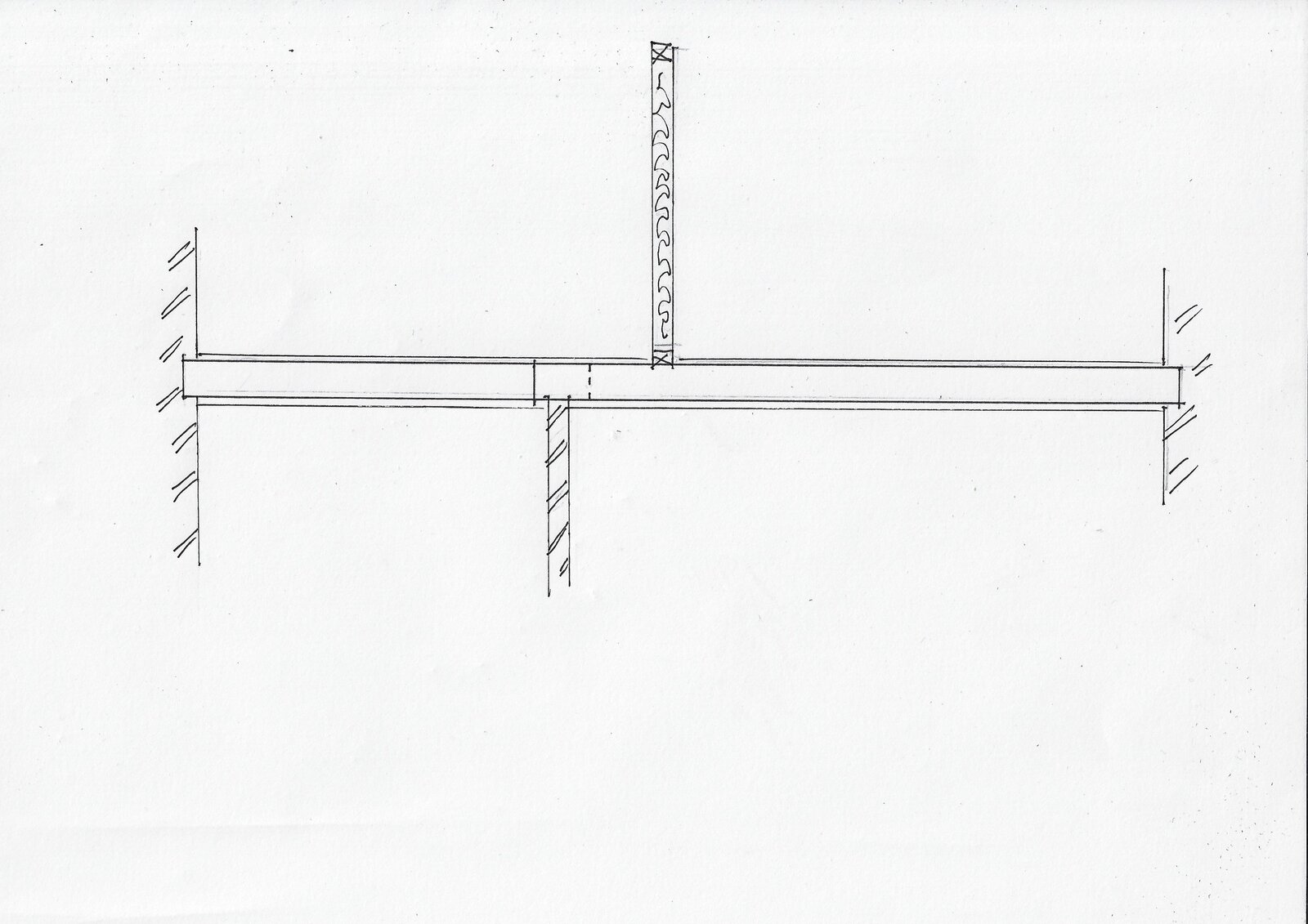

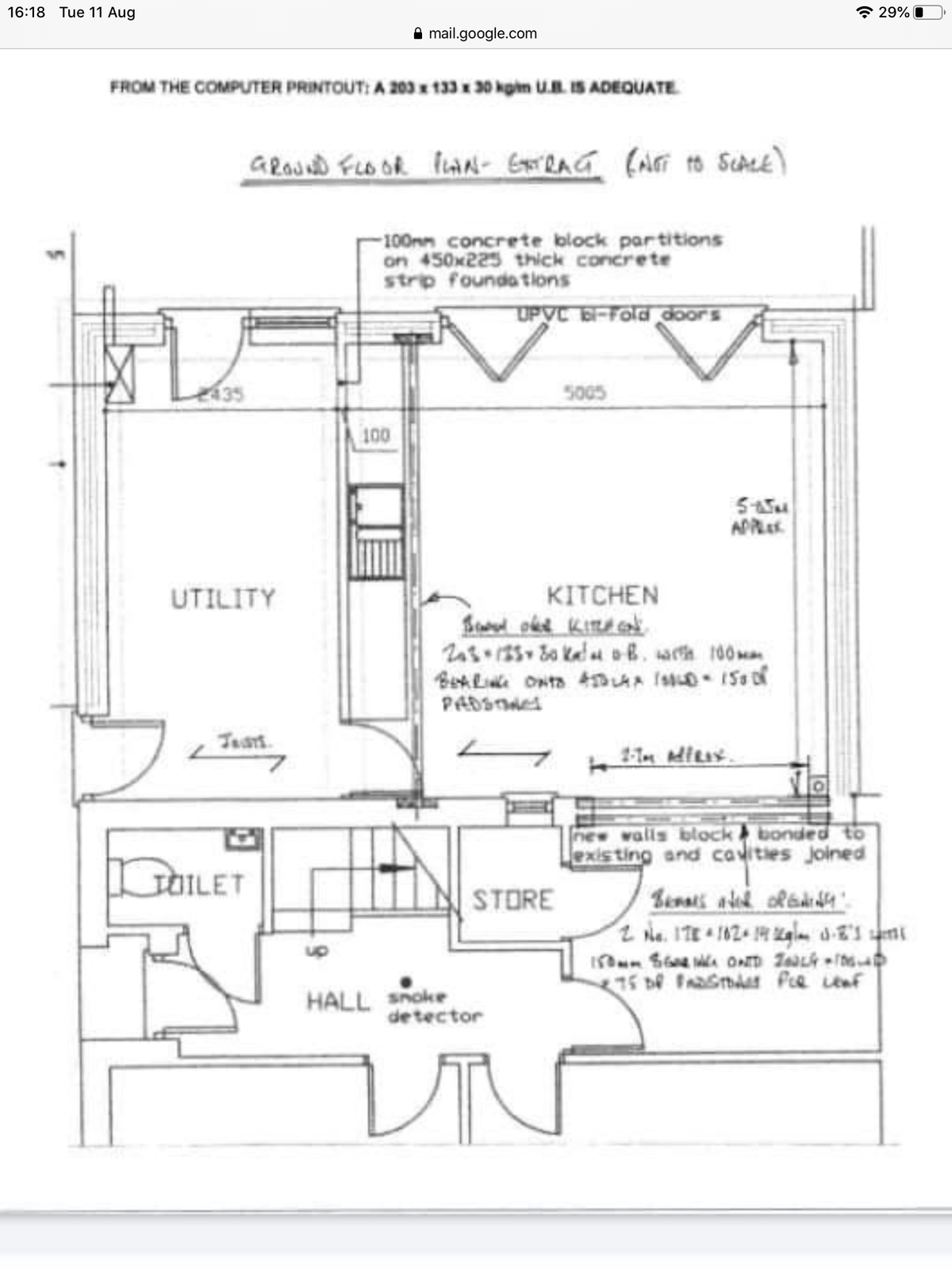

Hi everyone,
I’m building an extension which has a 5 meter span which on the plan shows a ub at 4.2m at the 5 meter mark there is a load bearing wall after which there is a 2.5 m spam to the cavity wall.
On the first floor I will have a stud wall which will make two rooms of equal size which would span over the joists attached to the ub, soooo my question is if I could use 75 x 225 joists to span the 5m floor length and use same joist but 3.6m over the 2.5 meter span and then bolt them together where they meet each other so I can do away with the steel ub and still be okay for the stud wall above them.
I hope it makes sense and greatfull for any help.
He said similar to what I’ve asked but when I got my beam calcs he left out about the joists maybe as he didn’t allow for the stud wall on the first floor.
After msg to him he began to ask for another £175 to do the calcs for this which I said should have been in the original calcs, I’m not tight but I thought I would come here and ask as there are lads with years of experience who could advise me, thanks for your help mate , if I don’t get any advise I will send him my bank card.

Here u go woody, better explanation in the pic

Perfectly feasible to span joists 5m on to the load-bearing wall, and support the partition upstairs off the joists; no need for a UB.
Thanks Tony that’s what I thought just not sure about the partition upstairs,
I thought that if I ran the joists over the smaller span and over lapped and bolted them to the longer joists then it would add to the rigidity and result in a stiffer floor.

No need to do that.
Just overlap the joists on the blockwork wall - no need to bolt them together.
The joists will be OK to support the partition because you are fairly near the bearing - you run a 4x2 timber plate across the tops of the joists and build the partition off that.
I'm surprised your SE specified a steel beam when the joists can serve the same function. If he is competent it is not difficult to prove the joists would be OK.

That was the issue , he said it would be ok to use the joists on the load bearing wall then sent calcs for the steel ub, when questioned needed more for the joist calcs
