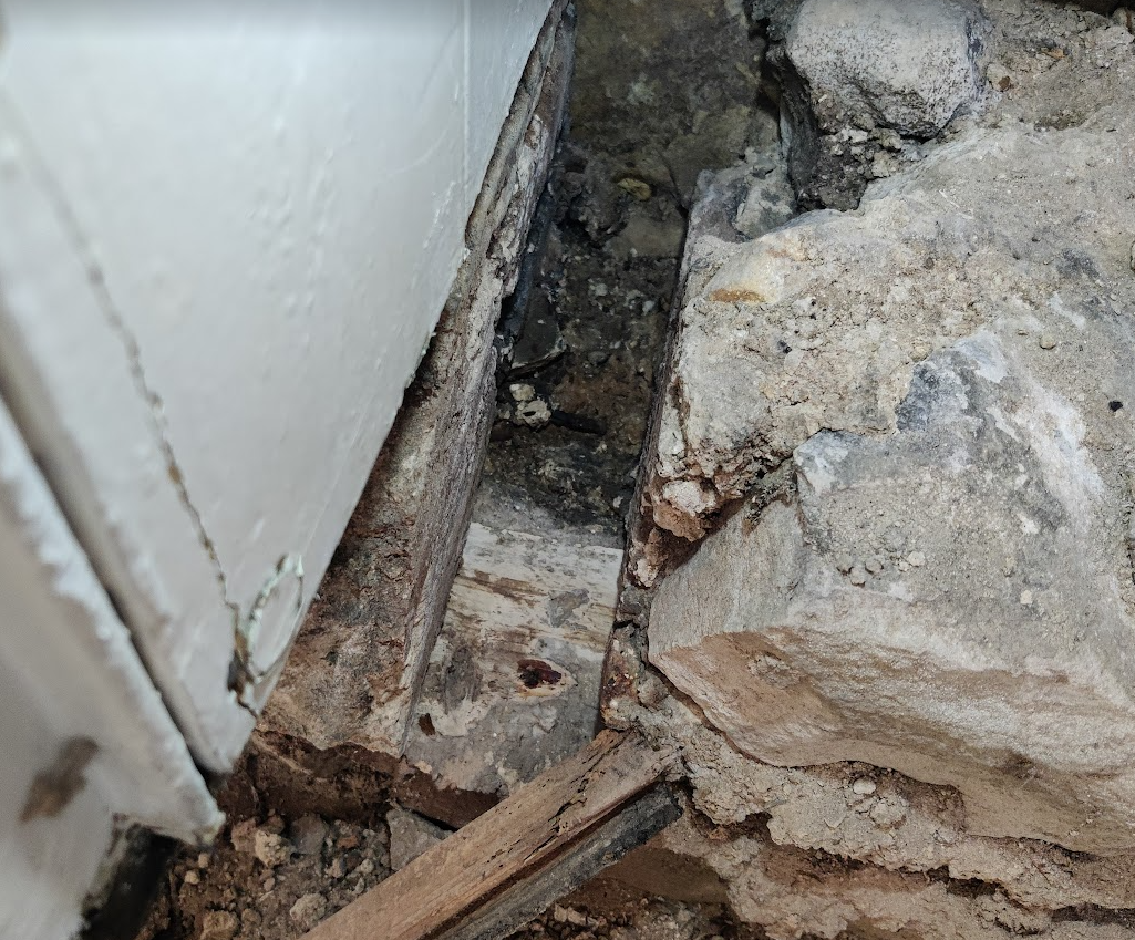

6. The last two pics show dry rot - remove bricks & mortar either side of the pocket, and clean out and soak with fungicide - do this with any suspect pockets.

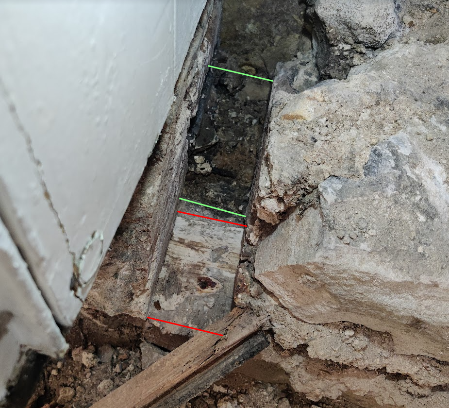

1. Ah apologies, have done that now and pics below.
2. Why demolish the humped wall vs leave it and put damp proof course under joists?
3. The room centred plate is a carrier beam - see pics below.
4. Yes definitely - spent the last 2 weeks doing that and nearly complete. By a/b's - is that air bricks? If so do you mean to outside? I'm confident that the solum will be well vented by the end of this.

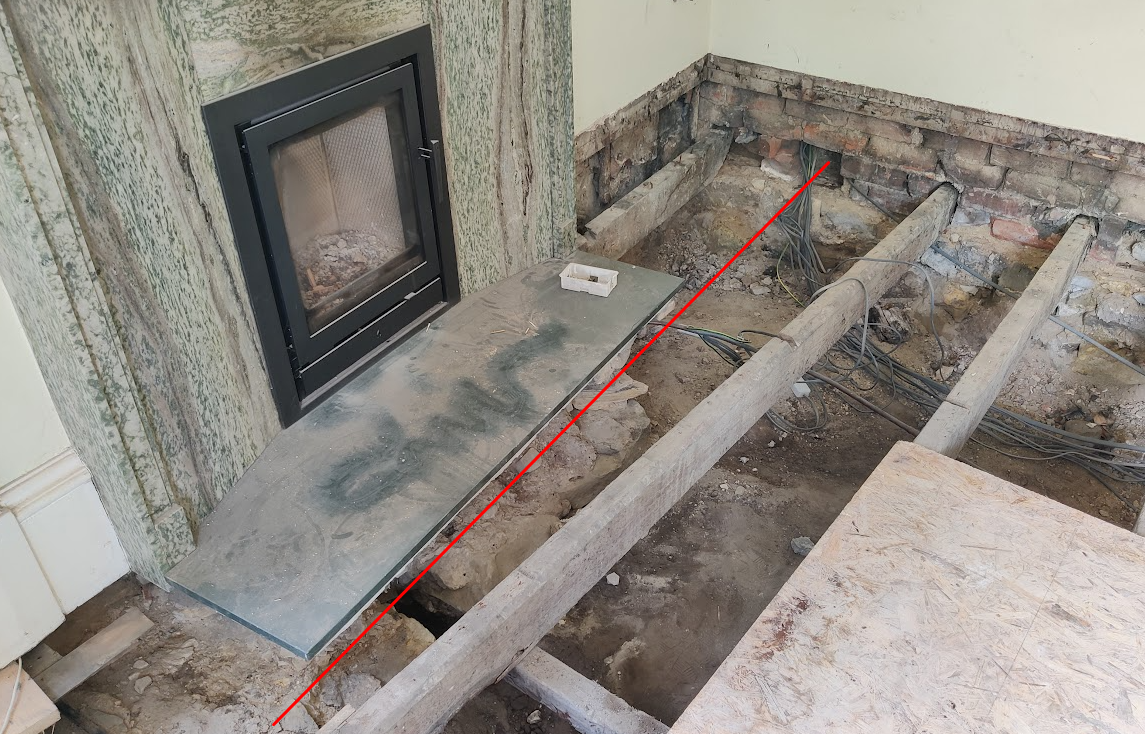

5. It's sitting on large sandstone blocks, then loose debris which is sort of solid but breaks apart very easily, then what looks like a top lump of cement - probably dumped down from above when the new hearth was fitted. There was a joist there running under the front lip of it so my intention was to replace that and ensure the underside of the hearth is properly supported by the new joist.
6. I haven't noticed any but will keep a look out and treat as a precaution.
7. Yes that's what the skirting was attached to. It's attached to the lath/wall behind it and seems the only purpose is to support the skirting.
8. Got it, thanks.

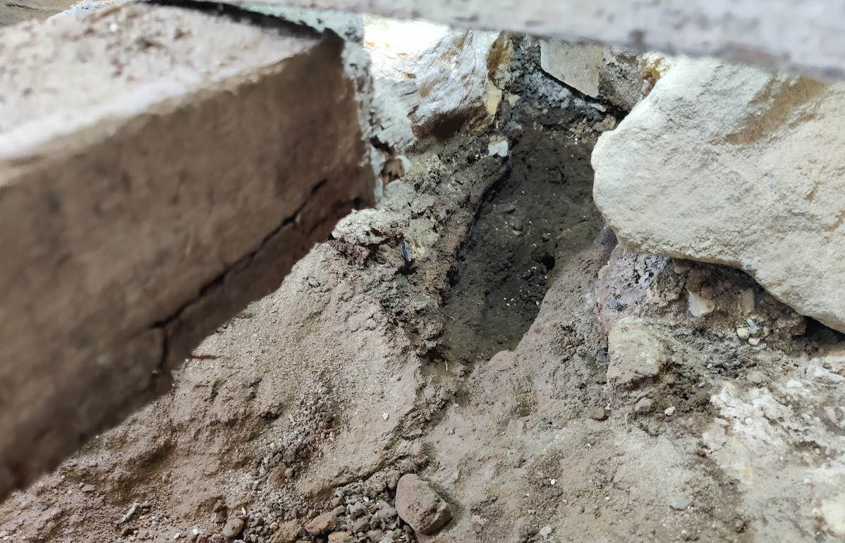

Approx location of where new joist will sit under hearth. There was one there very rotten and it was very badly repaired. Think originally it would've spanned the room.
Underneath hearth. Earth then big sandstone rocks, then loose rubble then cement.

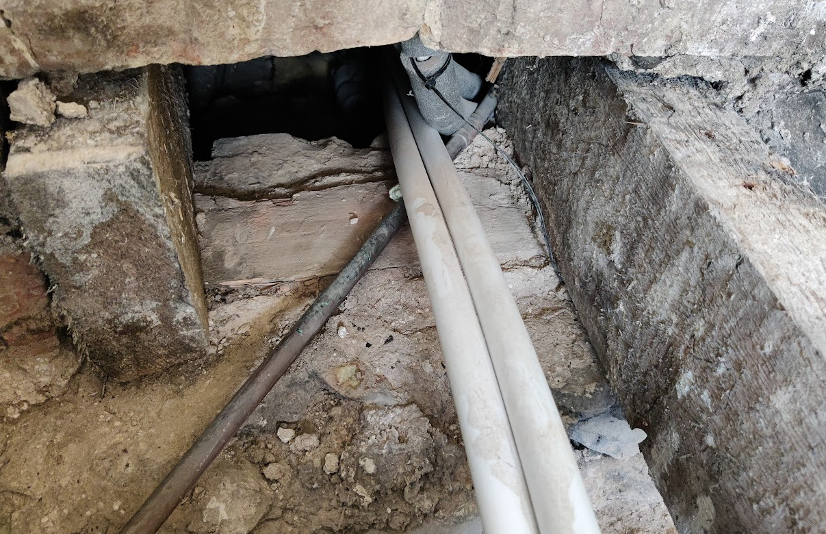

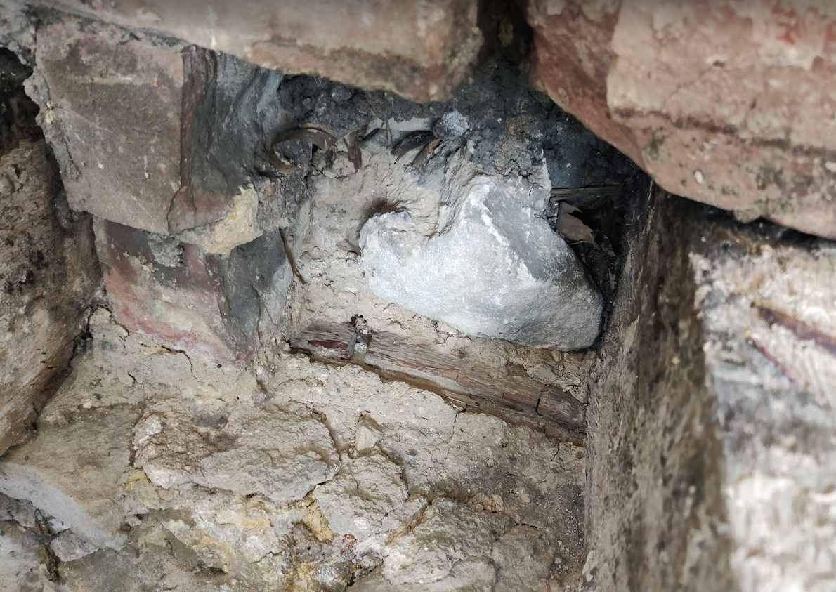

Close up of the wall plate embedded inside the internal wall. Seems the wall is brick, loose rubble in the middle then another brick. The wooden wall plate is in the centre so the bricks seem to be supported either side of it. This gives me confidence it's not as structurally integral as I worried it might be.
Alternate photo showing the bricks being wider than the wall plate
On the external wall the wall plate was right at the front on the stone. Again the external wall seems to be stone on the inside and outside, and looser rubble/stones in the middle. The joist was on the wall plate on the internal stone (red lines) then looser rubble behind (green lines).

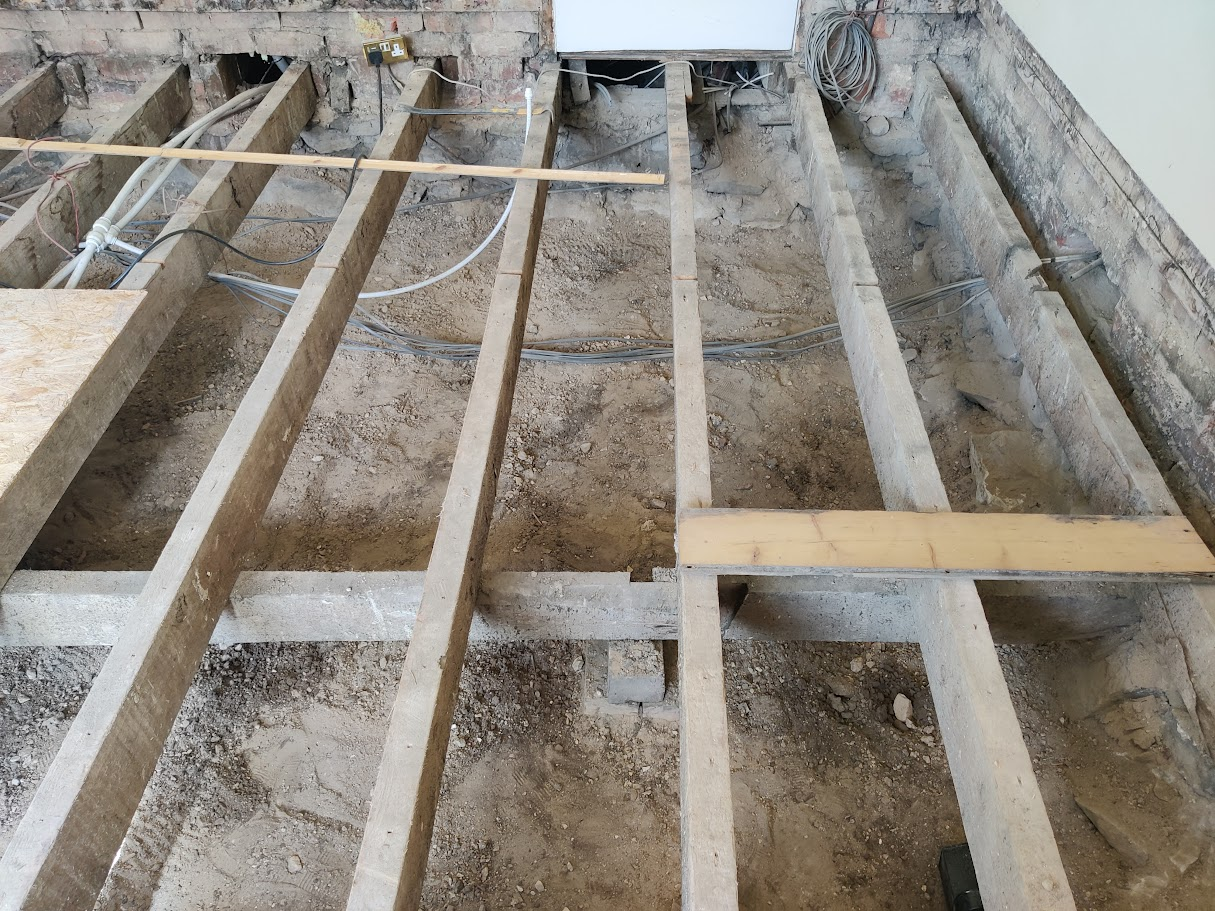

The centre support beam appears to have been resting directly on the soil
Better clearance under the joists and centre beam

2. Because (you say or I saw) its showing signs of rot, & using a new carrier beam will give more clearance for ventilation, just like the freshly positioned centre beam.
3. I knew that - its rotting.
5. If, & when, you trim the hearth & chimney breast then joists should not be used to carry the hearth.
6. Dry rot is visible in your last pic.
Both ends of each joist need treating & capping - I dont see any capping?

I've not started any repair work yet, only digging out the solum. Was wanting to feel confident in the plan before I tackle anything. Appreciate all your advice - thanks.
2. Gotcha. Thanks.
5. What should it be? Brick/stone into a foundation?
6. Could you highlight on a photo as I've not noticed any so must be missing it.
