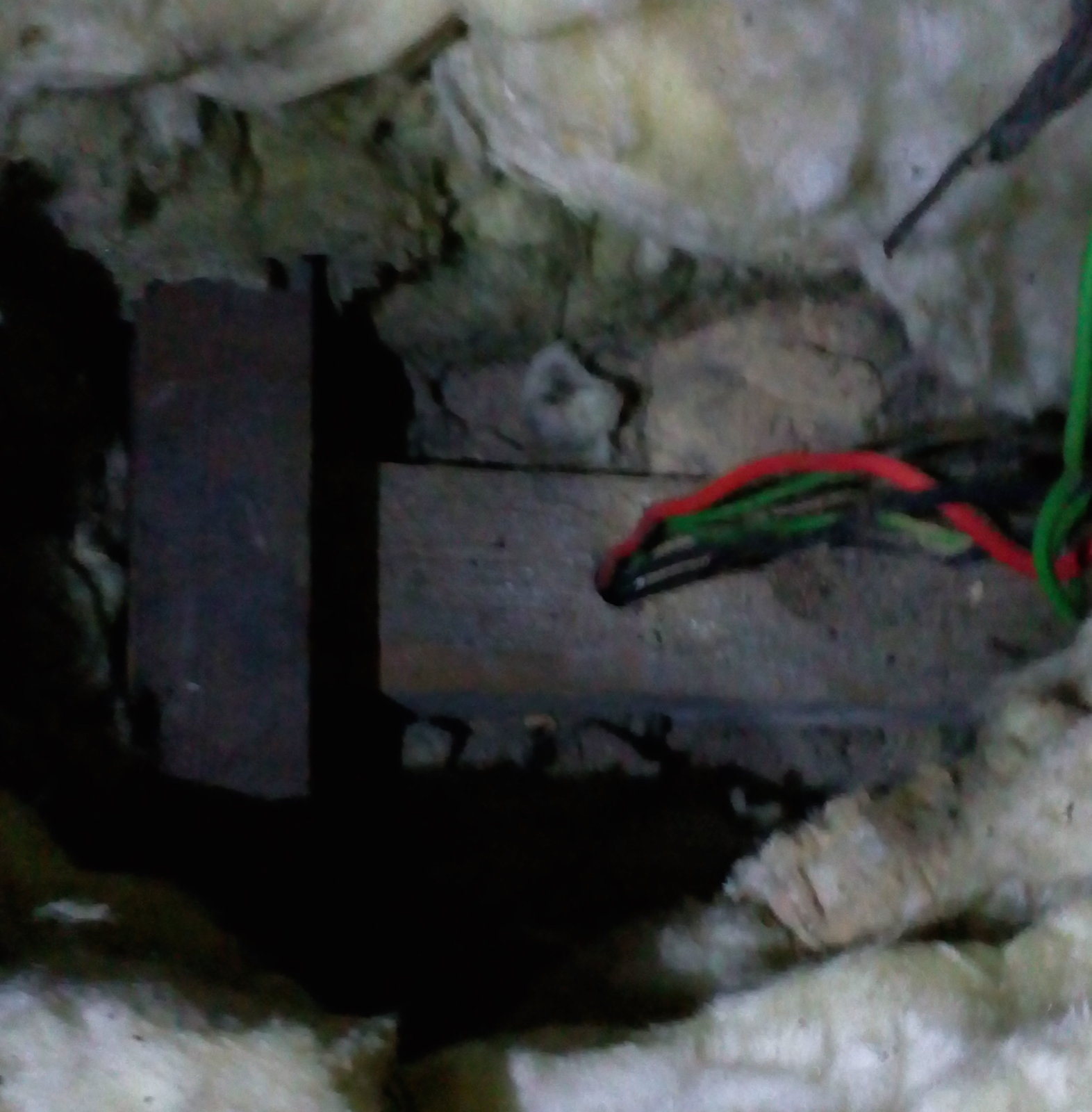

I am looking to put a junction box in an existing lighting circuit to run to new loft lights. A convenient place would be just above a light fitting in one of the bedrooms. The wiring at said light fitting looks like this.
In the loft, the wiring looks like this.
My question is, does it matter which black cable I connect at the junction box?
I've been a bit thrown by not finding T&E up there, and also difficulty following the wiring around the loft which is part boarded, and full of junk.
Thanks!
Well it shouldn't - it really really should not be exposed single cores like that. Either sheathed cable should be used or those wires should be in conduit.
If the wiring all through your chaotic loft is like that, i.e. it's not just a case that someone stripped a couple of bits of T&E back too far for that light, then you've got a bit of a risk up there...
I thought they looked like double insulated singles TBH
They appear to be insulated and sheathed (not double insulated) with a sheath the same colour as the insulation. This is unusual though. The cpc will also be undersized due to not being mechanically protected or integral to a cable. (Should be minimum 4mm^2.) Realistically the only advice is to get the installation inspected and tested and a report on its condition obtained as prescribed by BS7671.

They surely are, per the photo of the rose.

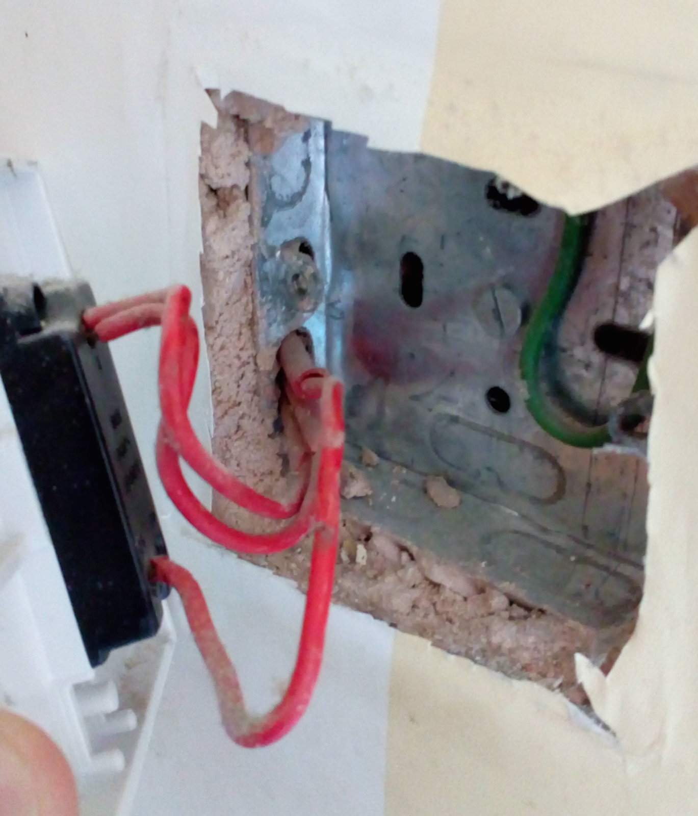

Show us a picture of teh wiring behind the light switch in the same room as that ceiling rose.
That will eliminate the possibility of the loop in being at the switch.

Picture attached. Incidentally, I have seen another switch on the same floor with one cable going to COM and another going to L1: there is no third one as in this picture.
I haven't seen any kind of junction box in there before, so if such a thing would be any kind of size, then I doubt there is one.
But if it was compliant with the regs at the time of installation then it's OK.
I'm not saying it was, I don't know the date of installation, and wouldn't have the appropriate copy of the regs for that date in any case.
But to say that the only advice is to get the whole installation inspected seems excessive IMHO.

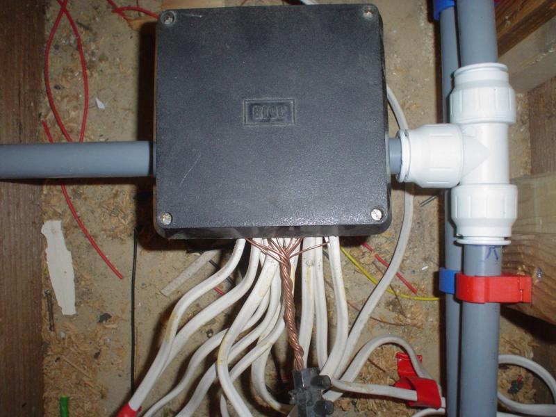

The cables will be all together in a junction box, up there somewhere. Follow the wires in the loft, either from the ceiling rose, or from whre those wires from the switch come up into the loft. They WILL meet somewhere. Almost certainly up in the LOFT.
I will probably look a bit like this
full
Time to do some burying under all that itchy insulation, sorry!
