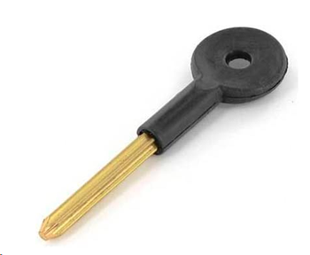

The situation you mention in relation to spaces under baths does not seek to be a definition of 'accessible or 'non-accessible', either in the specific or general situation - it merely says that if the space beneath a bath is not accessible without use of a tool, then it is considered to be 'outside of bathroom Zones'.
If you nevertheless feel that you can extrapolate from that to the general situation of electrical joints (e.g. in JBs) is it therefore your view that a location which can only be accessed with a tool is "inaccessible'?
I have quite a lot of non-MF JBs etc. behind (very accessible) hinged doors/panels which can only be opened with the use of one of these (or various variants thereof) - per piccie below. Do you consider that to be an 'inaccessible location', and hence that the JBs should be MF?
... and what about your 'Control Panels', a good few of which I imagine can only be opened with a 'tool'. Do you believe that all the electrical jouints within them therefore must be 'MF'?
