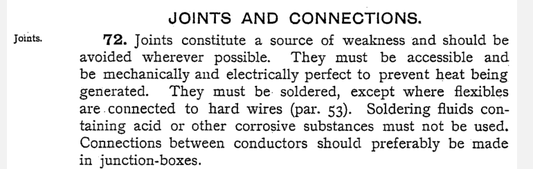

If junction boxes are bad, maybe the best solution would be to ban joints anywhere on a circuit except for accessory boxes or consumer units.
Not quite banned but pretty close.
6th edition, 1911.
