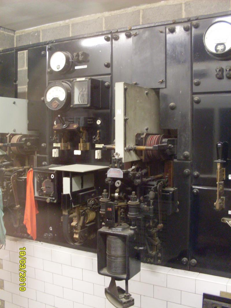

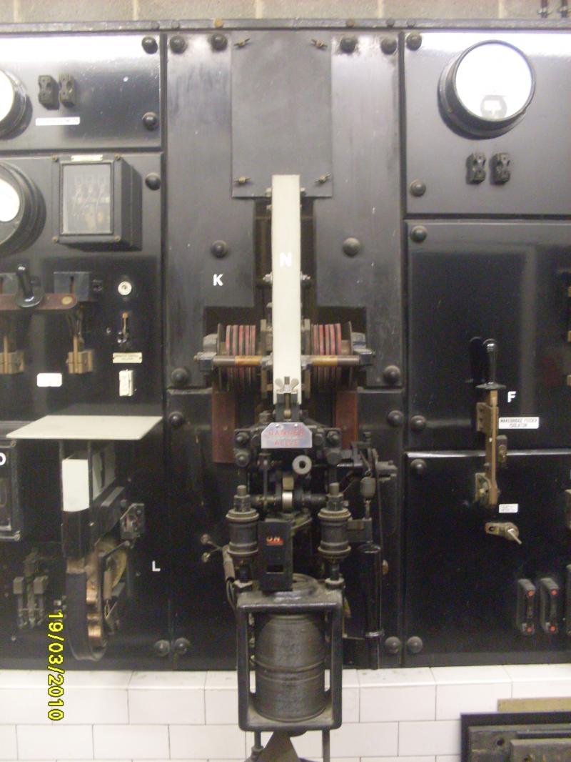

In the old days you would never have seen singles going through a steel case like that. You'd have a paxolin panel or a slot between phases.
Doesn't the grounded semi-conductive screen negate the need for paxolin cable entries?
Wasn't that necessary to reduce eddy currents in the steel due to the magnetic fields from the currents in the phases. So what has changed ?
what has changed
Primarily the construction of the cable with a fully earthed copper armour(!), under that a semi conductive layer, XLPE insulation and solid aluminium cores.
As most switchgear is for outdoor use also we cannot use anything but steel over all parts of the gear so paxolin etc. would be non-compliant
