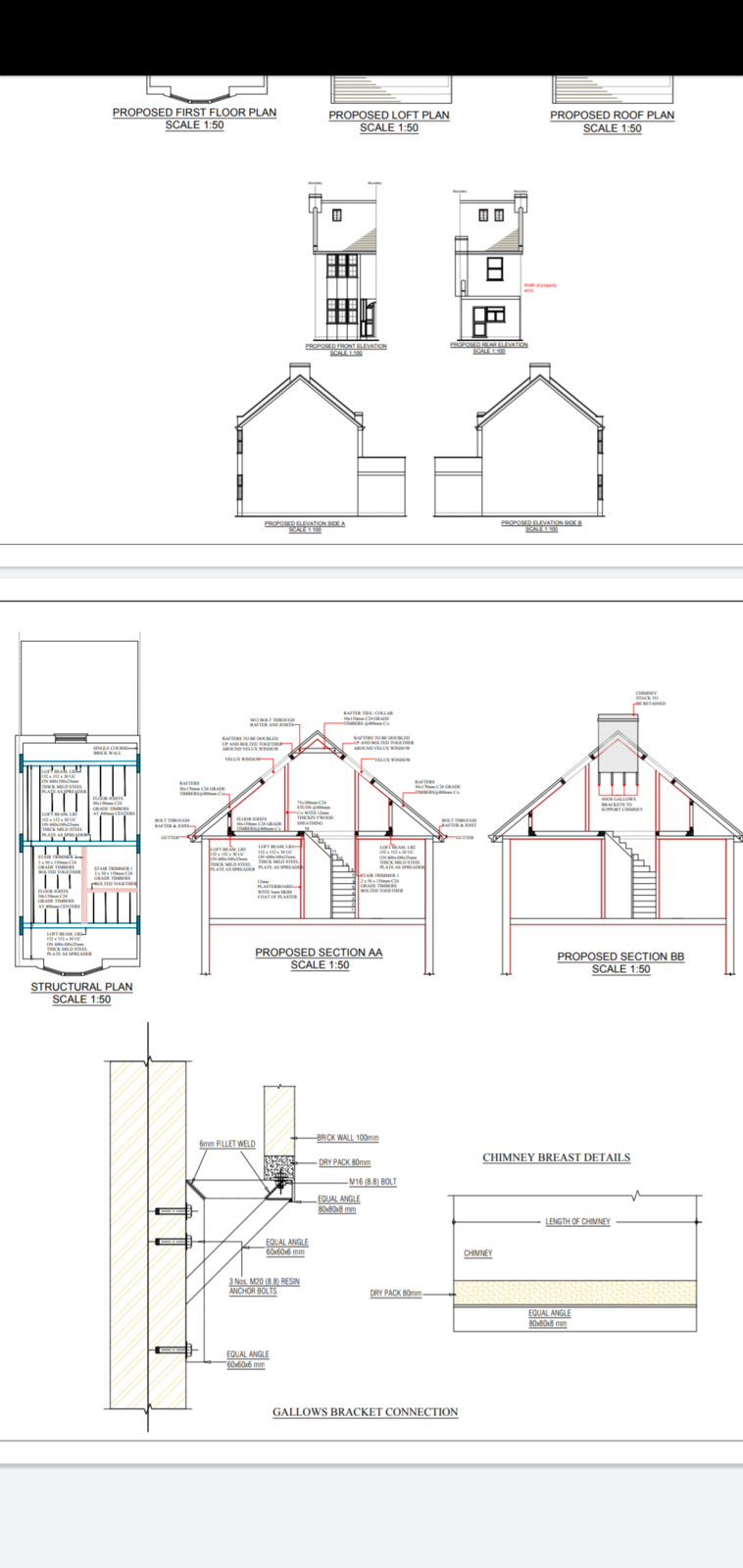

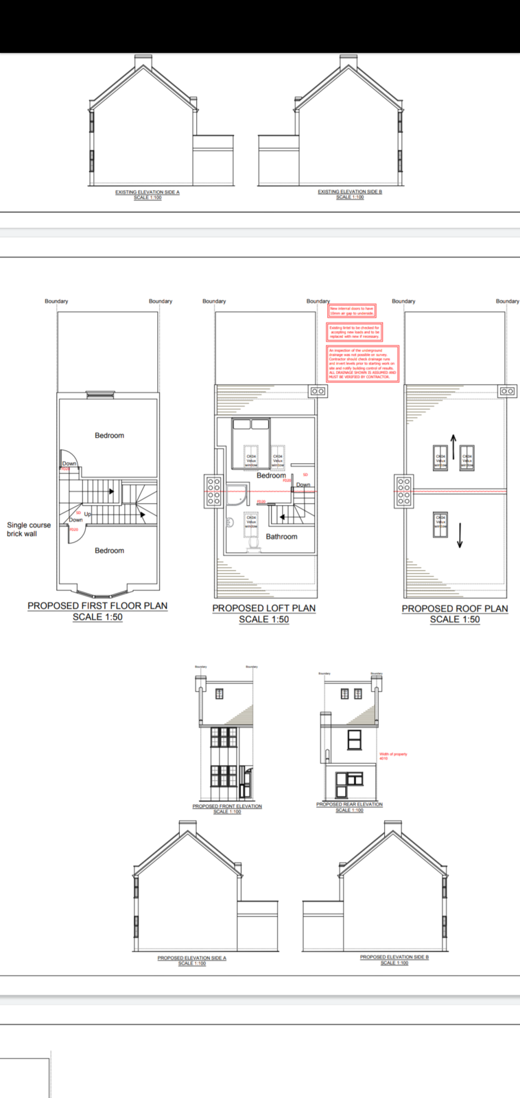

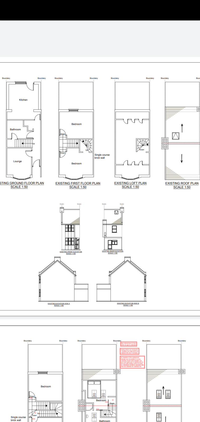

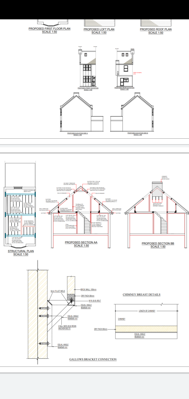

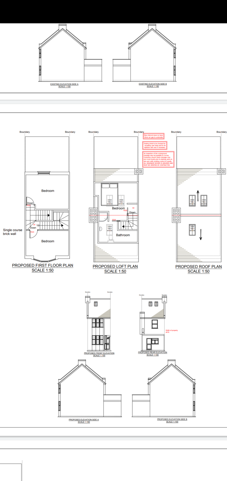

But in this case, the additional load on the wall is absolutely minimal and I suspect the BCO/council checking engineer are being overly conservative, and your architect and SE are probably over-reacting to get the scheme approved on paper.

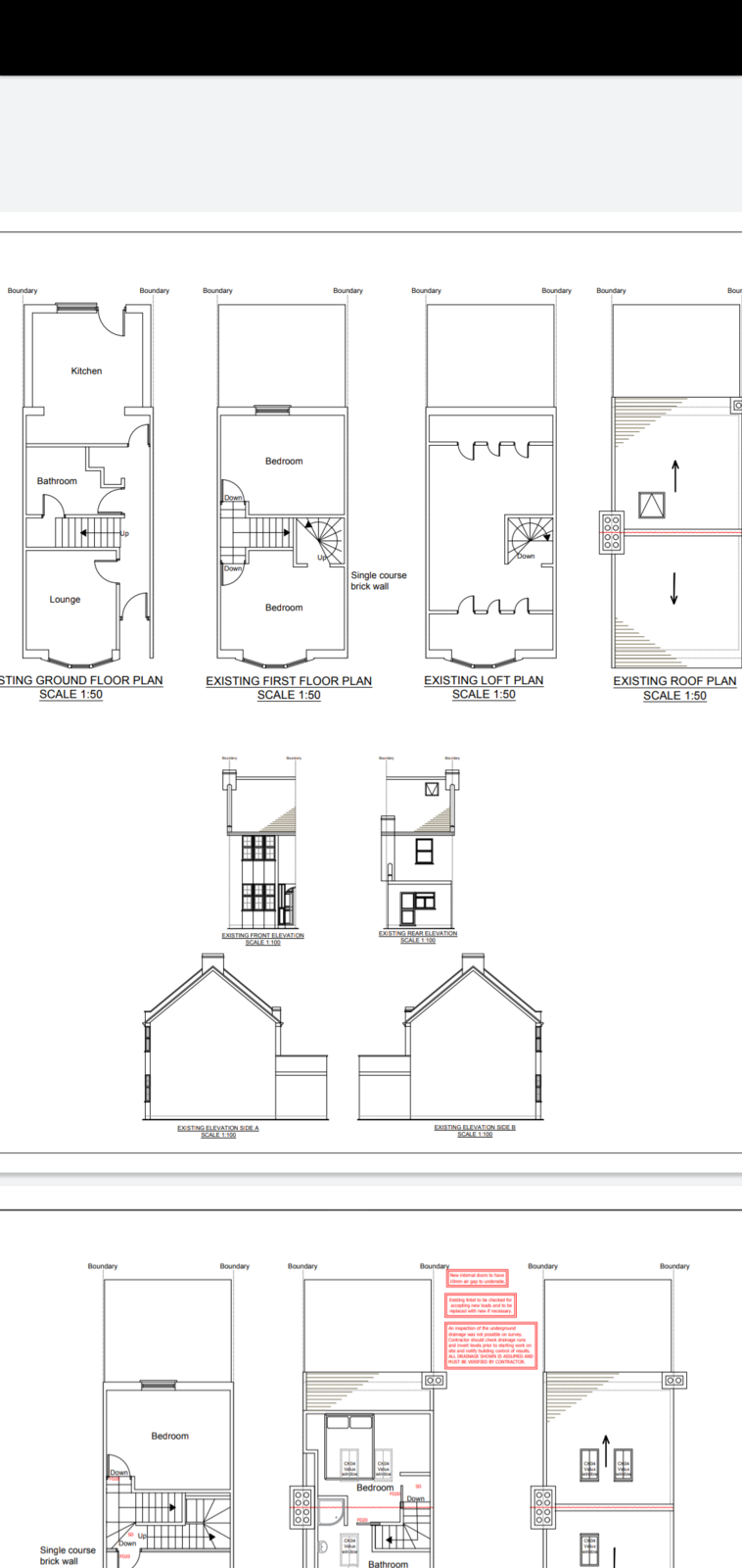

Is there a way around it then? The whole neighborhood has lofts built the way we planned ours, nothing is falling. Is there a different way to justify the structure other than with calculations? See the attached screenshots of the plans

Assuming the wall between the front bedroom and the stairs is 1/2 brick and bonded to the party wall, the floor area supported
by the steel beam is very small and the additional load on the 1/2 brick party wall minimal.
Can't see what the fuss is about really; in this instance, your builder seems to have more common sense than your architect, the SE, the bco and the council's checking engineer put together.
Are BC asking for calculations or do they want someone to inspect the wall and check it's OK?
The calculations you have assume the wall is vertical and that it is in good condition. A 100mm wall doesn't need to be much off vertical over 4-5m to leave the end the top brick sat completely outside the footprint of the bottom brick, how much lean can you have before the wall isn't suitable to take the loading? Your wall is probably lime mortar, if it's dry both sides then the mortar may be very dry and friable now, which can leave the wall in poor condition.

They ask for justification, whatever this means. It could be calculations or a way to explain that the proposed structure works. Thats how I understand it
Something I didn't think about in this context, but yes I did wonder how far you can go before it's too high. I don't know if this is something that BC had in mind when they questioned the structure.
It has to be sorted out by the SE , ask the SE whoever they are to discuss with the BCO exactly what needs to be justified. Is it the lateral stability of the existing half brick wall , the additional loading on the wall, the condition of the existing brickwork or what :?:
ps re the note on the drawing referring to 'single course brick wall' - is that supposed to mean one brick or half brick thick wall :?::!:
Good point. I don't know what's the answer at the moment and I've noted that the reference to the single course brick wall is on both sides. Except when it's at the loft level and the wall on the left becomes thicker...?! Not sure what and why he did that

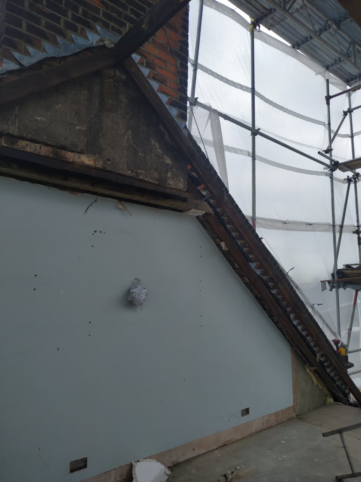

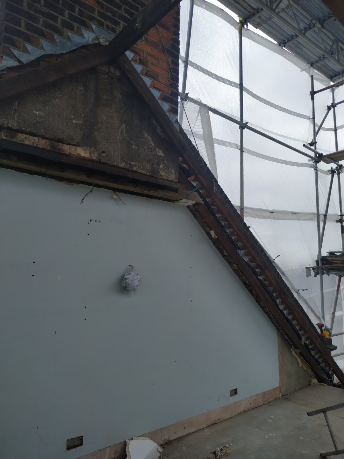

Why is a chimney breast appearing on the proposed loft floor plan (and above a staircase :!:)when there is no chimney breast shown on the existing floor plans in that location :?::!:
Previous owners removed the chimney breast, left about 800mm below the roof. So the chimney only appears at the loft level
And its mounted on gallows brackets?
It is now..... someone did a cowboy job, there was some sort of support, but not sufficient (see the attached). Our builder temporarily fixed the gallow brackets, but eventually we are hoping to rest it on a steel and a post, to save some space. Just need to resolve the bigger issue of the half brick
