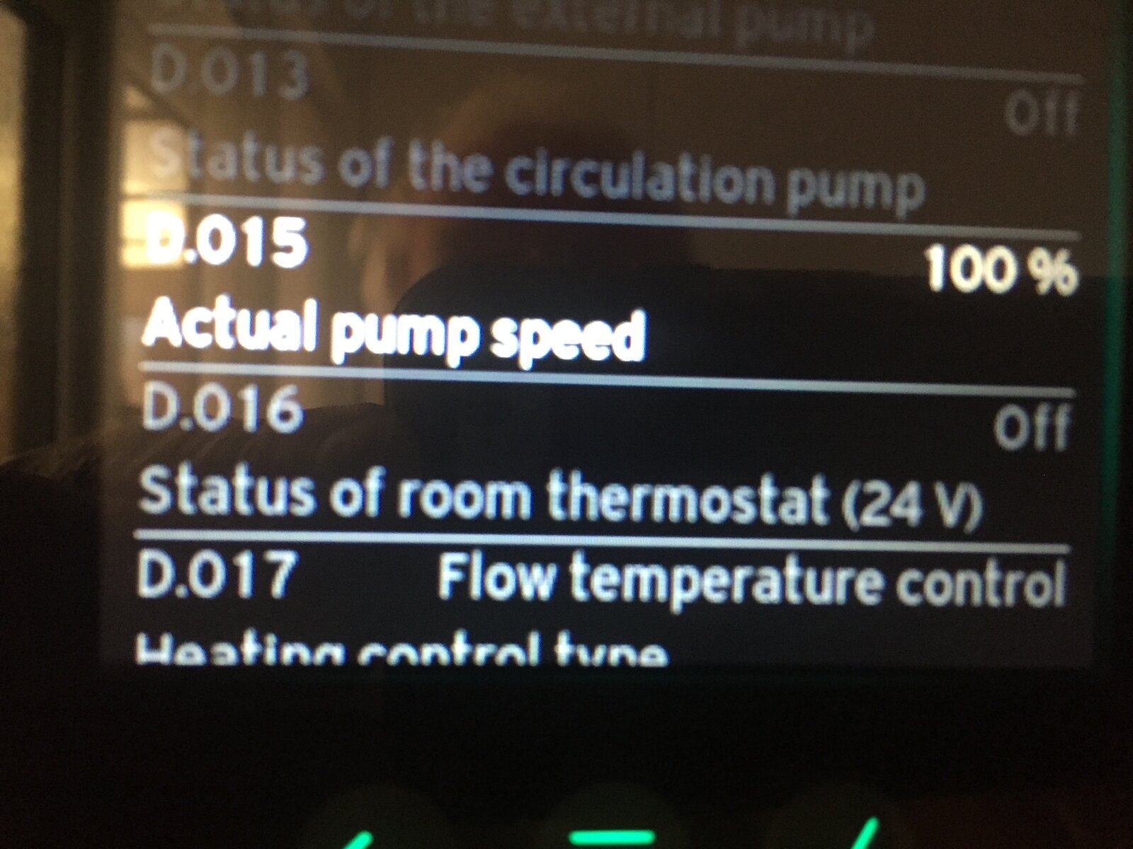

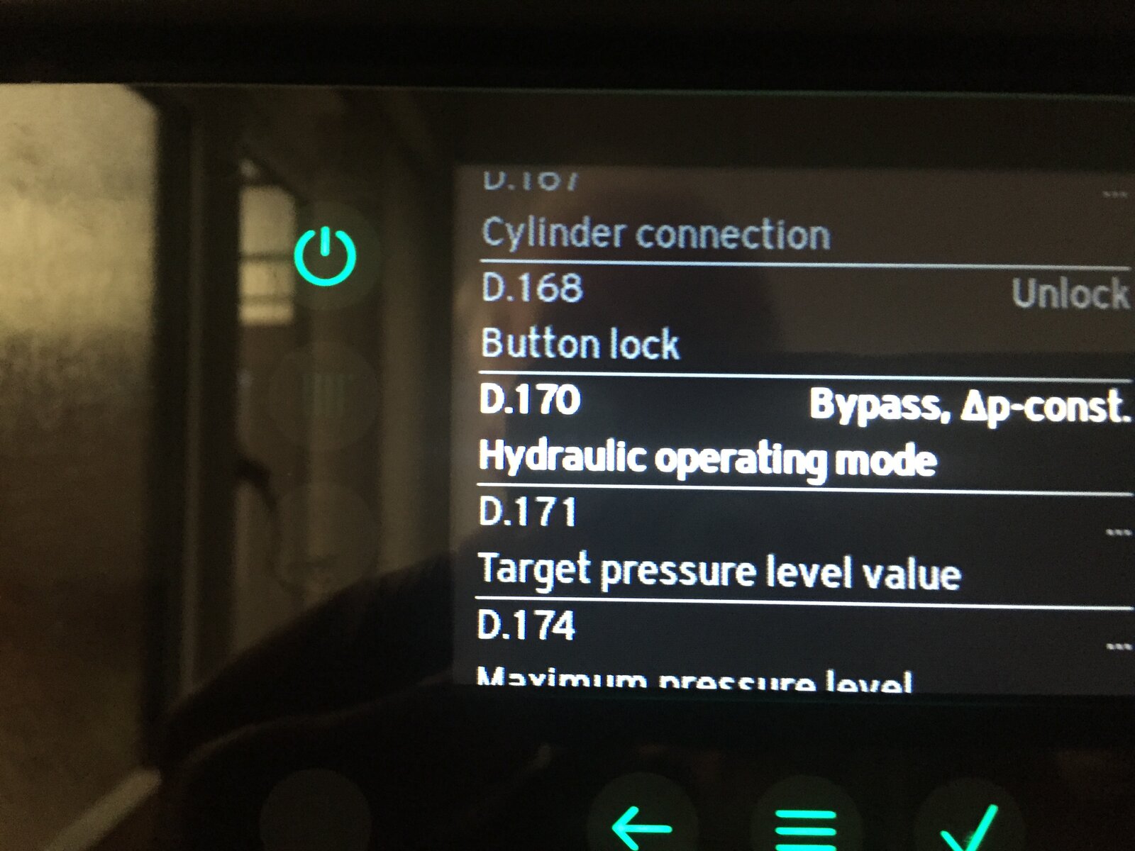

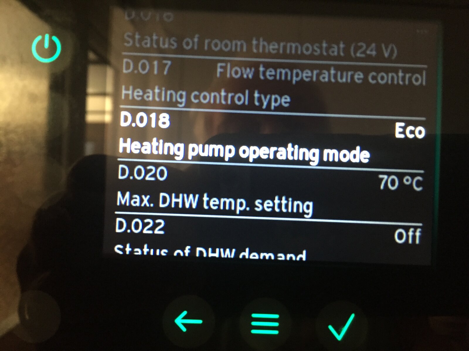

You said you had a ecotec pro but the attachment is for the ecotec plus, a lot of the d parameters will probably be the same anyway, so you might fire up the boiler in CH mode ( a few minutes should be enough) and check the actual pump speed d.015 (%), check hydraulic operating mode d.170, pump status d.018, permanent or eco (or if it shows 1 then fine) and any d parameter that you think is relevant to the pump.
Sorry John it is a plus " a grey moment" I will do the checks TU
